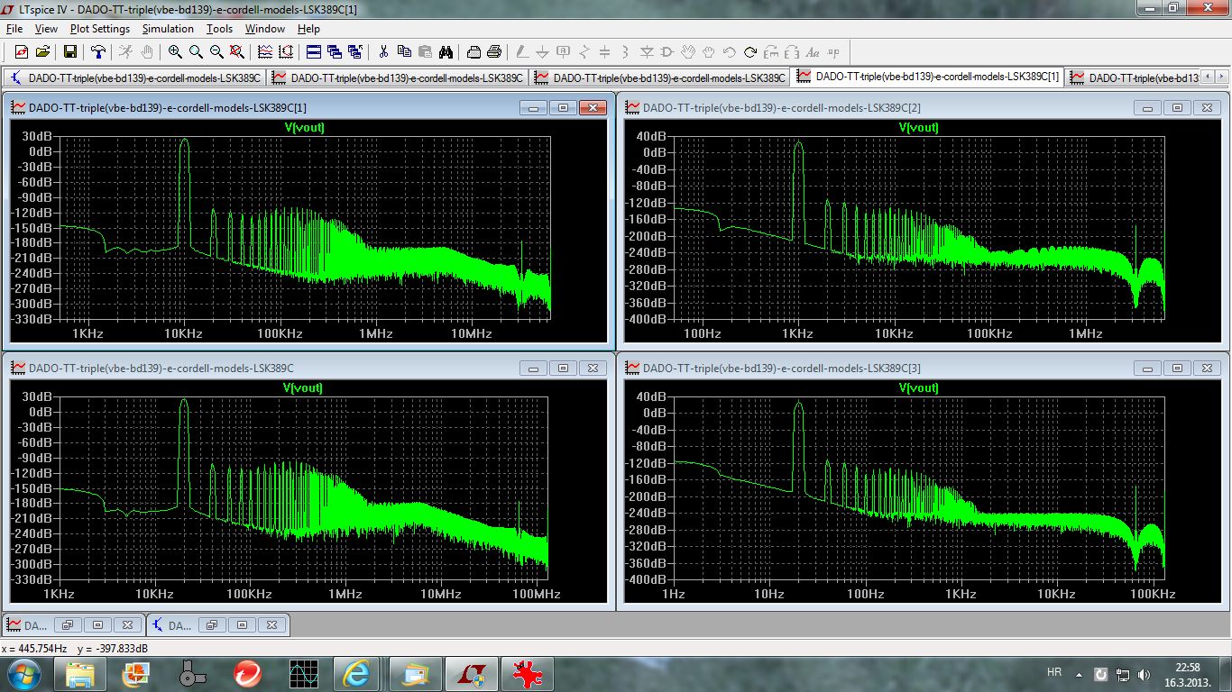

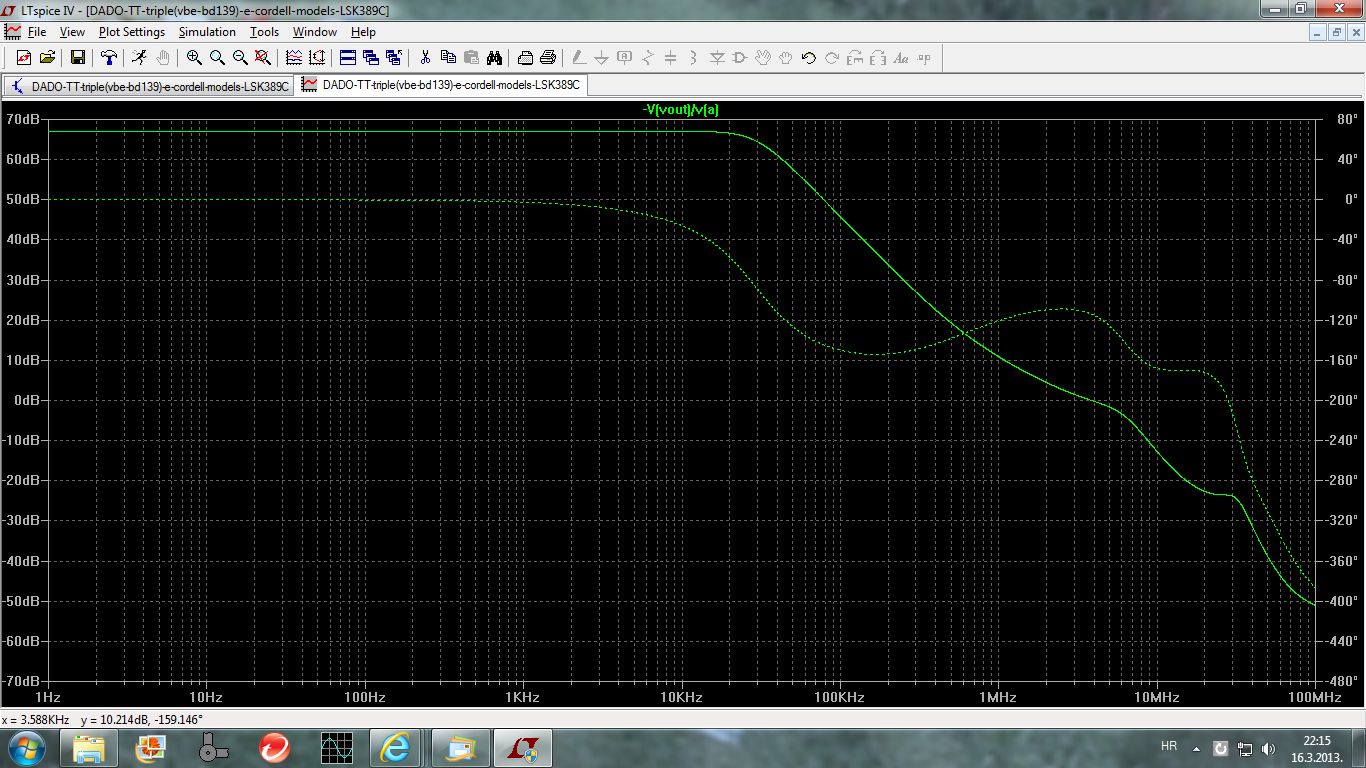

Do you think that an amp with the loop gain like this would sound better?
Damir
But music or speech isn't white. I would think you'd have to take into account the power spectrum and further weight the more audible frequencies.
Just dont see the down side of having more loop gain where there is more energy hence higher signal amplitudes and increased distortion.

When the same amount of gnfb is used at all freqs, the distortion harmonics are alike at all freqs.; Same level and number and relationship/ratio. I believe this type of distortion pattern is well accepted as best sounding.
As I have said in earlier comments -- levels below -100dB are not audible to me and would be a desireable goal for all parts of the recording/playback system - keeping the total accumilated system thd below audibility.
Sorry but SIMs dont count. Only actual, live operating circuits and systems.

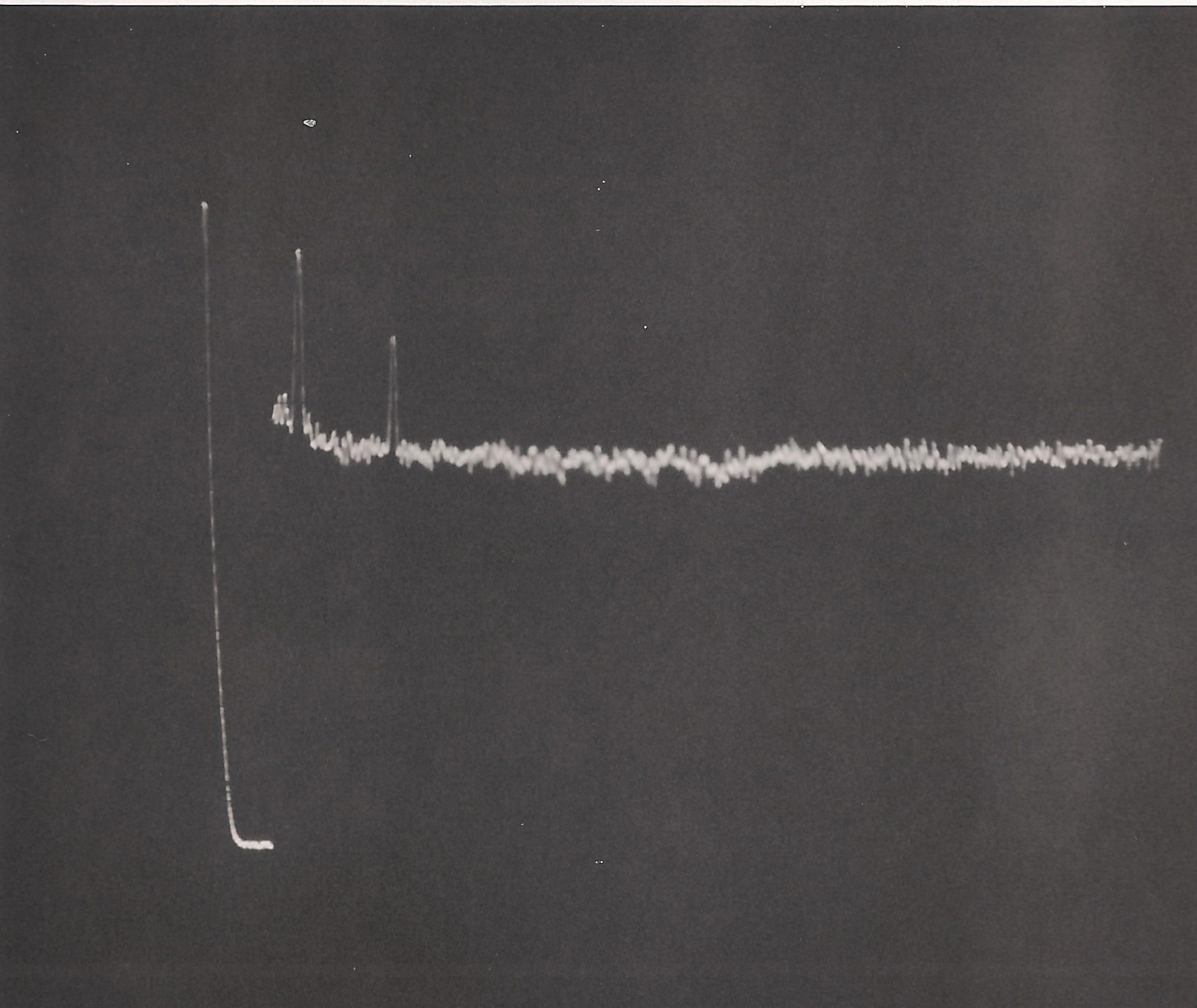

Here is a moderate gnfb line level amp that has the same THD and same harmonic structure at all freqs in the BW of interest. Only 2H and 3H. The important issue is that it looks the same at any freq tested...same level and number of harmonics and relative levels to one another.
Anyway, this characteristic is why, IMO, amps with low or no gnfb are liked by so many people.
Thx-RNMarsh
![1-10KHz THD.jpg 1-10KHz THD.jpg](https://www.diyaudio.com/community/data/attachments/304/304970-f5b721569c8be21a1509bea63af14b00.jpg)

But somewhere we have to start when design, and then do the measurement on the built amp. I hope you do not advocate to design without simulation?
Damir
What if the rising thd plot still is below -100dB at the highest frequency you are able to perceive ?
Then you are on double-safe ground. And, would focus on construction, parts selection, shielding, grounding, interfacing, impedances, loading, controls, power supply, etc to not spoil the pristine amp. The goal then being to have the entire system -from source to speaker - not accumulate any issues that would intrude.
-Thx-RNMarsh

I am completely with you in that, but it was a time ago when spice was not available free of charge as now. I am talking about DIY not professionals circuit designer were spice was available much earlier. I worked in telecommunication and electronic was my whole life hobby and I started to use and learn spice simulator less then two years ago and I am 68 old, so its never to late to learn new staff. For the skill electronic designer its enough to use a hand held calculator, but then you have to build the thing to see if it work as it suppose to work and with simulator you can tray many different combinations and fast by it. I know a simulation is good as the one using it is good and as the models are good, but it fascinate me now as I can try many new ideas with no need to built it all.
BR Damir
