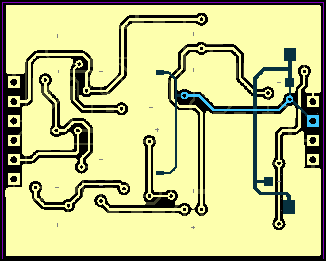

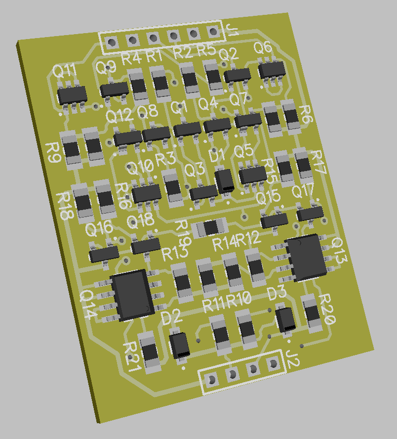

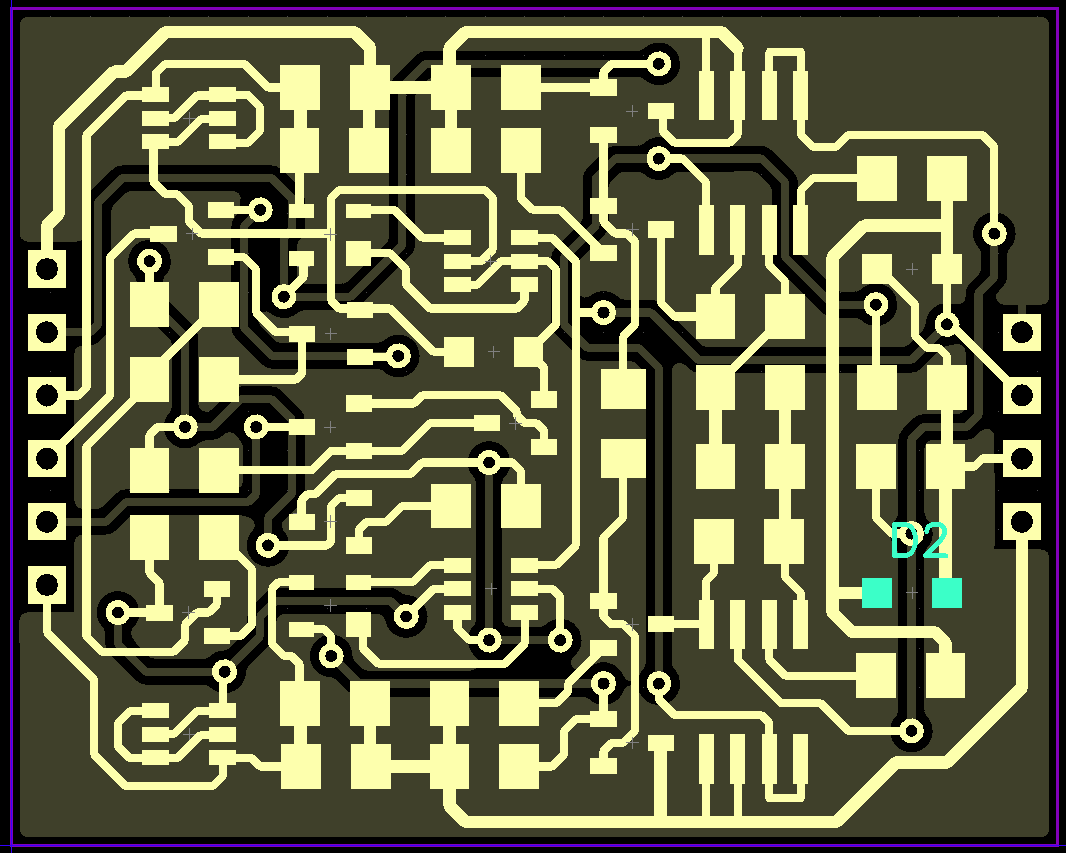

This is my own interpretation of Scott's masterpiece. Design criteria are:
- all SMD
- as small as possible but with reasonably sized components and spacings, must be hand-solderable for prototyping
- use of matched components where possible, without resorting to hard to find parts, all semis are from NXP and available through standard catalogue vendors like Digikey, Farnell, etc.
- diamond buffer is made of two complementary pairs in SO8
- current mirrors are integrated parts containing two matched BJTs
- diodes are diode connected BJTs for matching
- pinout includes gmC stage output, compensation pins, offset nulling, beside the usual ins, outs, Vccs
I'd like to hear some expert opinion on the layout of my small board. Specifically, I'd like to hear comments about manufacturability, and criticism on obvious mistakes I may have overlooked.
Thank you
Giorgio

I'd like to hear some expert opinion on the layout of my small board. Specifically, I'd like to hear comments about manufacturability, and criticism on obvious mistakes I may have overlooked..
"manufacturability"
Hi Giorgio,
Hard to say without knowing what exact parts (BOM) are used, there orientation referenced to the schematic, sizes of the pads etc.
Post the schematics, gerber/drill data and then I/someone can actual make any sense of a pcb with some lines drawn on it :D
Every pcb shop has their capabilities, so you first have to find a supplier & meet their guidelines.
If you keep (line/space) > 8mil(0.2mm) you are good to go for most fab's. I usually pick 12mil as default for signals and 25mil for power(For a small pcb as this). For vias I use (32V20) 32mil pad/20mil finished hole (batchpcb req.). If you need smaller then, 30V16,(8/8) 25V13(5/5). Your minimum pad pitch usually sets your minimum line width, a simple rule to follow. I have used a few DFN's (QFN40-6X6-LS0.5MM), I come off the pads with a 9mil trace and then wick up from there.
It is also good to use the widest trace and spacing as possible.
My acid test is always to print out the component mounting layer(s) (1:1) and physically place the comp on the footprint just to be 100% that I got it right.This means getting the components ahead of time or have mechanical equivalents to verify your new/unproven footprints. The quality of the CAD library is imperative or you are wasting money on bad pcb's. I never use the ones that come with the CAD package. From my experience, I find issues with them all, it is a long list of things to check for.
Where are you planning to get a pcb fab'd? Home or outsourced?
I have a few pcb to be made, was looking at
PCB prototype manufacturer doublesided and multilayer - PCB-POOL.COM
or
https://batchpcb.com/
Rick
Rick,
Thank you for your response.
Some more details:
- board size is 42 x 33 mm
- semis are SOT23 size and equivalents
- resistors are 1206
- signal traces are 0.33 mm / 13 mil
- power traces are 0.5 mm / 20 mil
- vias are 40 mil diameter / 20 mil hole
- PTH are 60 x 60 mil pad / 35 mil hole
- clearances are set to 6 mil minimum in DRC
Your suggestion about printing out the top layer and place components for a quick check is very good and I will definitely follow it as I'm using the standard CAD package libraries. I will check them out to see if they need improvements.
Also, PCB pool seems to exactly fit my needs.
Thank you
Regards
Giorgio
Giorgio,
Set your DRC rules for 8 mil spacings and see how many violations that you get?
SOT-23/1206 good choices, this is my preference as well for something like this, no need for 0805.
Your design is what I know as 12/12 technology, except your 6 mil DRC is too close for 12/12, so it is a mix. 8 mil DRC min spacing, is a safer way to go for a design such as this, your choice however. These days 5 mil spacing is a safe bet even for ? pcb shops.
I am always surprised how many EE's, can not or chose not, to layout there own pcb's. It is a very important part of the design process, just like software and mechanics.
Cheers
Rick
Rick,
DRC clearances set at 8 mil passes with no errors.
The default DRC setting for ground plane to board sides clearance is 25 mils and is clearly violated in my layout. I wonder whether this is really critical however. I could easily change either the clearance setting or the ground plane area but I'm not sure it is really worth it. Any suggestion?
I totally agree with you about layout being part of the design process. I'm doing this exercise because it is a great learning experience, beside for the fun of it.
Thank you
Regards
Giorgio
If you bring your copper to routed edge, then you will get burrs, as this is the last operation, routing the image out of the panel.
I am doing a design now, RF using a Si4770, I want the option of putting a shield around the whole pcb ( & ground it) , so this is the only reason why I will bring the copper to the very edge of the routed edge.
Yes layout is fun for me as well. Gives you the physical perspective, which is usually a paper design, up this point in the design cycle, unless you do some prototyping before doing final layout.
In so many designs, the pcb layout is a throw it over the wall approach, which is flawed in so many ways.
Rick
