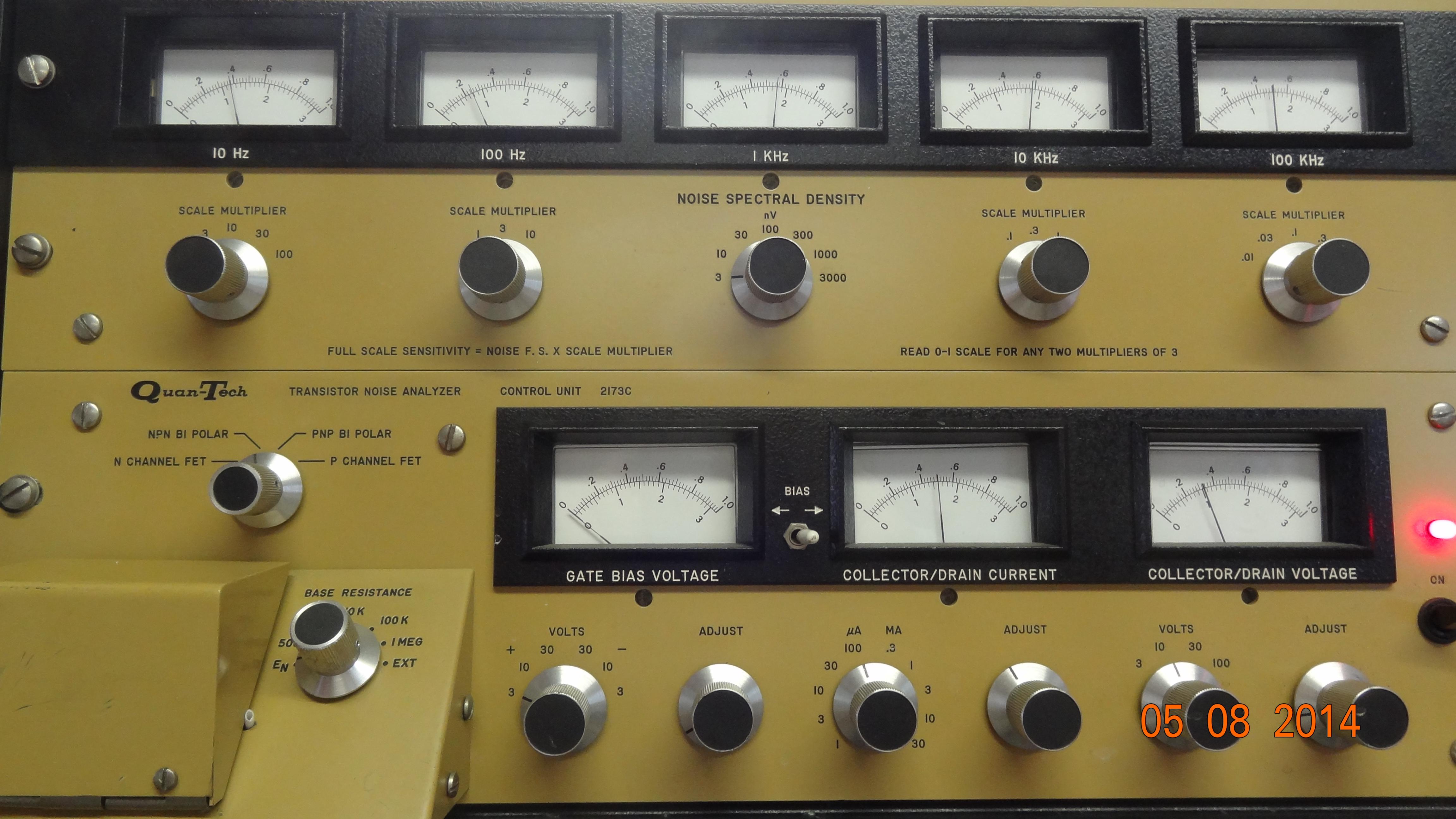

I was just trying out my Quan-Tech transistor noise analyzer.... a rather old but still quick and useful [Model 2173C/2181]. If you click on the picture and zoom in on it, you will see the noise level of a 2N2219A TO5 transistor. It is an oldie but goodie. The thing is just under 1nV at 1mA Ic and 8vdc Vc. Not too bad performance and they are cheap and quit linear. For lower noise, paralleling them is easy to do.

The interlock switch on that Quan-tech must be broken to get readings with the cover open. Its considered a safety issue as well as noise mitigation.
Except for styling details its largely unchanged from the first gen from the late 1960's.
Try the transistor with 100 uA and even 10 uA, also lower collector voltages.

I am going to make the cover switch closed all the time. But I jammed it so I could take a picture showing an old 2N2219A in it for the picture. Looks the same on the outside.... this is version "C" on the inside.
I am operating the transistor where it normally is used. It and its compliment has been a work horse of the industry and still in production. It is very linear also. It is like the 5532 IC, done so well in the first place that it has been used everywhere.

Yes, I used the 2n2219a in a bias oscillator. Keith Johnson also used them extensively in the Fairchild MTIS and the Gauss Electrophysics Duplicator electronics. No other transistor I tried was as linear. But that was in 1972. It is a shame the collector to emitter breakdown is only 40v transistor. The original was a 60v transistor but then it was downgraded to a 40. There is a to126/to220 variant in the TN2219A. Ray
I havent heard of the down grade. It may be derived from a new test proceedure/standard. But, the -A version was higher voltage than the plan old -2219.
I think they are still good as ever... in every way.
[I didnt know about the higher wattage packaging. Thx]
I can run it up on the curve tracer until I kill it dead and see how much voltage it took.
Any way, the noise didnt go up much -- just to see what Demian wanted to know..... 50uA and 3Vdc ....1.8 nV at 1KHz and 10KHz.
