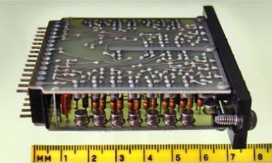

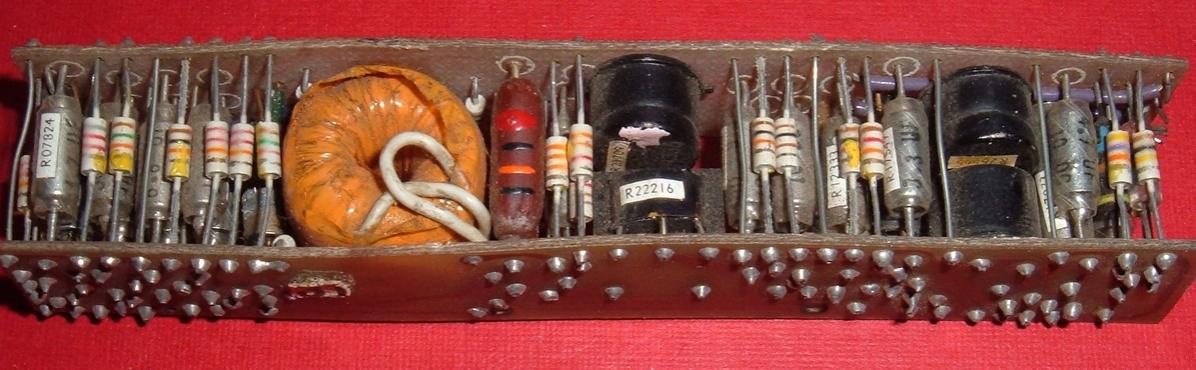

The SMT parts make it all possible. with the lates 0201's and even smaller you have no limits in the number of parts you can use. Just that they can't be assembled by human hands. I was shown some resistors going into a project. They were indistinguishable from ground pepper.
You could use through hole parts in cordwood construction to get the volume smaller.
I've seen these kinds of modules before, but had no idea they were called cordwood construction - these were used in '60s solid-state equipment. It would be a bit messy to do the layout using present-day layout tools like Eagle, because parts span two boards.
I do use vertically-placed through-hole resistors in some designs, but with one lead bent into a U and both leads soldered on the same board. In some cases, I use mezzanine construction with two boards, but the only components that span the boards are mechanical struts with no electrical connectivity between the boards - I use edge connectors and an additional base board, when needed, for connectivity between boards.
So what is the point of posting a circuit design that "can not be assembled by human hands" in a DIY forum?The SMT parts make it all possible. with the lates 0201's and even smaller you have no limits in the number of parts you can use. Just that they can't be assembled by human hands. I was shown some resistors going into a project. They were indistinguishable from ground pepper.
I can do SMT work, but it is slower to build. My concern with such small traces and solder joints is that it's so much easier for a joint fracture to occur as the device ages. Larger through-hole board designs that are complete with lead-based solder will last a lifetime. Cordwood introduces a concern for my own use; that method makes it more difficult to change out parts after it is assembled. It reminds me of the parts we were using at a plant where I was contracted a few years ago. The products were not designed to be repaired or dissassembled, and thus, any put through rework had to be completelystripped just to diagnose one component that was introducing the fault.
For a DIY design I would not use anything smaller than 0603. With some practice and patience (and a microscope!) they are not hard to place. Through hole are somewhat easier to build but really take a lot more real estate. The cordwood idea is for the really committed (in more ways than one). I did deal with them at Control Data and its great when money is not an object but no longer. Don't even try that if you have an option.
