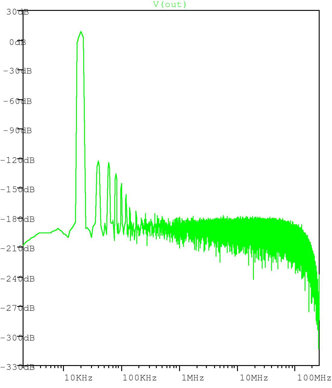

*Bump* - Another set of improvements, this time to the venerable Melcor 1731:
1) Added LTP CCS - many pros and cons, but it reduces THD20.
2) Added LTP Current Mirror - requires some care because of the differential VAS.
3) Added VAS Cascode - tried a lot of arrangements, but ultimately it is deceptively simple. If you look carefully, this is equivalent to the VAS cascode in the SWOPA, but with transistors rather than diodes (one transistor is diode-connected).
4) Re-biased the VAS to keep the VAS currents roughly the same as the LTP currents - this helps to keep the LTP collector loads roughly balanced.
Overall, it is more complex than the FET990, and does not reach the same level of simulated performance or sonics, but it uses mostly BJTs (can be made 100% BJT by using a BJT doublet for the LTP CCS). Four pairs of these can be implemented with (matched) BJT duals.
Simulated THD20 at 4V into 600R is a very respectable -130 dBr. It does pretty good at fairly high swings as well, right up to the onset of clipping. Further simulation is needed to check the overload and clipping behaviour - it may require clamp diodes like the FET990.

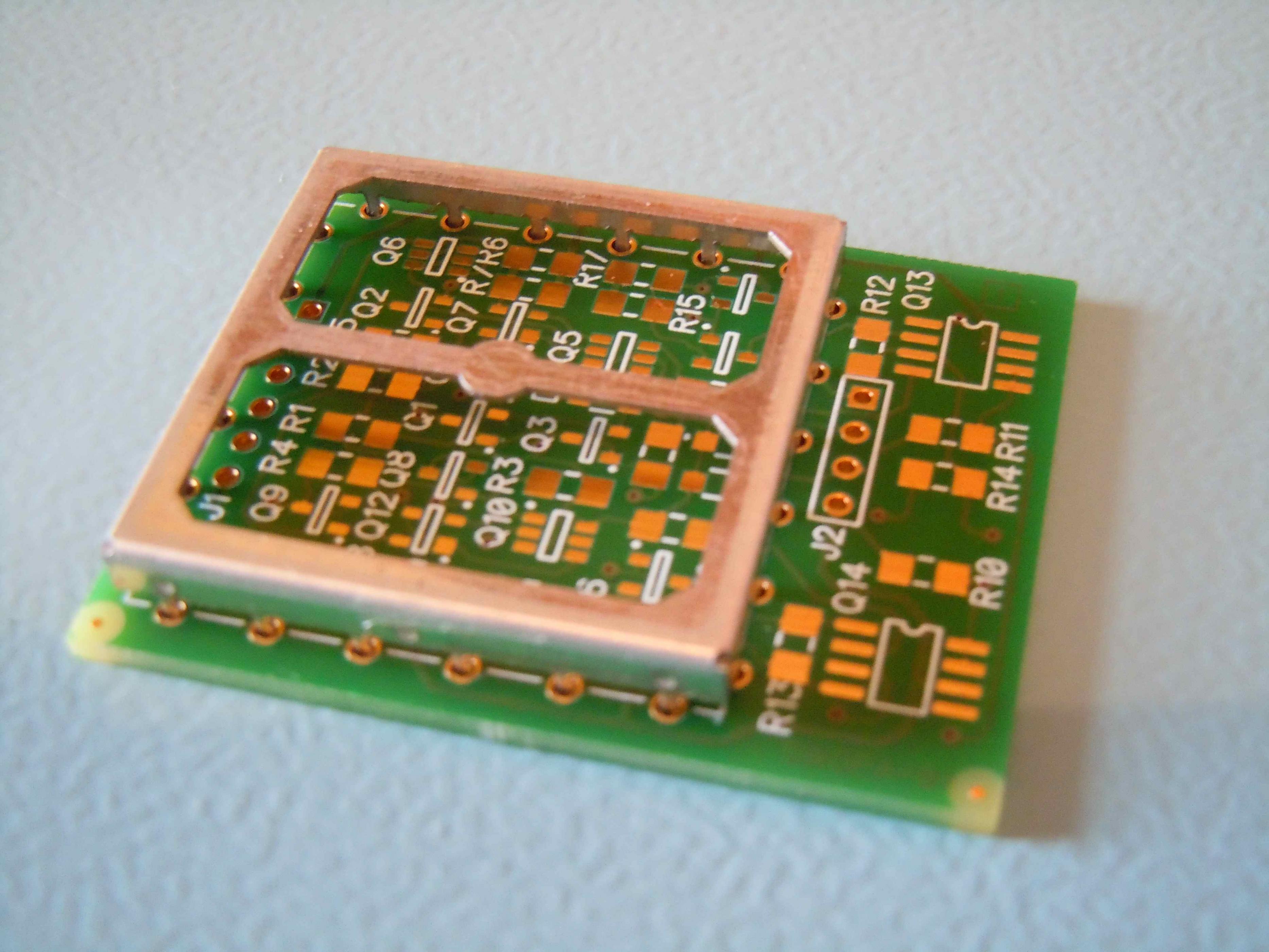

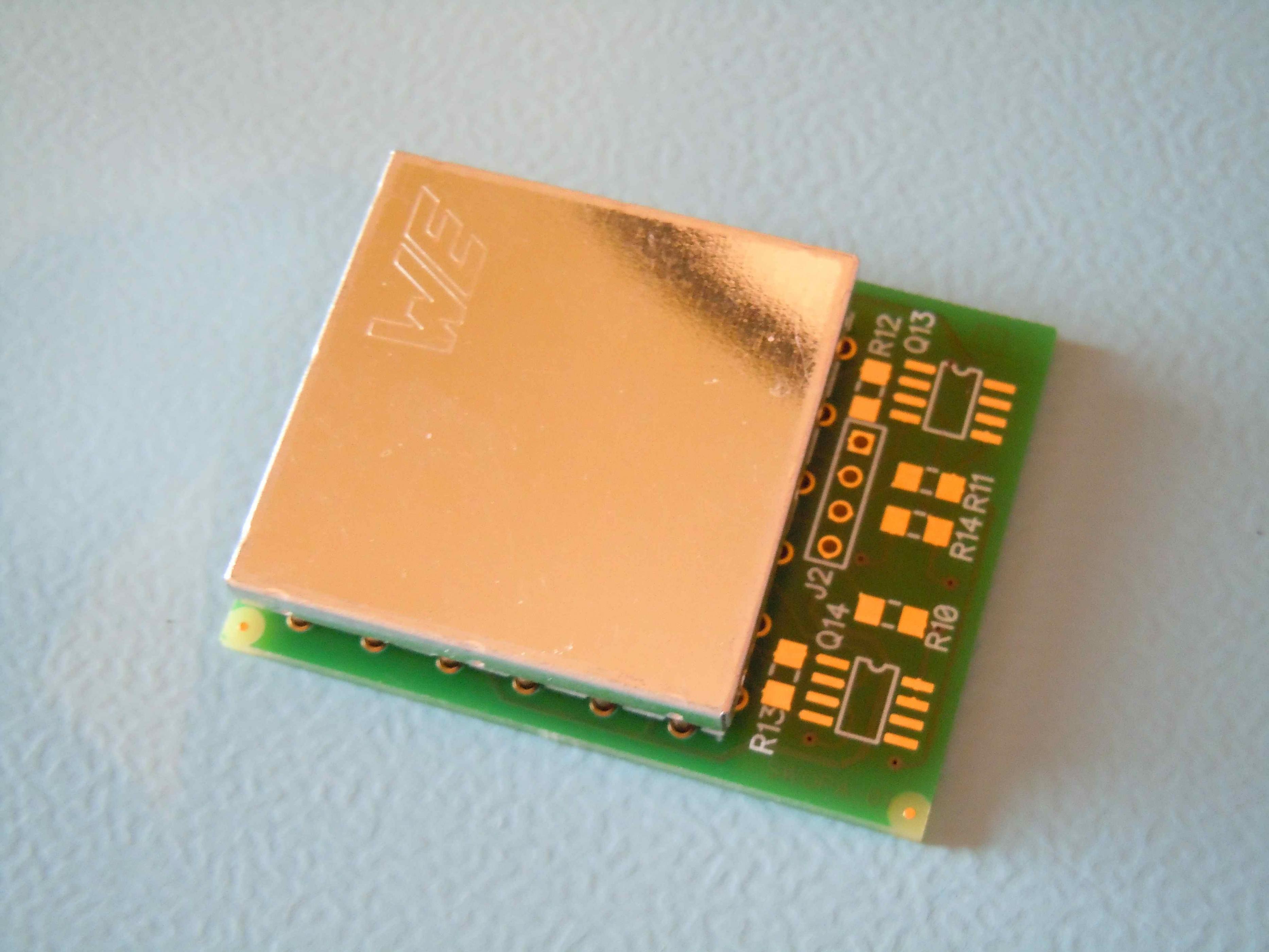

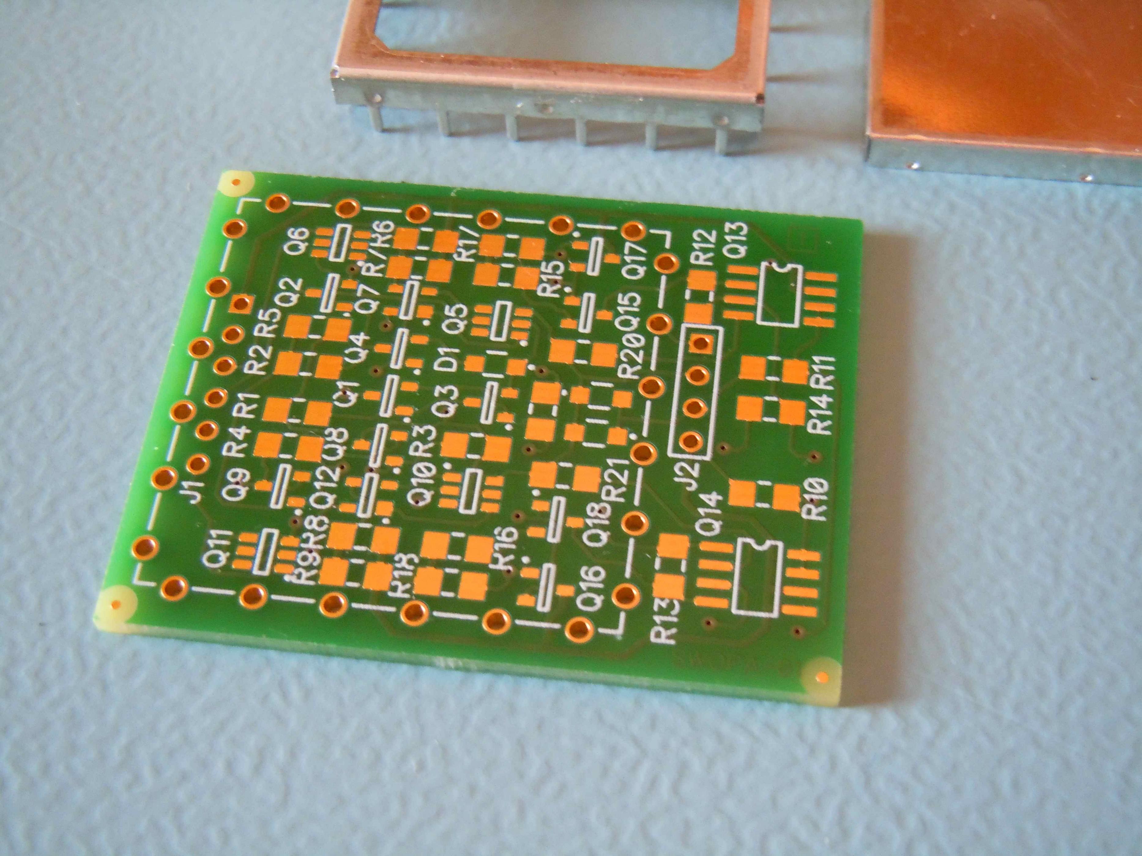

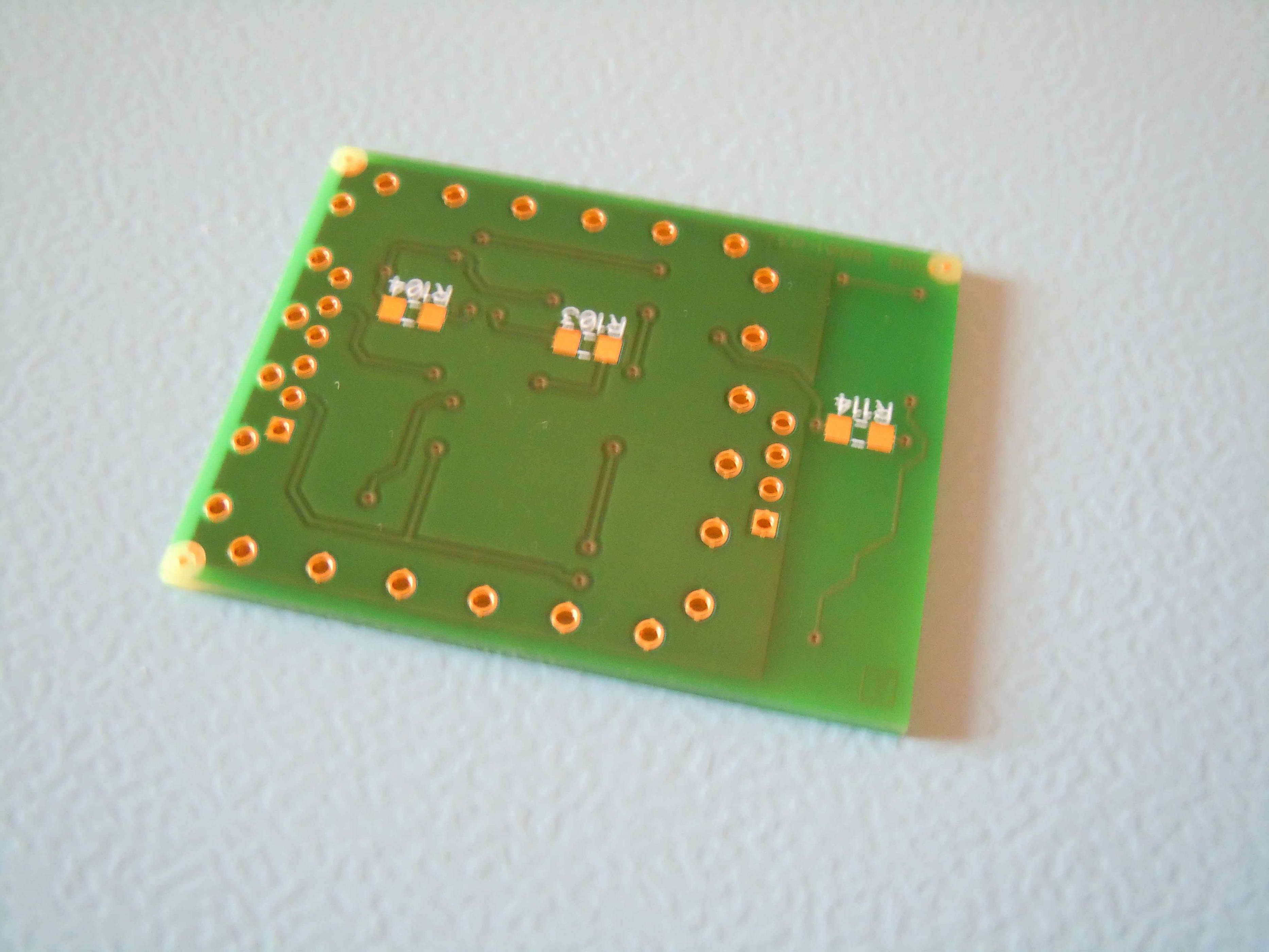

I managed to get the SMD version done, see attachment, but it's going to be a while before I'll populate the boards and test.
The boards are two layers and the bottom layer is a ground plane for the most part. Most of the silicon used is dual BJTs and current mirror duals for temperature tracking. The JFETs are singles because the Linear Systems parts are not so easy to procure here. The shielded box will be filled with a thermal gap filler pad and resistor on the bottom side of the board are used to fine tune the matching on bias current of the input stage and to set the bias of the output stage.
I also did a first stage only version of the board that fits into the shielded box footprint. It may be useful in some applications...
Stay tuned, but don't hold your breath 😉
