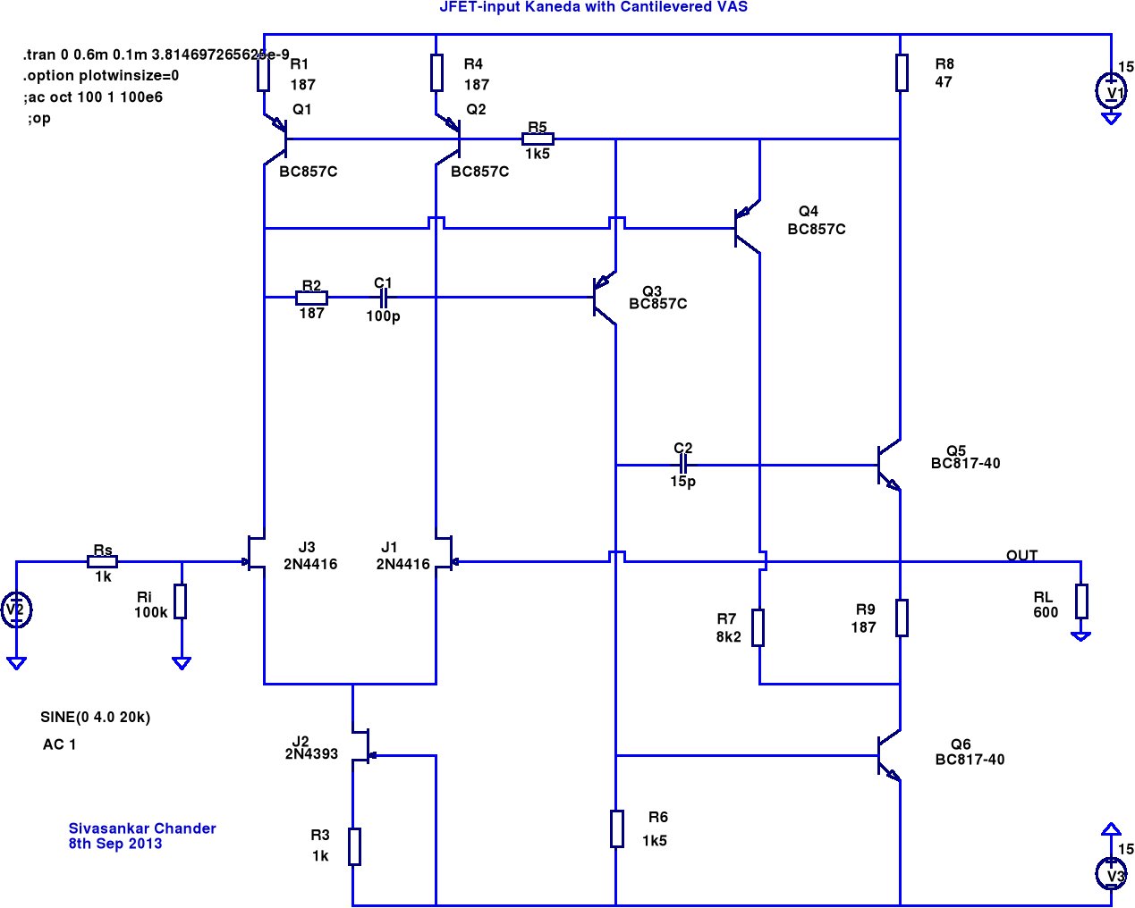

OK, now back to simulating topologies. Here's a Kaneda variant with active loads in the LTP, differential VAS and a Class-A output stage which borrows ideas from the Cantilevered Cascode Buffer I posted earlier. The upper NPN in the output totem-pole runs at (nearly) constant current, while the lower NPN provides all the output current swing, just like the CCB.
It has respectable distortion numbers, given that it uses only 3 JFETs and 6 BJTs - H2 is below -100 dBr at 4V output amplitude into 600R. Some further elaborations are possible to reduce H2.

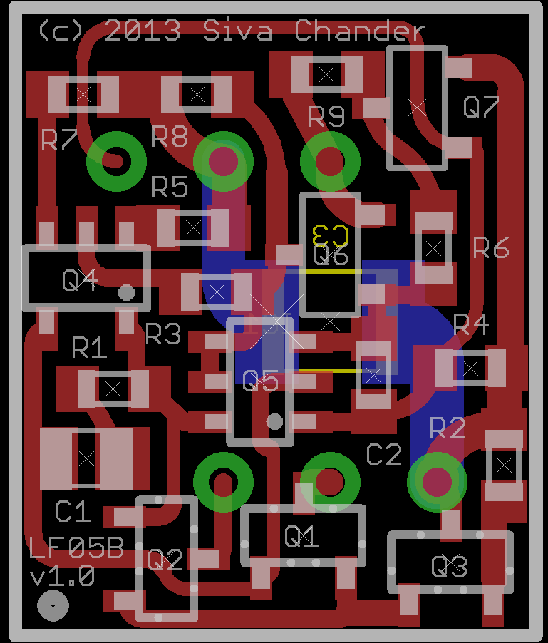

This is not quite 10x10 - it's about 12.7mm by 15 mm, but with no additional vias and almost entirely on a single side (the rail-to-rail bypass on the solder side is optional, in which case this is a pure single-sided layout). It could be crunched down a bit more by using SOT323, 363 and dual JFETs, but as it stands now it represents a reasonable tradeoff between ease of assembly and size. The dual BJTs shown are Rohm duals that are readily available.
The schematic is the Kaneda variant shown in the previous post.
