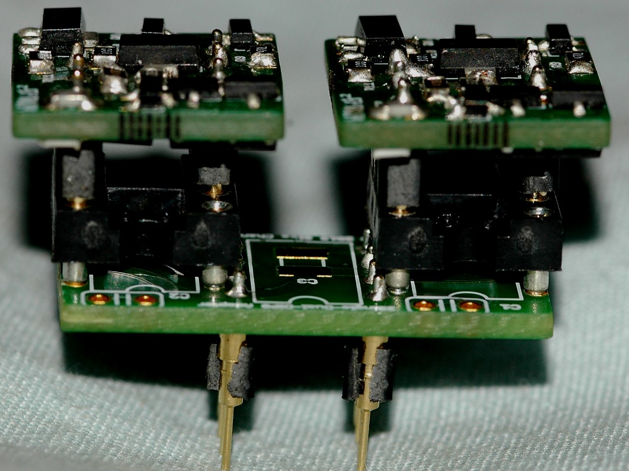

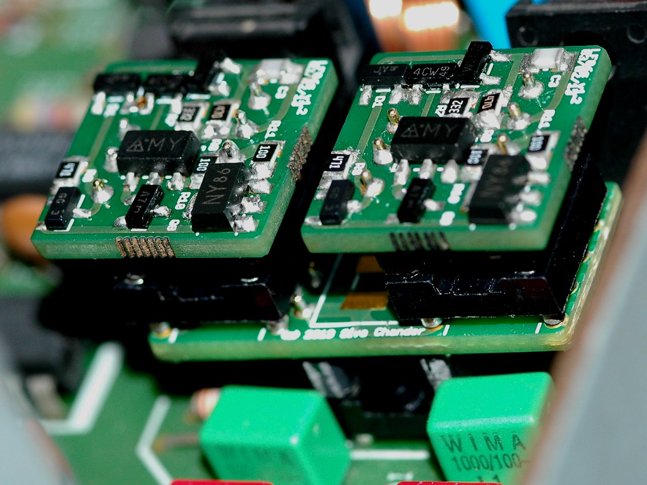

I added the bootstrapped clamp-diode circuitry to the next revision of the board (in the same 15 mm x 15 mm form-factor), but have not submitted it for fabrication - I'd prefer to catch any other changes/mods to the current prototype and include them as well if possible. The current prototype uses a BAV199 clamp diode, but BAS70-04 may work better in the bootstrapped version.
The current prototype works and sounds good - when plugged into the line output stage of a modded Kenwood DP-1001 CD player, it sounds very clean and analytical. I couldn't find space to install it in the I/V stage, so I'll do the I/V auditioning in a Marantz CD4000 instead. It requires a DIP8 single -> DIP8 dual adapter (like a browndog or similar) for use in a typical dual DIP8 socket. I've built a general-purpose adapter for this, as shown in the pictures below - the adapter + 2x LF06/FET990 are shown separately, as well as installed in the CD player.

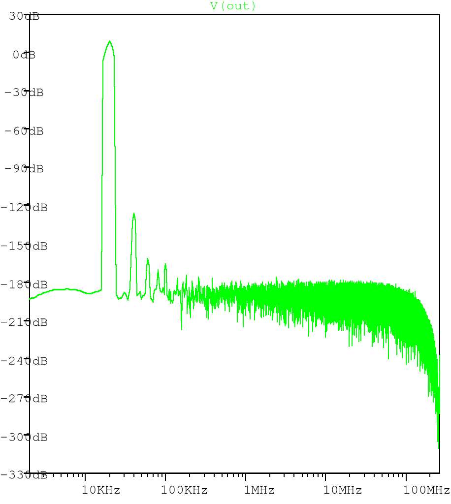

Meanwhile, I stumbled upon an output stage which simulates pretty good in Class-A or Class-AB. The preliminary sims are with an output stage current of 5 mA.
The topology started as a diamond buffer, but it could be looked at as a complementary Vbe-multiplier, a complementary pair of Baxandall super-pairs, or a complementary rush-cascode, etc. It isn't actually a true diamond-buffer, despite the superficial similarity. It's a bit more complicated than I'd like to implement, but there are some saving features - the low-power pair (BC847/857 in the sim) sees very little power dissipation, so it could be an SOT363 NPN/PNP dual, like the ubiquitous BC847BPN.
At 4V into 600R, THD20 is mostly H2, with everything else at ~ -170 dBr. I haven't exhaustively checked stability, but the unity-gain small-signal response looks smooth and continuous, so it shouldn't be a problem.
Edit: It could be grafted effortlessly into SWOPA as well, but bias stability and PSRR may need to be checked carefully.

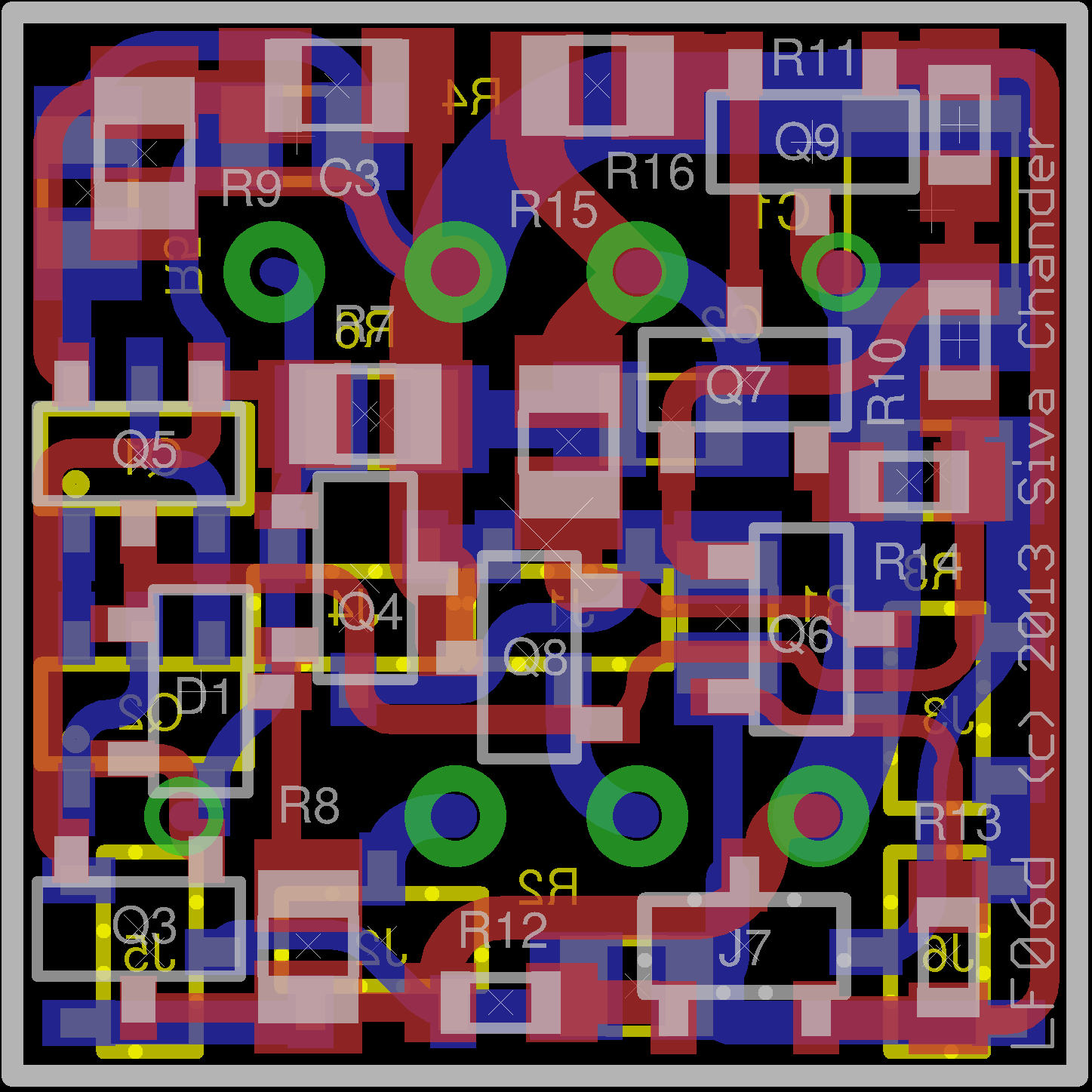

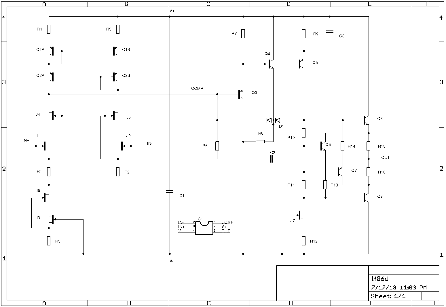

OK, just finished the layout of the circuit (with the new output stage, which I'll call the Diamond Cascode) in the previous post - managed to squeeze it into 0.6" x 0.6 " (15.2 x 15.2 mm) as before. Had to use 2x Rohm PNP duals for the Wilson CM, substitute the output SOT89s by SOT23s, 5x 0603 resistors (all the rest are 0805 as before), double-sided SMD.
I'm still mulling over the output BJTs - having a slightly larger footprint and SOT89s may be a better option. I'll play with the layout for a while before committing it for fabrication.
The output stage can be biased into Class-A, AB or B just by adjusting one bias resistor, R12. It might be worth using an SMD preset for that resistor, need to find one which is small enough.
Usually you need to use vector fonts on Eagle PCBs otherwise the text moves when you generate the gerbers.
Options -> User interface.. -> Persistent in this drawing
