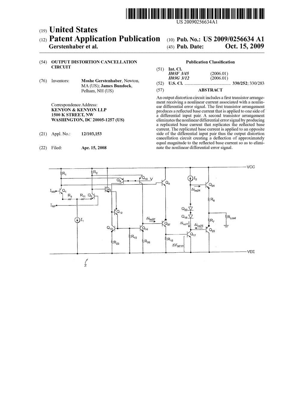

What can you guys do with this --- SIM it and change output stage and then bend it into a compl. push-pull. I find the cancellation methods very interesting toplogies.
The output stage base-current equalization idea is not at all novel - that particular complementary push-pull buffer Vbe-biased by a dual-diode and a current source has been used for maybe 50+ years. There's no way that sub-circuit can be defended against patent infringement.
However, the odd-looking loads Q6 and Q4 on the LTP collectors look novel to me, and I'll take a look later in simulation to see if they provide any benefit in distortion cancellation.
My preliminary guess is that the benefit is insignificant, since the bases of Q6 and Q4 are low-impedance nodes with negligible voltage swing, hence emitter of Q4 also sees negligible voltage swing (it's also low impedance), so it cannot help much in linearizing the voltage-follower Q37. But intuition can be misleading, and Spice may throw up some insights - will take a look.
In doing so, could this lead to another idea that cancels distortion. With low voltage IC's there has been a lot of recent (<10years) interest and patents in cancellation rather than cascoding, high nfb etc. A lot of new and interesting designs. Many of them.
The issue of ' is it audible' isnt always of primary interest. but new ideas are because they lead to other spin-off ideas and solutions to new applications. And, learning new concepts is fun in itself.
Thx-RNMarsh
