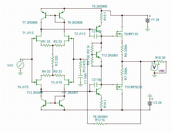

For the record, I did a simple Google search for two complementary jfets, the J113 and the J175. I found both of them for sale under $0.50 each. You just have to buy a bunch of them and select them out. If you cannot invest $100 for this, then buy an IC. It will give you better performance.
Yeah, unfortunately you're right. An LME49710 + LME49600 will do this job just fine and take up less space, but it's just not fun or a challenge.

I quite like this, but the FET output stage is a bit idiosyncratic for my liking. You could use a FET source follower with a BIP current source load for true class A output? No need to skimp on the supply current - this is DIY.
I juiced up the whole thing and distortion is now 0.0005% @ 20kHz into 30 ohms @ 1.1Vrms. DC offset on the output is -1mV.
I have since added Miller capacitors (@10pF each) to get rid of a 15dB spike @ 10MHz. Distortion is now 0.0006% under the above conditions. S/N is 120dB @ 10kHz.
Unfortunately, large heatsinks are required on the outputs.

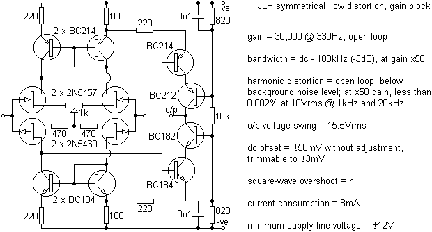

For the sake of circuitry discussions, this one from John Linsley Hood I found in my archive.

I think I'd start with this one, with updated JFETs. The output stage can use a J202 (maybe with a 2n5461 as the p-ch compliment), perhaps with cascoded drains to increase the rail voltage capability, a la Burson HD/OPA-Earth.
The input stage can be bipolar (2sc1845, etc.) or cascoded 2sk170. Also worth looking at is the Toshiba 2sk241 small-signal depletion-mode MOSFET for the input stage - low Vdsmax makes a cascode mandatory.
Hitsware, the N-N and P-P match are most important for low DC offset, without a servo.
The absolute Idss of the N-N can be somewhat different from the P-P pair because the SINGLE resistor bias FLOATS off ground and will find the best compromise automatically.
