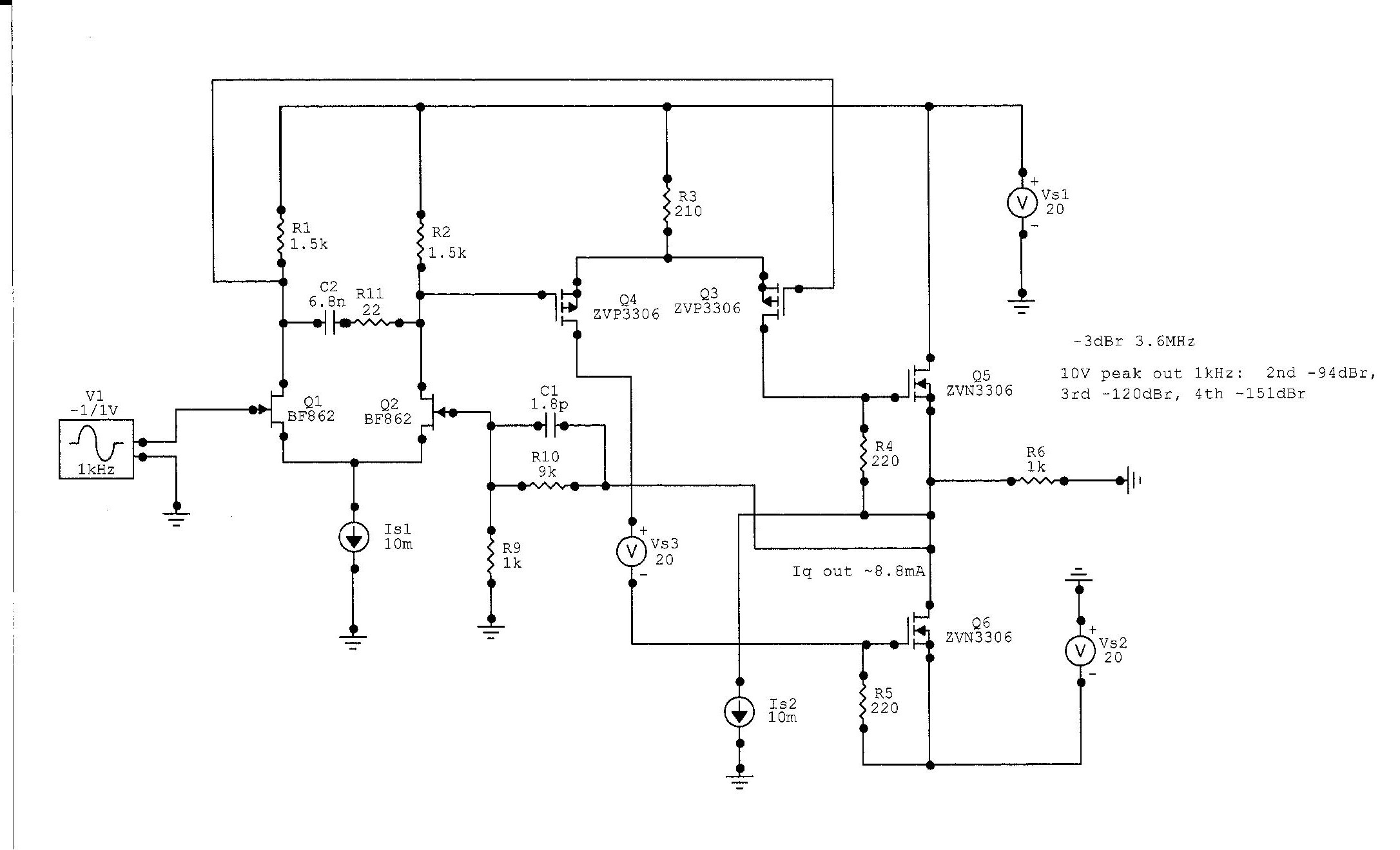

Speaking now of the Constellation-like simplified schematic from JC's post #168:
Too much gain for open loop, without a lot of local feedback/degeneration.
As an amp around which feedback will be applied:
The concerns about output impedance and stability are well-taken, but there are ~fixes.
For an example I threw down of BF862 input pair, ZVP3306 second stage pair, and ZVN3306 ouputs, 10mA in input tail, 10mA each in P channel, 220 ohm bias R across each output G-S. I see an open loop output impedance resistive to about 92kHz of 2.1k ohms. But one of the problems is that the lower output device must supply all of the input bias current of the upper device, so this intrinsically unbalances the P pair. Throw down a current sink from the output (or just a resistor to the negative rail), then the second stage can be balanced. It's also good to put some voltage drop in the one drain to equalize the drain voltages of the P devices.
Compensation can be done, as some (e.g. Borbely) like, across the input pair drains, a series R-C tailored to the desired closed-loop gain; slew rate doesn't suffer much, since there is a large voltage gain following, for moderate output loads. A disadvantage is that at high frequencies the input pair can't do much to reduce the contribution to noise of the second stage (see discussions about the AD797). But DMOS isn't bad at high frequencies, only at low (and less so as processes continue to improve, but be wary).
Now some can argue that the bias resistors could be made larger, but then we run the second stage at lower current, and the input capacitance of the lower N output will slow that section down.
At least, if the two output devices are reasonably well-matched, and perhaps with some ballasting R in the sources, the quiescent bias can be not too unstable.

....one of the problems is that the lower output device must supply all of the input bias current of the upper device, so this intrinsically unbalances the P pair. Throw down a current sink from the output (or just a resistor to the negative rail), then the second stage can be balanced. It's also good to put some voltage drop in the one drain to equalize the drain voltages of the P devices.
The proposed source resistors at the output stage are essential for a rugged real life design. Fortunately we are not heading for efficacy and/or excessive output swing, we can easily spend 1V on each source resistor, which will knock down the thermal drift of the output stage reliably and avoids the need of further thermal compensation diodes and thermal couplings with the input stage.
Such source resistors will theoretically increase the output impedance, which is not so much desired, but good for PSRR . Bringing down the output impedance and keeping high PSRR can be done by a I/V resistor at the output (...was somewhere proposed earlier anyway), but most likely increases distortion compared to light load situations.
The intrinsic imbalance can also be reduced by giving the lower Mos a higher source resistor value.
I guess the original usage of that circuit was in an application were the output stage is running at significantly higher currents compared to the driving stage (ref. quasi complentary BJT output stages of power amps).
Regarding the 2nd order distortion struggle between Wavebourne and John, I tend to say that Wavebourne's concerns are basically fitting to the nature of the circuit. The tail which drives the upper output device is operating at massively modulated Vds while the tail which drives the lower output device is operating at low modulation of Vds. Anybody crying for cascoding? No, I would tend to live with it.
Last but not least. I doubt that a simulation with standard models is the right tool to analyze distortions in the sub -80db range.
In my experience the sim helps to find the right direction and see the fundamental nature of the distortions. But in all my past simulate+build trials it turned out that the sim was much nicer than reality.

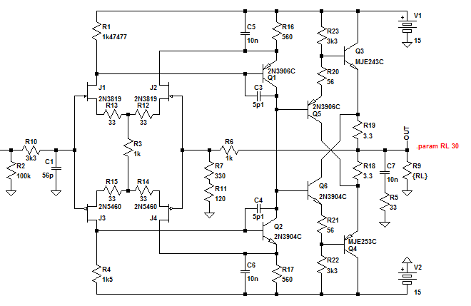

I'm on the Bonsai side (FET only in the input stage, please), and I'm going to give a try in a few days to this little beast - it is basically a JC-2 with a high current diamond output stage suitable for driving low Z headphones: simulation results are quite good (OLBW > 30 kHz, THD < 0.001% up to 20 kHz @ 100 mW into 30 ohm), and employs fairly standard parts (it happens my drawers are full of 2N3819 and 2N5460
) - I'll let you know.
Ciao,
L.

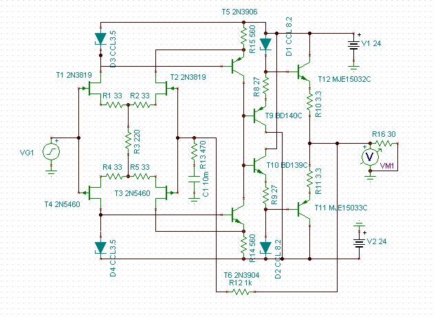

This one gets my vote. It has 10 transistors though.
Ciao,
L.
I juiced up the whole thing and distortion is now 0.0005% @ 20kHz into 30 ohms @ 1.1Vrms. DC offset on the output is -1mV.
I have since added Miller capacitors (@10pF each) to get rid of a 15dB spike @ 10MHz. Distortion is now 0.0006% under the above conditions. S/N is 120dB @ 10kHz.
Unfortunately, large heatsinks are required on the outputs.
