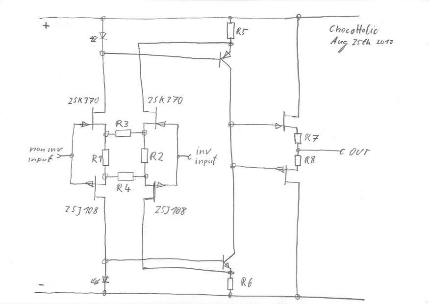

What would you expect from a configuration like this?
The input stage does not need additional components for biasing.
It will offer high input impedance and low noise.
R1 and R2 allow adjustment of bias independently from adjustment
of gain and degeneration which is solved by R3 and R4....
Last but not least you could use such an OP amp for voltage feedback configurations and current feedback applications as well. In current feedback applications one could use the nodes of R1 as current feedback inputs, or center tap R1...
All the rest of the circuit is mostly standard.
That looks really interesting. I almost understand it.
What would you expect from a configuration like this? ...... All the rest of the circuit is mostly standard.
I'm not sure what you are asking from us. As you observe yourself, the circuit is mostly standard (essentially being a complementary folded-cascode + source follower).
The input stage is not that much standard.
...hm, and when we combine this input stage with the second and third stage of John's proposal in posting #179 then it starts to look really nice.
Edit:
Nevertheless the basic circuitry of John's posting #169 (I guess source resistors at the output MosFets would be necessary for a real life set up to stabilize and linearize the output stage) is still my favorite, because it has essentially just 6 transistors and you only need matched, what you can get matched. Means it can be optimized without having exactly complementary types. Definitely worth to spend some time with !

In addition to Ken's question, I am wondering whether the natural output impedance (without feedback) is low enough to be called a OP amp output stage. To me it appears more like both output MosFets would act like inverse controlled currents sources and consequently would deliver a high output impedance.
...on the other hand, there is no proof that only circuits with a natural low output impedance sound good.

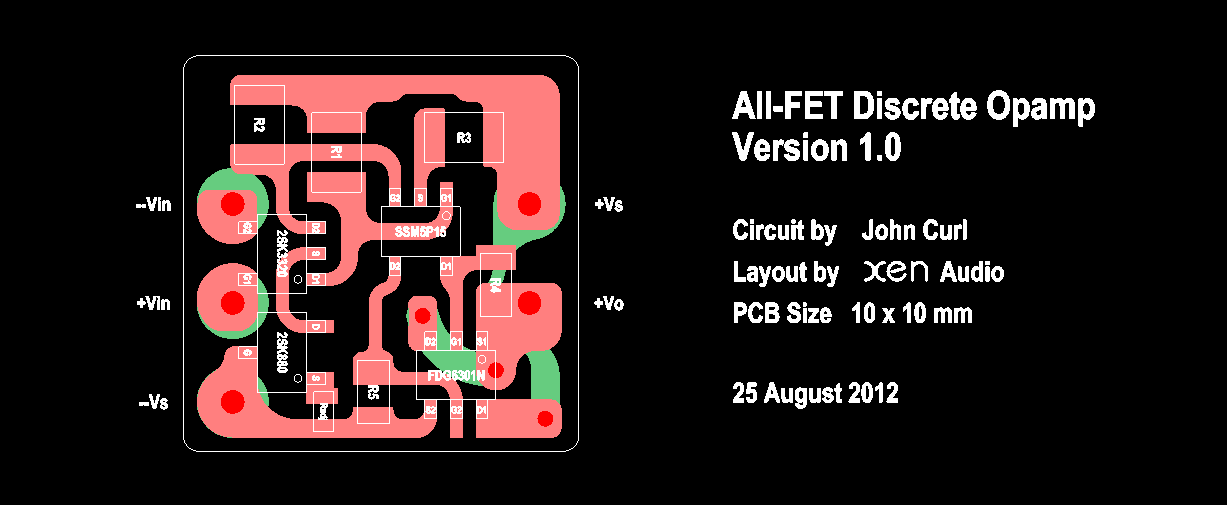

I'll do a PCB layout in SMD. I like this.
Patrick

Also the small Dual FETs allow a single aided layout on a DIP8 footprint.
So it gets my vote.

0.4mm plate through holes to connect top layer to bottom layer.
I did not quite manage to get it all in one without jumpers.
And I am sure you don't want to solder 0.4mm enamel wire jumpers.
