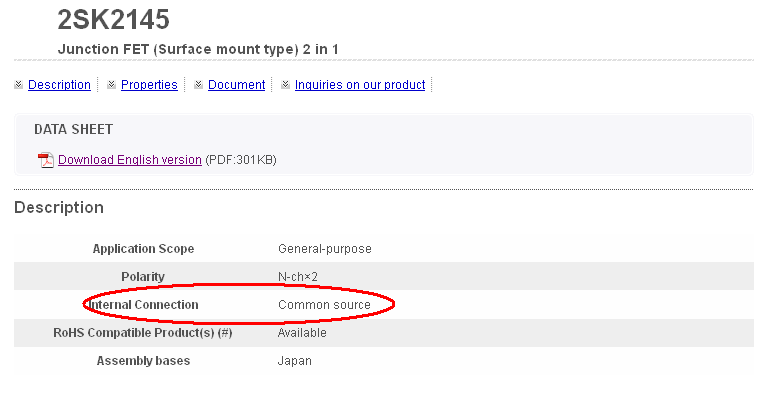

2SK2145, the ratings/specs are for devices in parallel operation or single devices?
Afaik not all jfets can be run "backwards"... most?
...then the question is the IDSS group 1/2 of the parallel IDSS or??
So, what is the application for a dual jfet with the sources tied together - or why not internally wire them in parallel and offer the device as a "single"?
Scott,
A SMD dual JFET in SOT23 is too good for me to give up, so I went back to the Toshiba website.
It says (see attached) internal connection common source.
So it can at least be used for input LTP.
Toshiba never says whether their FETs can be used with D/S swap.
All the ones I tried can, even though some has a slightly different Idss when reversed.
But this is solvable even if the lower FET has lower Idss when reversed.
Just tie a resistor or a CRD from Vout to the negative rail.
So I am still on for this one.

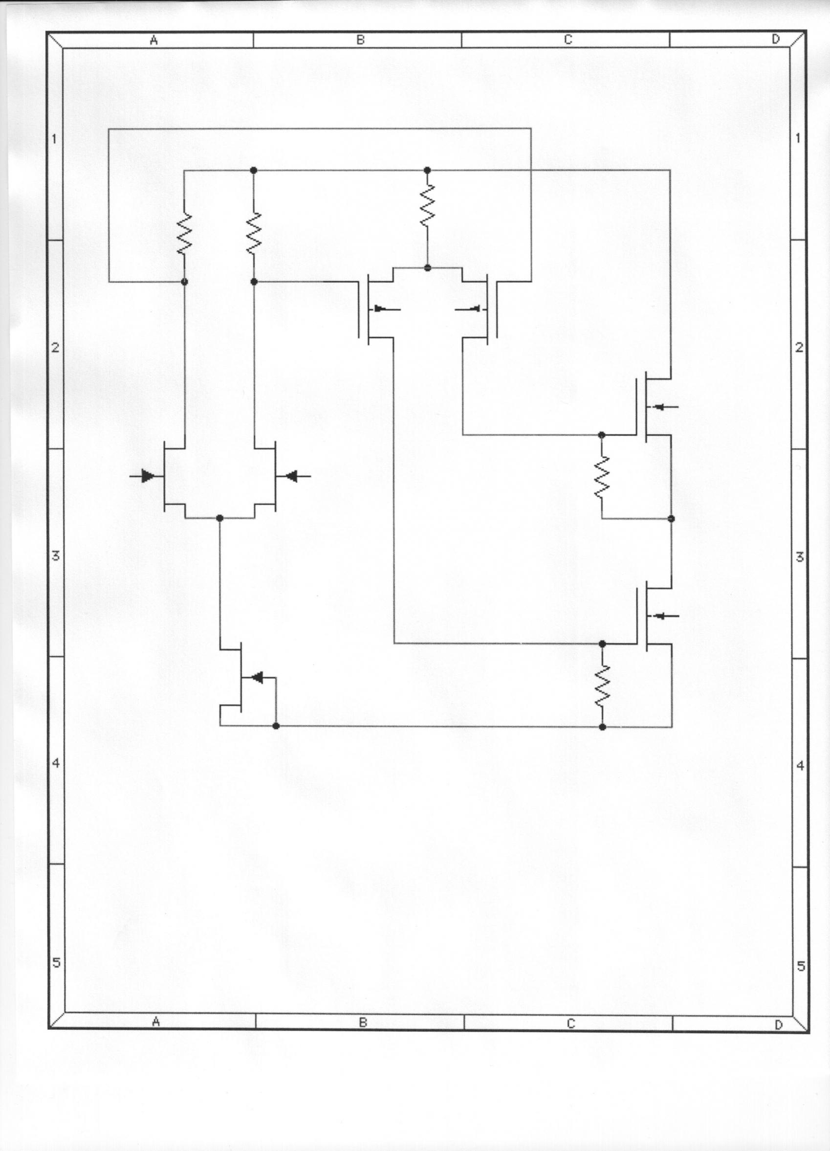

I think Dave posted the wrong link.
Here is the link to John's circuit using N-JFETs as input.
http://www.diyaudio.com/forums/anal...discrete-opamp-open-design-4.html#post3138300

John,
Would you be so kind to pick a Dual P-MOS for the second stage, before we get Spice models for simulation ?

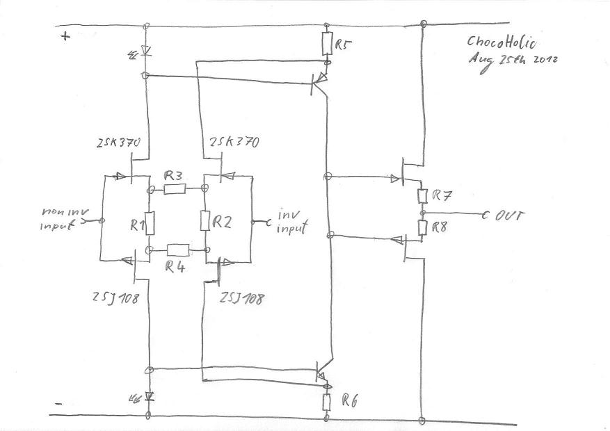

What would you expect from a configuration like this?
The input stage does not need additional components for biasing.
It will offer high input impedance and low noise.
R1 and R2 allow adjustment of bias independently from adjustment
of gain and degeneration which is solved by R3 and R4....
Last but not least you could use such an OP amp for voltage feedback configurations and current feedback applications as well. In current feedback applications one could use the nodes of R1 as current feedback inputs, or center tap R1...
All the rest of the circuit is mostly standard.
