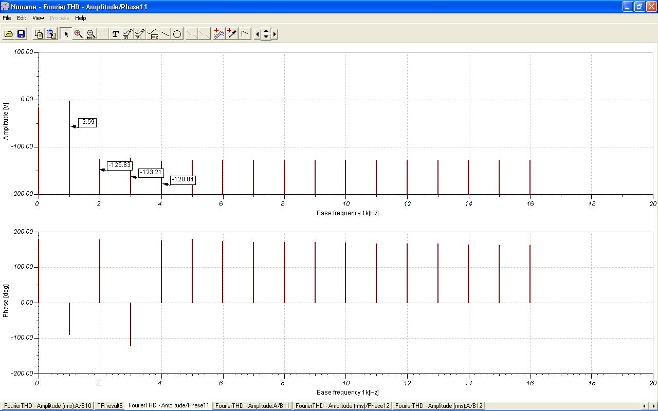

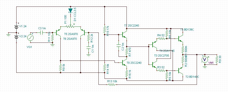

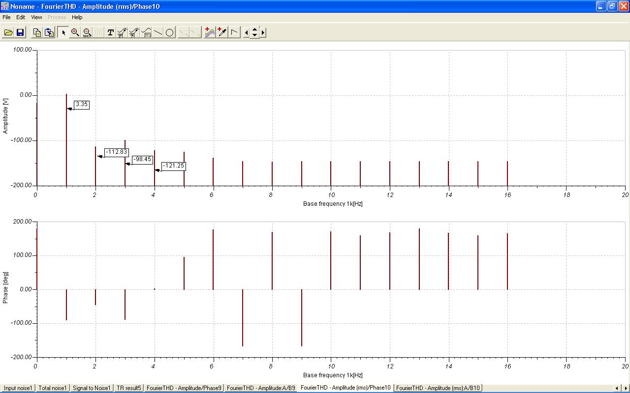

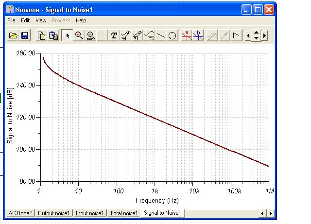

I didn't think it was possible, but if you're not counting current sources, this one has 8 transistors and 1 current source. It doesn't meet the output offset requirement. Oh, and this is at 2+ Vrms output. So, distortion is lower at 1 Vrms.
