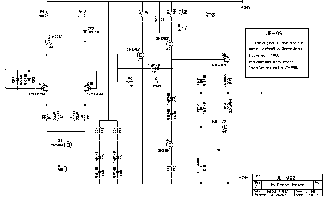

Anything less complex than a Jensen 990 is a joke, and not worthy of consideration. We are looking for EXCELLENT circuits that we would use in the best audio equipment available today.

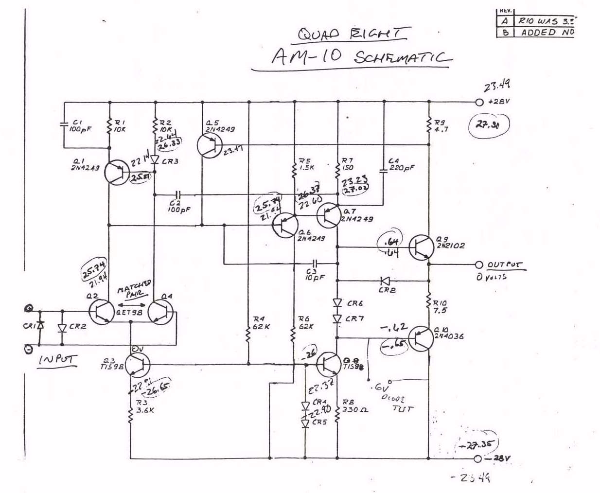

Number two (from post 68) is not too bad. Whose is it? It looks like something that really works.So, some schematics a copied off a simple search. So much talk, so little action.
