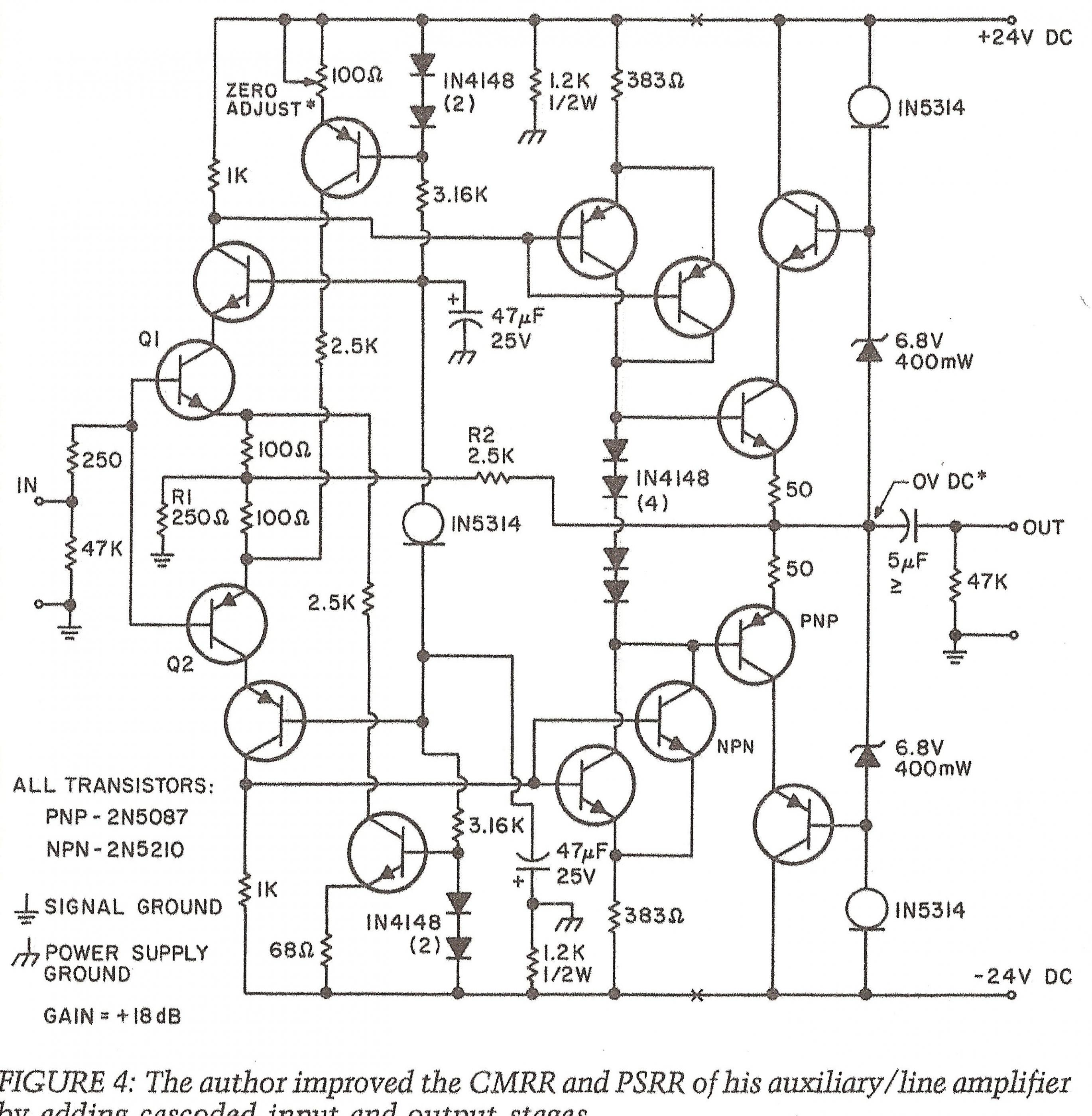

Meanwhile, for historical purposes (or hysterical) the all bipolar version of the topology I did 30 years ago is attached. I would only add a dc servo and put the output 6.8v zener to the output emitter (causes Ic to increase to 17mA - so TO5 or greater pwr needed). Or add the output stage I used with jFET input version shown earlier for driving low Z loads. The complimentary push-pull topology has turned out to be very popular and versatile. -Dick Marsh
