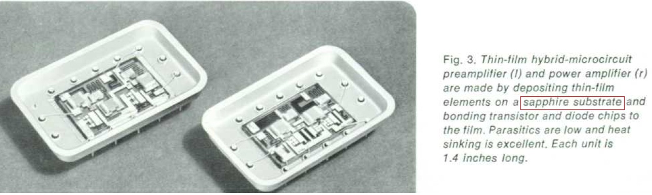

I still can’t grasp it (don’t worry jneutron, it’s not your fault), but I found an extreme implementation –pages 9 to 11 of the link- that proves me wrong.
And like I promised, now I’ll shut my mouth (but the earth rotates… :D )
http://www.hpl.hp.com/hpjournal/pdfs/IssuePDFs/1971-01.pdf
It is exactly what Wavebourn initially suggested.
George
Thank you for that nice link. Thier "bootstrapping" of the drain/source leads is a somewhat rudimentary design. We call it a thermal "anchor", or "heat station" here, but we do it to a 4.5 kelvin LH2 point, or a 50 Kelvin LN2 point. We need to measure to accuracies of .001 Kelvin in the 1.88 to 55 Kelvin range.
A better design would use 4 serpentine runs on the substrate, and there would be symmetry in the lengths of the drain and source wires. Otherwise, there could be a forced gradient across the chip drain-source channel. Oh, we also use #32 AWG phosphor bronze wire to reduce along the wire conduction.
jn

I understand that is a necessity at your activities to split hairs, not common to others jobs.
I have noticed the effect of wires heat conduction and/or added heat inertia in more down to earth applications with this hobby . For wiring thermal tracking transistors /bias adjustment in amplifiers and semiconductor temperature sensors,apart from cutting their leads short, I use very thin magnet wire (and as a bonus, added flexing and tight twisting).
