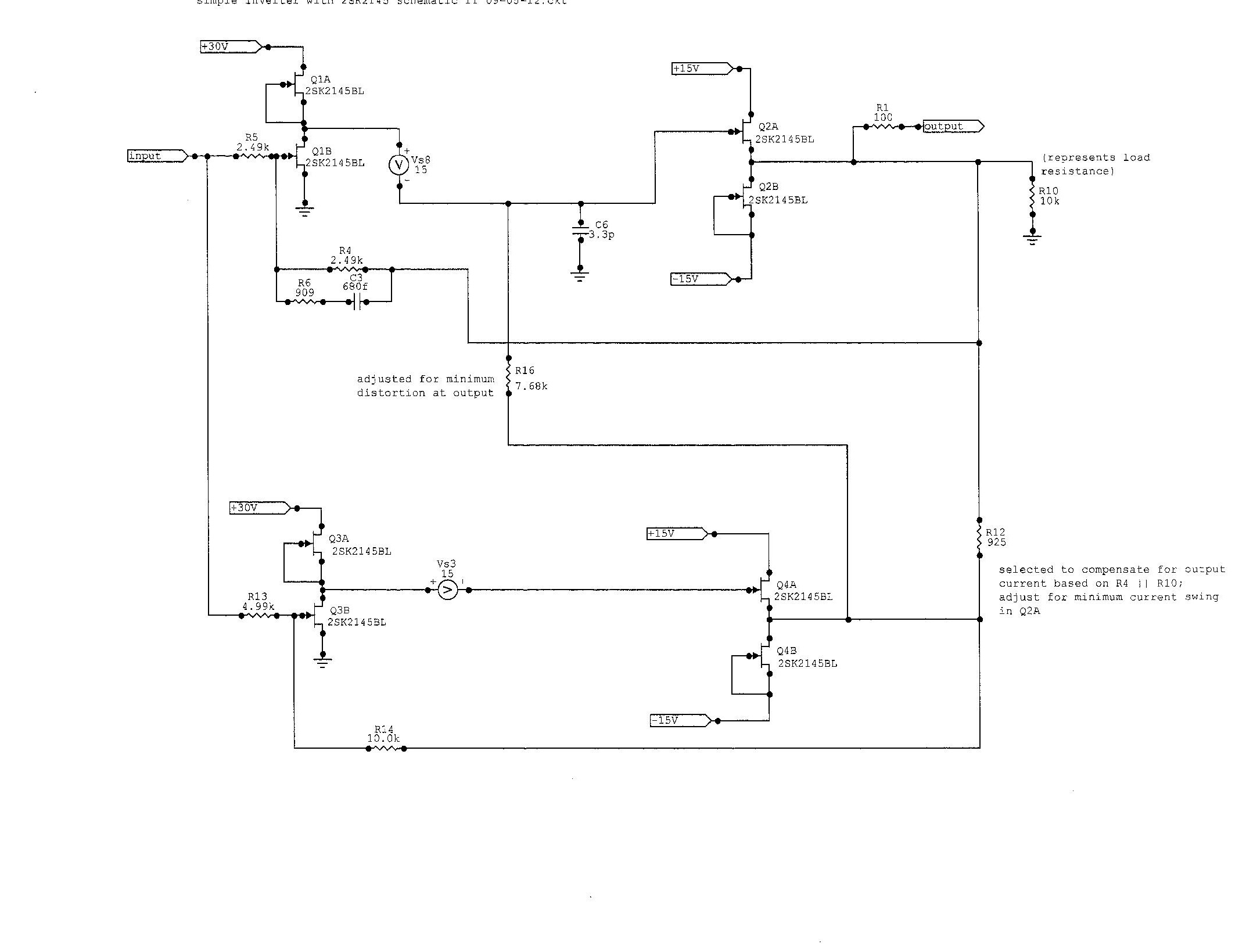

To clarify what is up in #766: Consider everything above R12 and R16. It's a fairly straightforward common-source amplifier with a matched current source load, with a floating level shift to a common-drain voltage follower with a matched current sink load. Closing the loop around it produces an inverting gain of about unity, with the noise dominated by resistor thermal noise. The performance by itself is not bad at all considering the minimal component count. The level shift could be done in a number of ways, perhaps the best except for physical size being a battery.
The stuff added to it enhances performance markedly, by effectively increasing loop gain and eliminating loading on the upper section's output. And yet the auxiliary section adds almost no noise --- the upper section remains by and large "in control".
The performance results will be spoiled to some extent by thermals in the input devices, since the full voltage swing appears there, although the BL parts should be close to a zero tempco operating point which will help a lot. There are ways around this with more parts. If the floating bias voltage in the upper section cannot be fairly low impedance, the helper resistor R16 can be capacitively coupled to the drain of Q1B.
Power supply rejection, distortion, and bandwidth predictions are all very good indeed. Nonfloating bias sources can be made but it adds a lot of parts. Variants include multiple output devices for higher drive current, higher-than-unity gain, etc.
