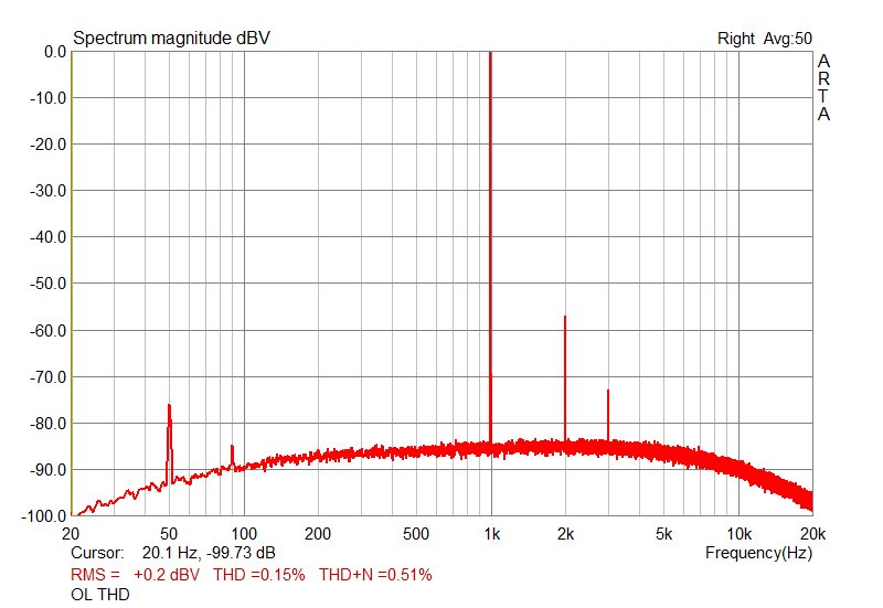

coluke, what kind of distortion figures/spectrum do you get OPEN LOOP?
Did a very quick and dirty test (see attached sample FFT run): open loop THD @ 1kHz, ~0dBV into 30 ohm is about 0.15%, only low order. OLG is about 62 dB, OLBW > 20 kHz. Closing the loop at 10 dB gain leaves you with about 50+ dB of loop gain midband - closed loop THD should be even less than the figure I've got (0.0013%). Actually the baby is quite polite :D, but probably a slightly better layout is in order... :xeye:
