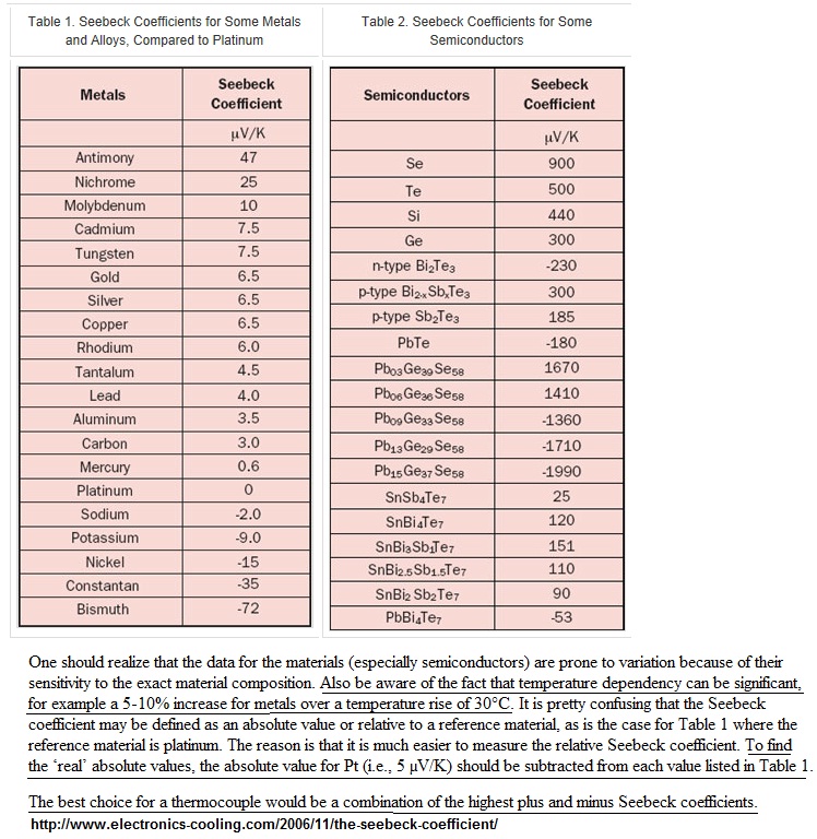

Google for Seebeck effect; The Seebeck coefficient is a material property that depends on temperature (micro volts/ degree C.) From that, EMF can be found....
Some Seebeck coefficients are: copper to silver or gold = 0.5 uv/C; Copper - nickel = 10; Copper to KOVAR = 40.
Strange one is copper to copper is not = 0 [thermal gradients matter].
Also google Thermal EMF of Solders.
Thank you very much RNMarsh
From this paper (some will love it ) http://monarch.qucosa.de/fileadmin/data/qucosa/documents/5563/data/Dissertation_Mhiaoui.pdf
page 94, the Sieebeck coeff. for Sn60Pb40 solder is –1.06 uV/K at room temperatures
So copper/Sn60Pb40 thermal EMF is 2.6 uV/K
The big problem could be with Nickel/copper (~ -19uV/K) or Nickel/Sn60Pb40 (~ -21 uV/K)

KOVAR
Also KOVAR, the transistor lead material that you solder to
the pcb. Made more for the thermal coeff of expansion compatibility with the other packaging material. So, here you have many different metals/alloys --the transistor lead metals, the pcb metals and the solder metals.
Then you must consider the thermal gradiants across the parts in the physical circuit layout so as to minimize temp diferences across a part .. like a resistor or other... you want to have same temp at each end of the resistor or part.... For example, when a pcb is mounted vertically or on its edge to conserve chassis space/size you will easliy have different temp from bottom to top of a part if it is also mounted vertically..... better to mount it horizonally. [Am I being clear?]
If you dont control all thermal factors, you wont get absolute best possible performance in terms of dc drift, noise and possibly distortion. These things are all part of making a SOTA amp from a schematic. -RNM

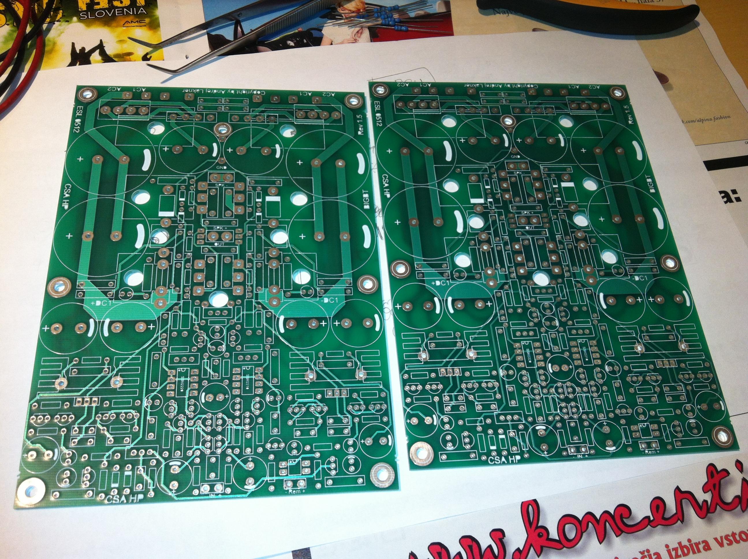

Also, speaking of PCBs and their orientation, it is better to orient them such a way so components are better cooled by convection.
No rules of dumbs here.
http://www.diyaudio.com/forums/atta...wer-supply-resevoir-size-csa-bigbt-hp-pcb.jpg
