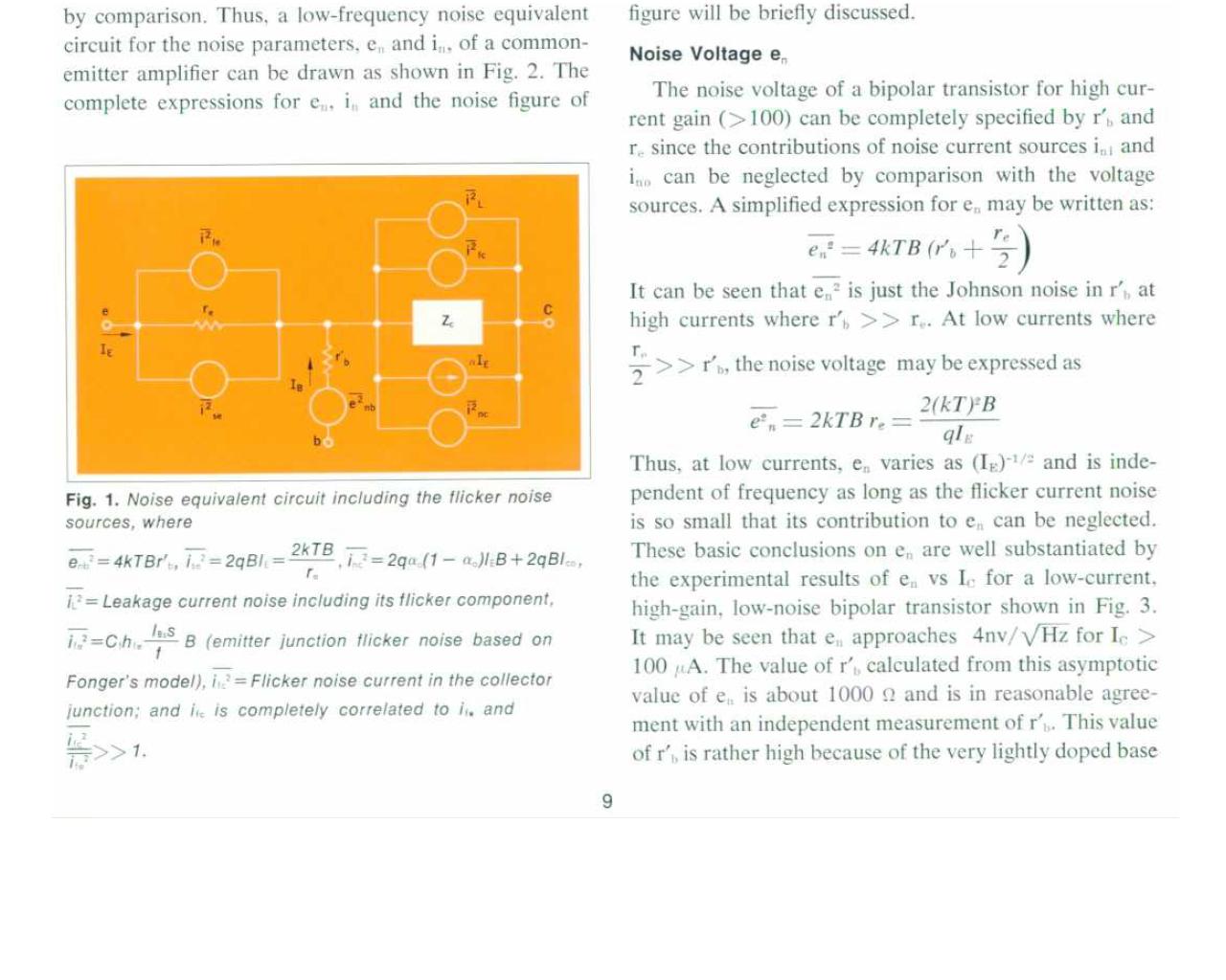

JFET gate leakage has at least full shot noise, 2*qe*Io per square root Hz, where qe is the electronic charge in coulombs and Io is the magnitude of the current.
I was hasty there, should have said the mean squared noise current from a full shot noise process with a mean current of Io is In^2 = 2*qe*Io*delta f.
An example for a typical base current of 1uA: in a 10kHz bandwidth, 56.6pA rms.

Shot noise (sqrt(2*qI)) comes from first principles, the statistical limit on noise from uncorellated events. Many devices have excess noise usually at low frequencies, or just noise in general from poor design or necessary tradeoffs.
what would be an example of an uncorellated event's source/cause? Odd dopes? Impurities? Thx
