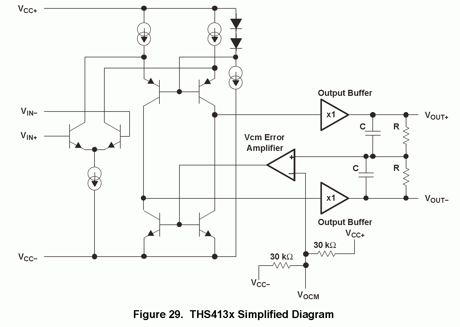

fully differential OPamp
How about fully differential OPamp a la OPA1632 (aka THS4131)?
