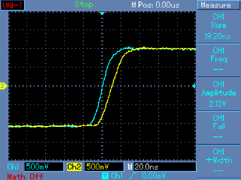

Hello, these parameters are not so difficult to get. Let me consider them and let me add time response. Blue is input signal, yellow pre output.

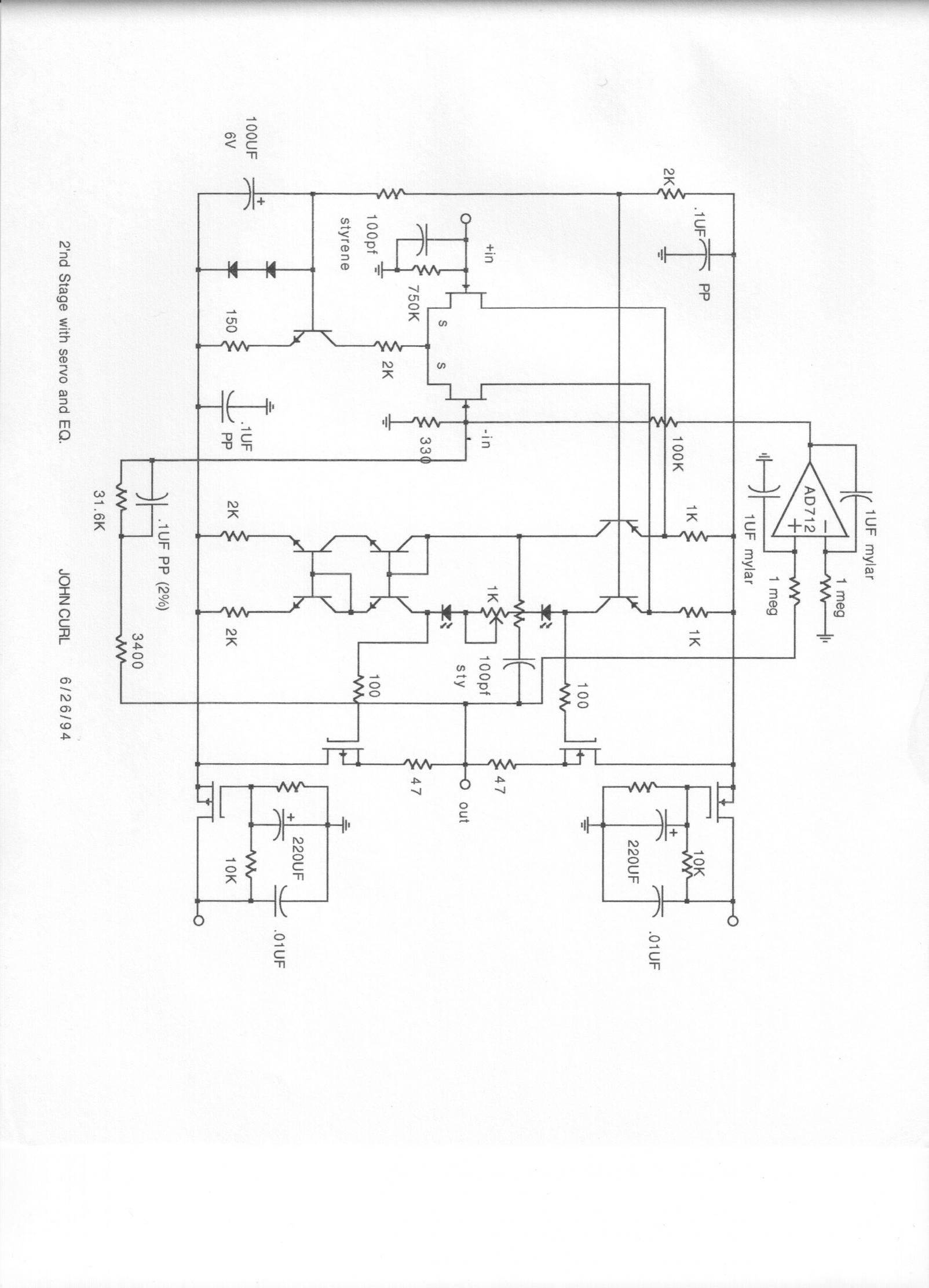

Kindhornman, the schematic I put up was designed for Parasound 18 years ago. We made prototypes then, but Parasound decided NOT to build this product, so this schematic has lain fallow for the last 18 years. I found it accidently this week in a manilla folder that I seldom look through.
However, just today I DID get a copy of Linear Audio Vol. 4. (Thanks Jan) and to my amazement, I saw virtually the SAME input and second stage (with small changes). I guess that Bob Cordell is on track! '-)
Perhaps when the time is right I can put the FIRST stage in, as well, as it is slightly different, and 3dB quieter, or so.
Anybody want to buy a slightly dated phono stage, that sounds pretty good, I have a prototype or two sitting around the lab. '-)
