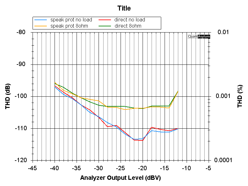

This thread has inspired me to dig out my prototype MOSFET speaker protect circuit and measure it.
The power amp is a Blameless style design with CFP output stage, I've measured it with and without 8 ohm resistive load, and before and after the protection unit:
The responses are the same before/after protection to within measurement variation I reckon. The levels on the x-axis are input to the amp, it has 27.7dB of gain, so its really -12dBV to +16dBV at the speaker terminals.
So pretty conclusive that it's performing nicely, given it uses IRLR3717 MOSFETs with 3.4 milliohms on-resistance it seems to show good linearity of that resistance (if it were non-linear it would provide upto a maximum of -65dB distortion under 8 ohm load, but its clearly well below that.

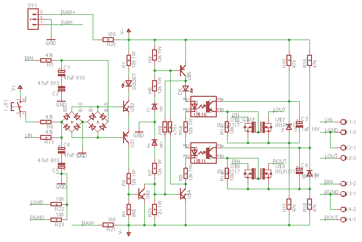

It borrows a technique from Doug Self for sensing, but I think I adapted it for opto-coupled MOSFET outputs. It doesn't need any special supply voltage, just the main rails and ground, so it ought to be fittable to any amp really. It lacks latching ability currently but its a proof of concept:
