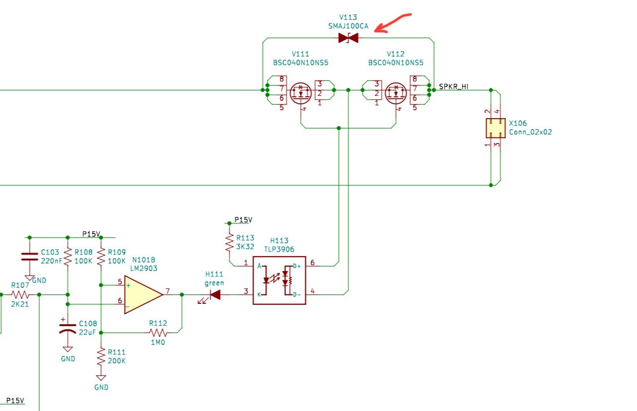

I think the TVS is a useful addition to a mosfet output relay. You could alternatively run reverse biased diodes from the output side of the SSR to the amp supply rails so any inductive energy from the speaker load is dumped back into the supply rails. This is a little more inconvenient than a TVS for a stand alone SSR, but if you are integrating the SSR on your amp modules, it just means placing the protection diodes that you would in any event place across the output bipolar devices after the SSR. mosfets come with drain-source body diodes that offer back emf protection but not if you are worried about speaker back emf and you are using a SSR. In that case, if you opted for diode protectio, you would still have to add the. After the SSR to the supply rails.

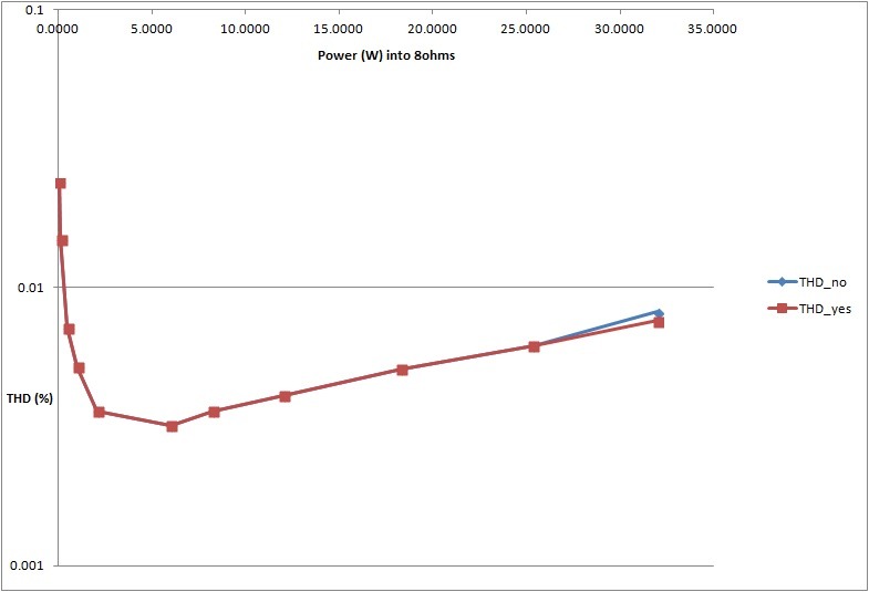

The distortion introduced by SSR’s is negligible - Mark’s measurements attest to that as are the other measurements done by DIY audio members. It’s easy enough to see why. If your SSR is say 5 milli Ohms and it’s it’s 1% non linear, that’s 1% of 5 milli Ohms and 5 milli Ohms is .0625% of 8 Ohms, so the actual worst case effect is .000625 ie 6.25 ppm. But, when turned on properly, mosfet Rdson variation with load current is much less than 1%, so the distortion contribution is in effect much lower than 6.25 ppm.

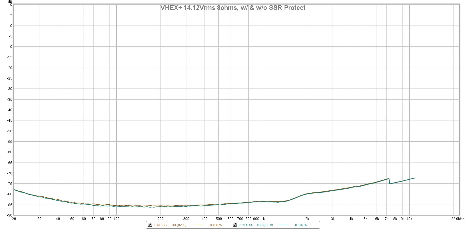

No added distortion- measurements essentially show no difference. If anything, there is less distortion with SSR. I think there is a reason for this, as it was also observed by tomchr in his SSR protection.OK, thanks.

As function of power:
As function of frequency with and without:

If I understand you correctly, the mosfets are safe by its internal diodes.
So putting the TVS for the speaker?

Thanks. Also Nuerochrom has nice graphs.No added distortion- measurements essentially show no difference. If anything, there is less distortion with SSR. I think there is a reason for this, as it was also observed by tomchr in his SSR protection.

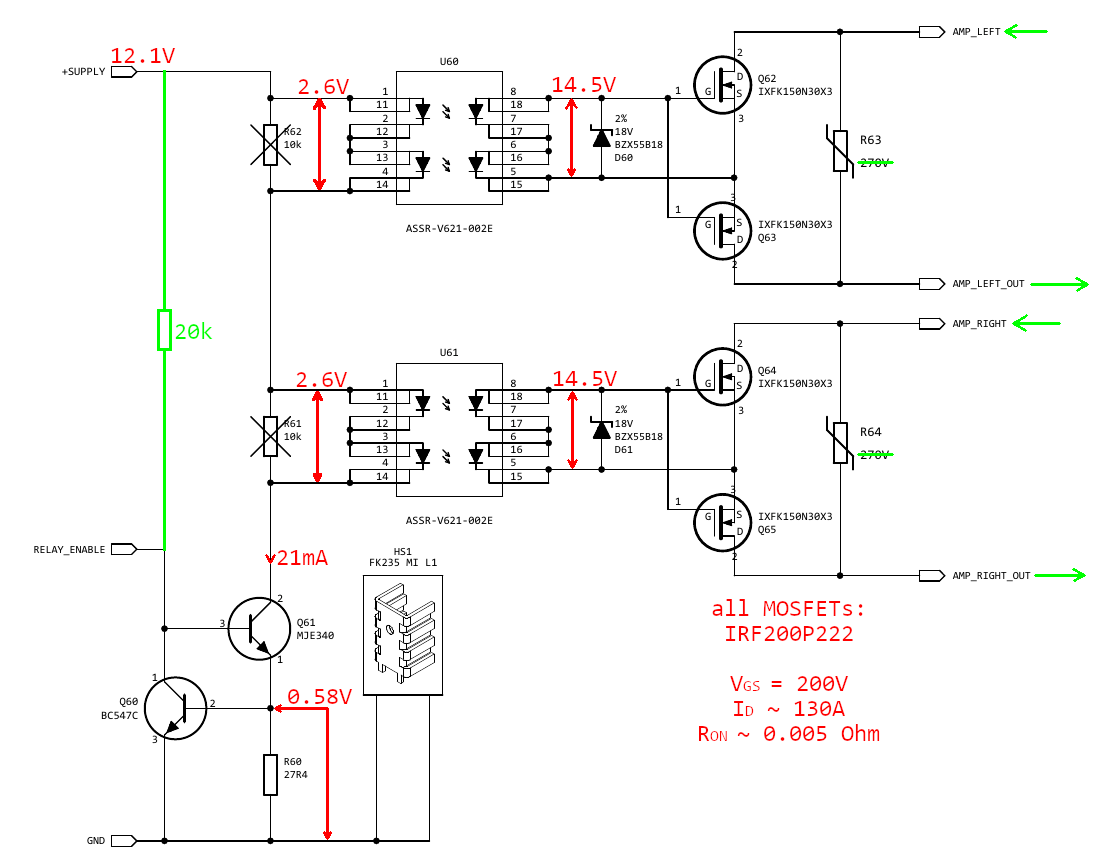

I have already build SSR protection and indeed no added distortion.
I did not put TVS and recently I was thinking maybe it is a mistake.
I started to think about that after I understood that the speed of the mosfet is not obtained becuasd it is the DC sense delay that dominant. That the reason the inductance charge fully and then one obtain a huge emf because the shut down is now fast by mosfet 😊 .
Then I started to think of I need go protect the mosfet .
I think a promotion to mosfet protection is not the speed but other thing.
Maybe to say that EMR sometimes does not open at all!

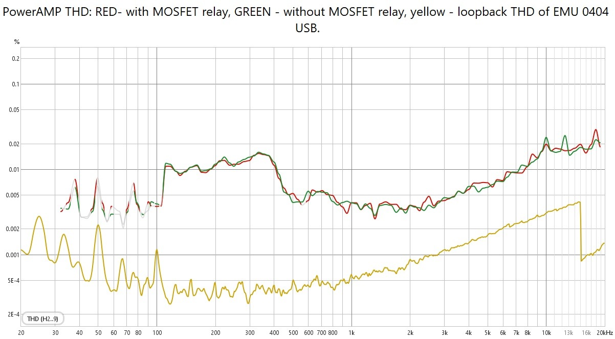

Several years ago I measured the THD (10W@4 Ohm) of the power amplifier with and without MOSFET relay protection made by my colleague (@VEC7OR). I could not detect any difference in distortion with and without the relay made using modern (=low Rds) MOSFET switches.
- Distortion Measurements of a MOSFET Relay for Loudspeaker Protection
