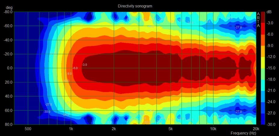

Ahh bummer, I thought you said before the rear data wasn't absolutely necessary. Maybe I just imagined that. I'll need to do some more testing soon and when I do I'll see about getting the time lock on Holm to work as well.
I think that what I said was that the accuracy isn't critical, but the algorithm needs to have something in the back to estimate from. I tied to just assume that the response goes to zero, but this worked poorly - the reason being that there is actually a bright spot dead on the rear so zero is a bad assumption.
What does Holm do that REW doesn't?
Two things; 1) Time lock a series of measurements; 2) export a series of measurements as a single file.
How does the response look if you equalize on-axis flat to 500 Hz or so? Hard to tell exactly where the pattern control is lost.
I mean, if pattern control is lost at only 18", that is bad news for my own unit.
I'm not comfortable running my 1" exit cds down to 500hz, sorry. I think when I xo to the woofer at 800-900 the directivity will be just fine in the horizontal.......it was with my 15" waveguides from earlier in this thread. Earl's 18" wg on the NS-15 does well and I think he crosses around 800hz.
It's been awhile since I read the REW docs, but I don't think it uses the Farina method for the log sweep like Holm and ARTA........don't hold me to that though. You can do a dual channel measurement in REW which should work like the time lock in Holm. I prefer the dual channel method when looking at phase for xo design.
