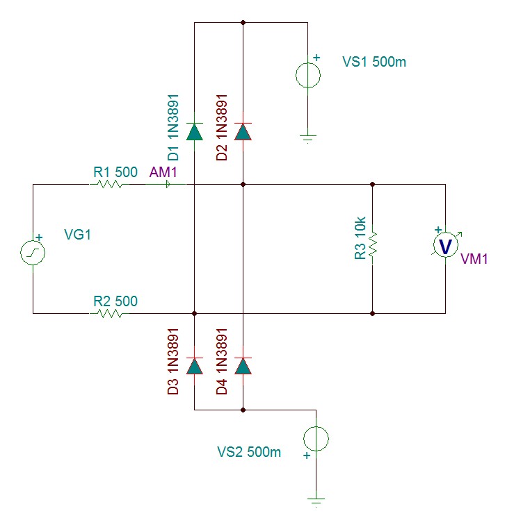

Yes, I've found Vout of my preamp was ~140V after I've measured it during touching grid of input tube to make that buzz that destroyed my 0404.
After that I've put two 2.7V (could not find lower) zenners back-to back to its out, and two bright red LEDs between them so they indicate overload.
I think this will allow not more than 7Vp-p.
What diodes would you recommend?
The usual practice is to create the voltage limits (usually the power supplies) and clamp with reverse biased 1n4148 diodes. That works well and is low distortion but you need the supplies and a series resistance to limit the current. Using Zeners introduces distortion because they start conducting well below the clamp voltage. Doing this in a tube system is difficult since there are no low voltage supplies to make use of.
What is the output impedance of the tube circuit?
I do not know Zout, did not measured it. It should be low, 150R or less.

With the low output impedance you can get enough current to damage devices.
The best way to protect would be the following-
create a +&- supply at the voltage limits you need -.7V (if possible). Connect reverse biased diodes from each rail to the input. The diodes won't conduct until the input swigs past the voltage rail. You need some form of additional protection however. The options are a fuse (100 mA), a series resistor that can handle the worst case voltage and current (10K 2W?) or a miniature lightbulb rated for the max voltage. The lightbulb is attractive because when cold, normal case, its resistance is low but when power is applied its resistance increases limiting the current as it warms up. This is what I see in current generation distortion analyzers.

Thanks Demian. I tried it in Tina TI SPICE. With Vs +- 500m and Vin 150V it decreases Vout down to +-2.5V, which is still kind of overvoltage, though I suppose it is tolerable by most of line inputs.
In LTSpice it behaves weirdly, it reduces Vout to +-35V.

Lets move it to my question threadMuch too big a diode. Try it with 1N914 or 1N4148. The capacitance of the big diode will degrade everything.
The voltages to clamp to are the supply rails of the input opamp. Most semis can handle as much at .7V beyond the rails on their inputs without damage.

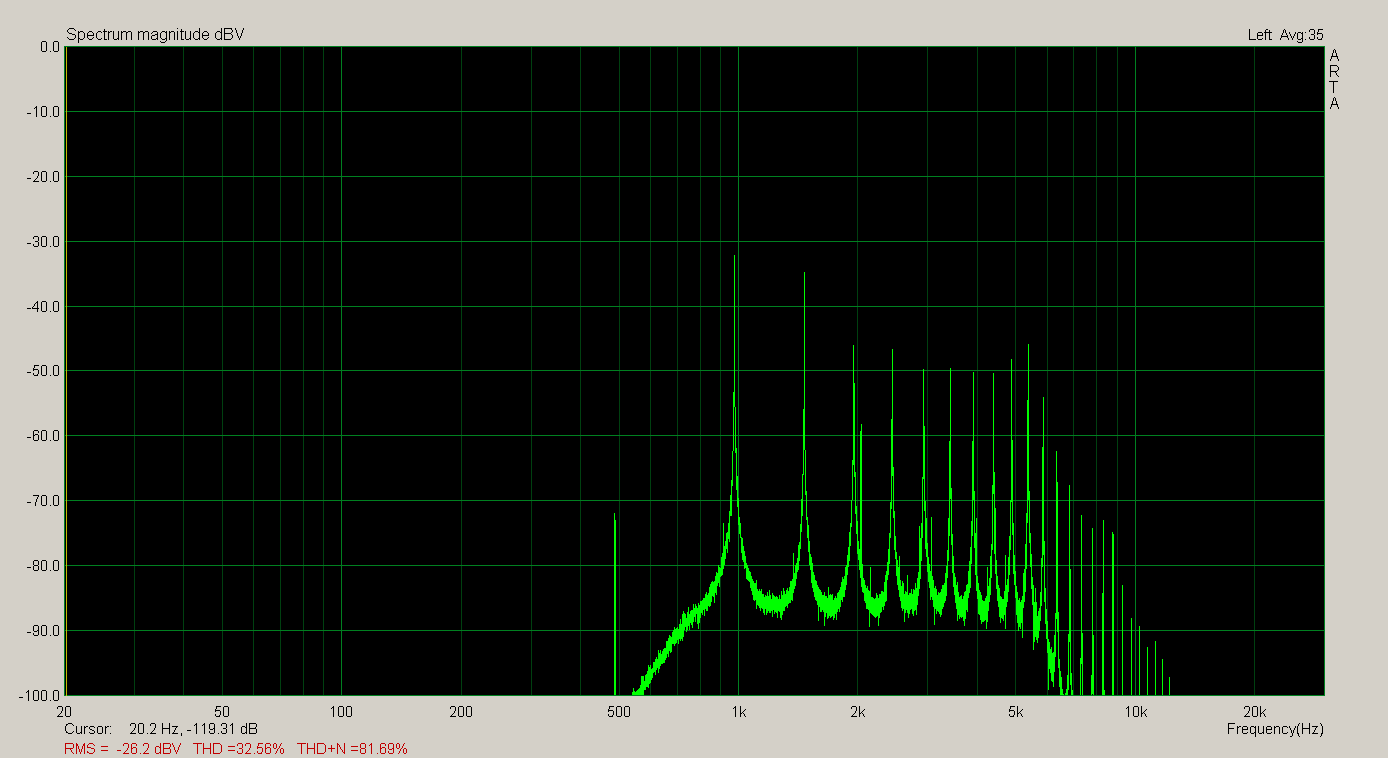

All my efforts this time: 2nd-3rd harmonics are ~ -115-120dBFS @ 0dB signal, with some schematic limitations (SE Input, single polarity power supply).

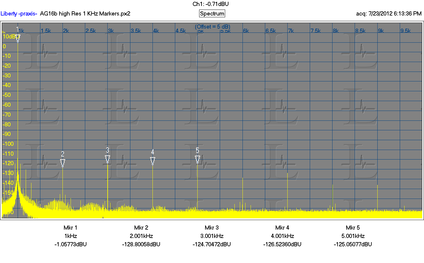

When looking at really low noise and low harmonics the analog chain needs to be optimized for the specific source. Usually that means low impedances at the feedback nodes for low noise. 3 volts works fine with line level devices. The standard full scale output of a DAC is 2V RMS. Attenuating it without either raising the noise floor or loading the device requires a selectable gain amplifier. You do not want to be too close to full scale on the ADC or the distortion increases or too low and the SNR decreases. Typically I see about a 10-15 dB range from -3 to -20 as usable.
Distortion: The very best I have seen from an ADC is harmonics max around -120 dB. And that from the AK5394A in an optimum setup. (attached) To get lower you need an external analog filter.
