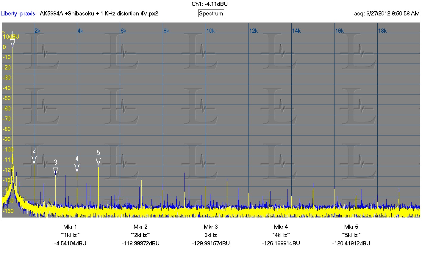

Master clock quality effects
In the attached plot the blue trace is the AK5394A with its on board clock, a gate oscillator. The yellow trace is the exact same setup only with an external high performance 24.576 MHz clock. All of the artifacts are below -120 dB but clearly visible as artifacts above the noise floor.
Very interesting. I'm guessing that the clock still is passing through all the logic bits on the eval board as well.
I wonder how much better this device would work with MCLK (I think...) applied directly to the ADC and the other clocks derived in parallel. Perhaps some delay might be needed to synchronize all of it, but that should be possible. If it matters.

You can review the options on the AKD5394A demo board here: http://www.akm.com/akm/en/file/ev-board-manual/AK5394AVS.pdf I was using it in slave mode (default) at 192 KHz sample rate. If you are using multiple ADC's you will have no choice about using slave mode.
