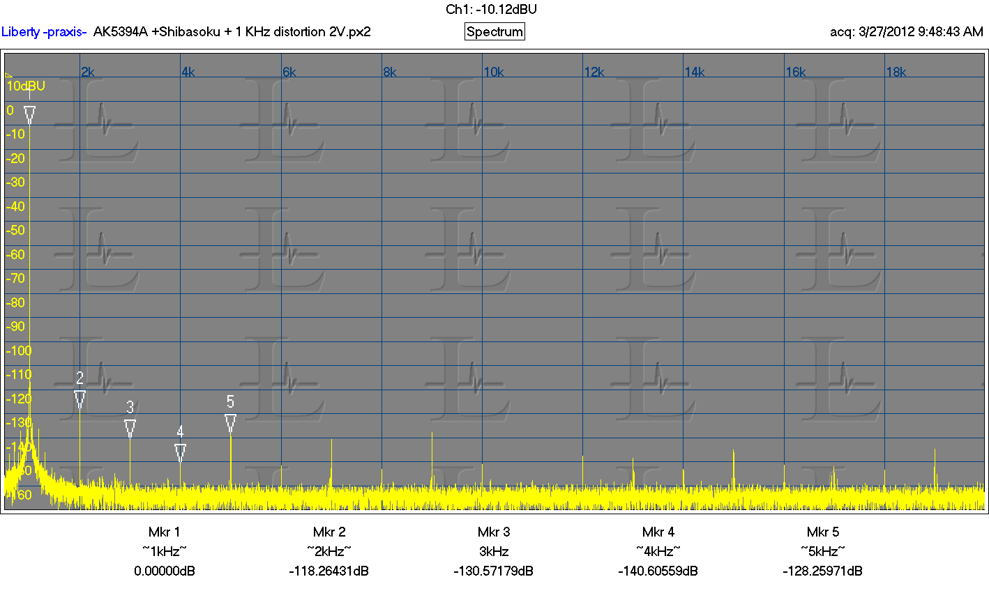

I can help you get the chips. Either is possible. Small trade for getting a PCB done.
There are some potential issues. For measurements the circuit may not conform to audiophile standards. I will check to see if the existing input circuit can be improved on. I'm getting really low distortion now with it as the attached image shows.
Its possible that summing two chips in anti-phase will cancel some of the distortion products. it would need very precision balancing for that to actually work. Makes the project more interesting.
What would you use to interface back upstream? SPDIF/AES or USB? Both are options with really good reasons to use them. USB is actually harder with the grounding problems. The cleanest and possibly most flexible would be a USB to SPDIF interface with a clock sync output and an SPDIF interface AD-DA that would support the clock sync or run standalone.
