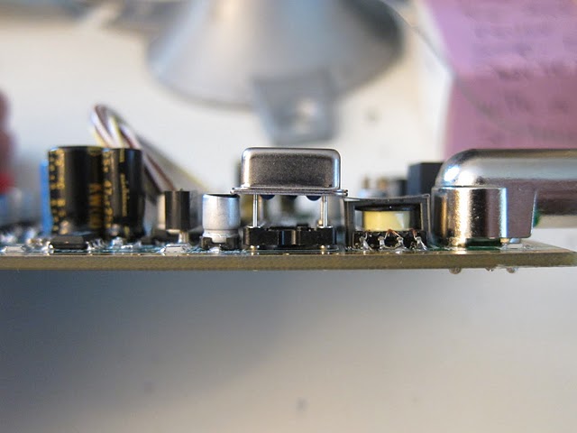

One more thing, I know Frex is busy but perhaps this will help others. The Tent clock doesn't really fit very well. You need to move the 10uF capacitor off-center of its pads, and tilt the clock to avoid an inductor and capacitor. See pictures.
Regardless, the clock will make contact with the metal casing of the input transformer. I'm hoping this is okay, as there is no other way around it that i can see. Anyone know for sure if this is okay?

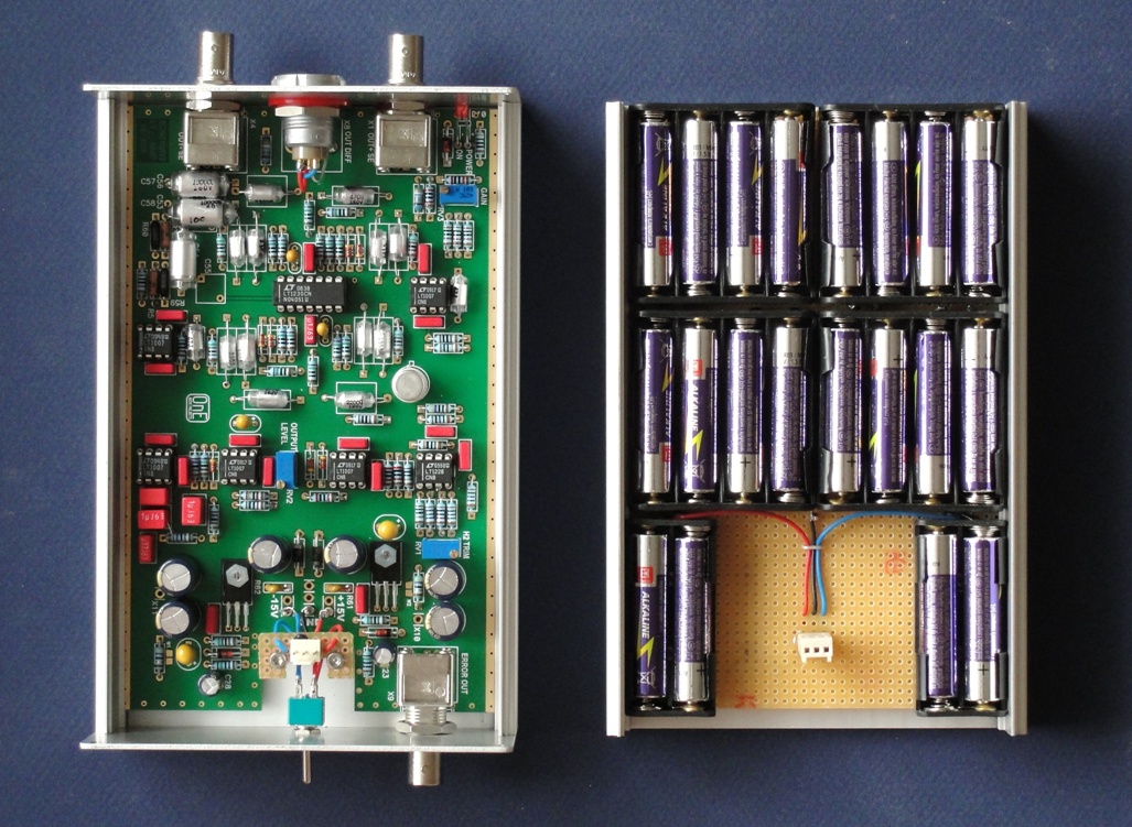

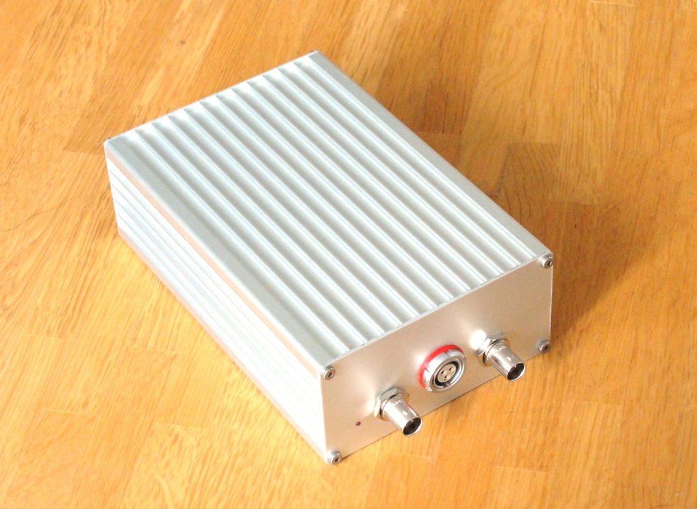

Just finished my oscillator.
Battery powered, Lemo2B for balanced output. Rest is standard.
At the moment -130dB H2 limited by noise floor of spectrum analyser.
Shall measure again in 2 weeks when I have access to an AP.
Thanks for the PCB work,
Patrick

a) The oscillator has pure AC output. My test with lab supply suggested that consumption was equal for positive and negative rail.
b) 20 AAA alkaline batteries cost 3 Euros and will last me for hours. So even if they are discharged unevenly, just replace new.
c) I don't think I'll be switching them on very often.
Too many advantages with batteries IMHO.
Patrick

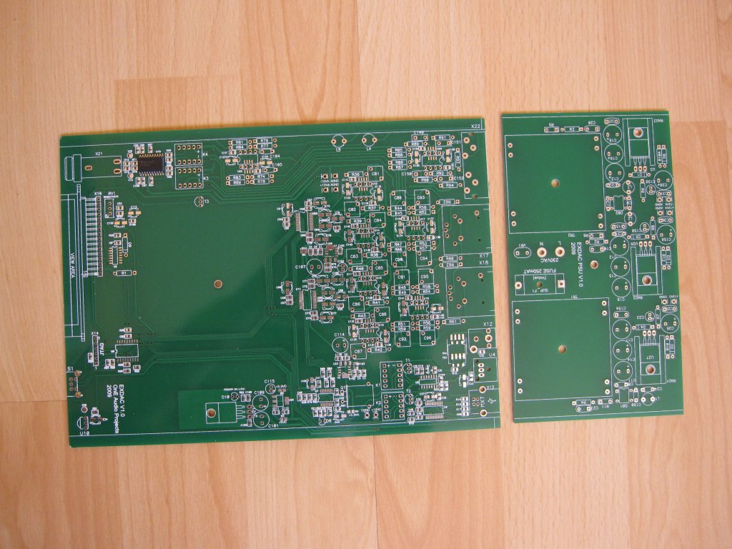

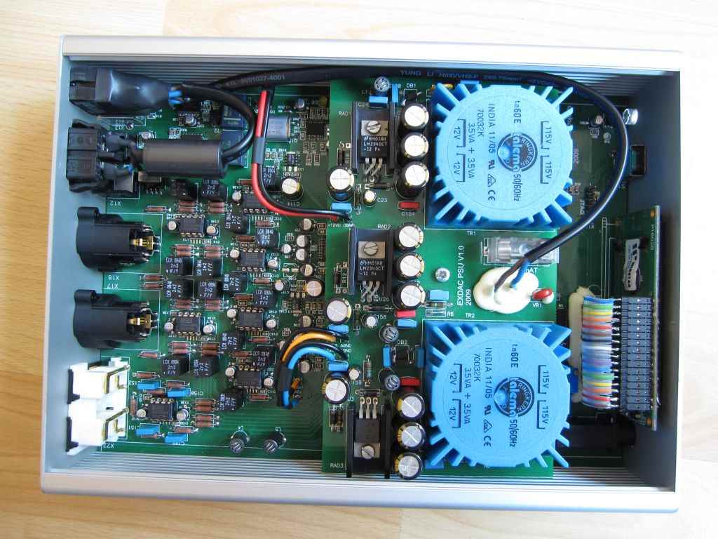

AR2, i already have built two audio DAC , they just has not been described on the forum yet.
Just two pictures for you.
Regards.
Frex
