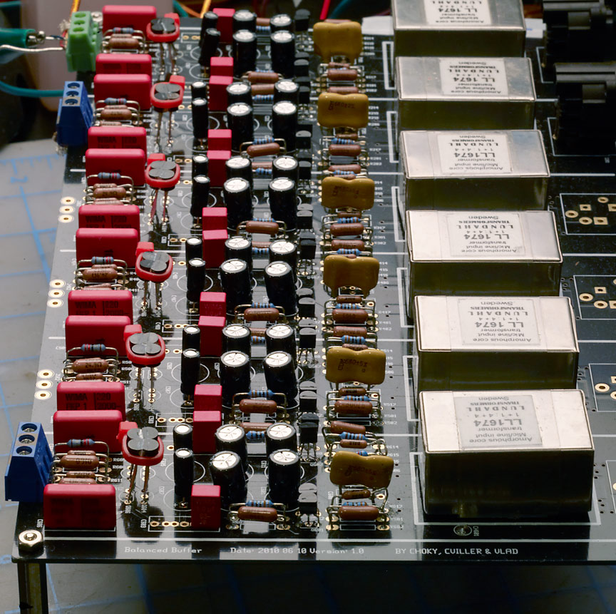

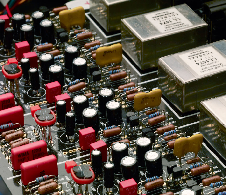

AR2, i already have built two audio DAC , they just has not been described on the forum yet.
Just two pictures for you.
Regards.

Analog ballanced buffered Tx output for 6 of your DACs, he he
