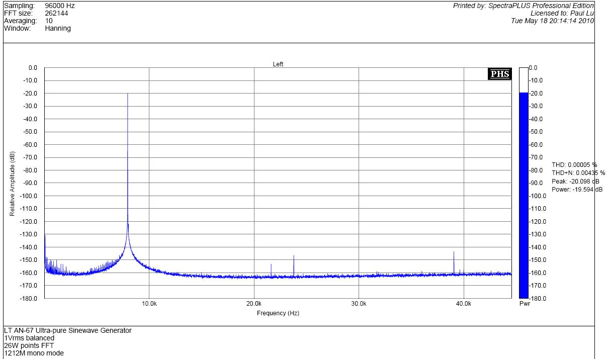

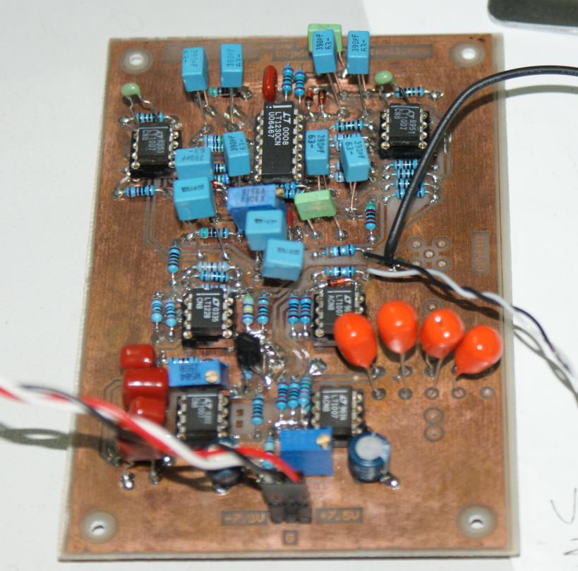

Thanks to Frex's thread
I can't wait to build my own AN-67 generator ^_^
so, it come out after 2 days hard work
I test it with E-MU 1212M, balanced mono mode
It is really an excellent sinewave generator but only the 50Hz noise is not meet my expectation.
It MUST be placed in a steel container - like a cookie tin -- aluminum won't work.
Ordinary steel has its short comings, but should get the 50Hz signal down by 60dB or so. For more attenuation you can use a container within a container.
The oscillator has provision for balanced output -- if using this consider dual shielded twisted pair.
You might want to put 220u/100n on the power leads where they join the PCB -- you'll pick up a lot of 50/60Hz from the power leads.

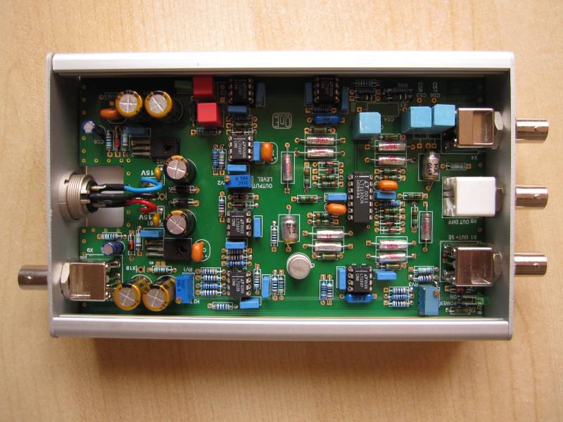

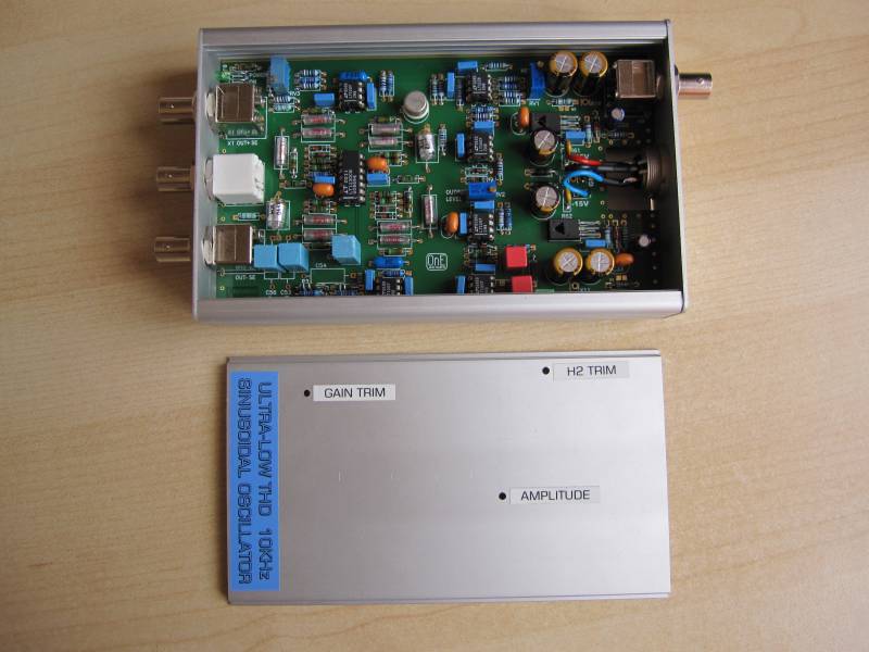

EOSC10KV2 finished.
Hello,
I have finish the wiring and machining my own oscillator.It work very fine !
A little picture of what it look like.
Some measurements will come later .
Frex.
PS: bbp, your job is very cool 🙂 .

Hi Jackinnj, I've sent the PCB file to the manufacture for a better factory made PCB, maybe the PCB will arrive the day after tomorrow.
As I know, you're the first person who made this osillator and post the test result public. I've read your post about 3~4years ago ^_^
I add a XLR connector in that version of PCB, which is not contained in this hand-made PCB
I'm going to use two 7.2V NI-CD batterys as the power supply, the batterys will not cost too much in my local market. Low-noise PSU based on OP-AMP is another good choice, like JSR series.
I don't know the wideband noise will increase or not if a high-pass filter is added following the oscillator, AD797 is a good choice I think.
My ADC in 1212M only performs -113dBFS residual noise @48K sampling rate with the input terminating. So, most of the time, I will use my VCS(Volume Control System) as a authentic-attenuator between the source and ADC. Once I set the attenuation to -20dB,the 50Hz noise and its harmonic freqency noise will be also cut-down 20dB.
compare the two graghic
original,oscillator provides 1Vrms balanced
second,oscillator provides 4Vrms balanced and the VCS attenated to 1Vrms
best regards

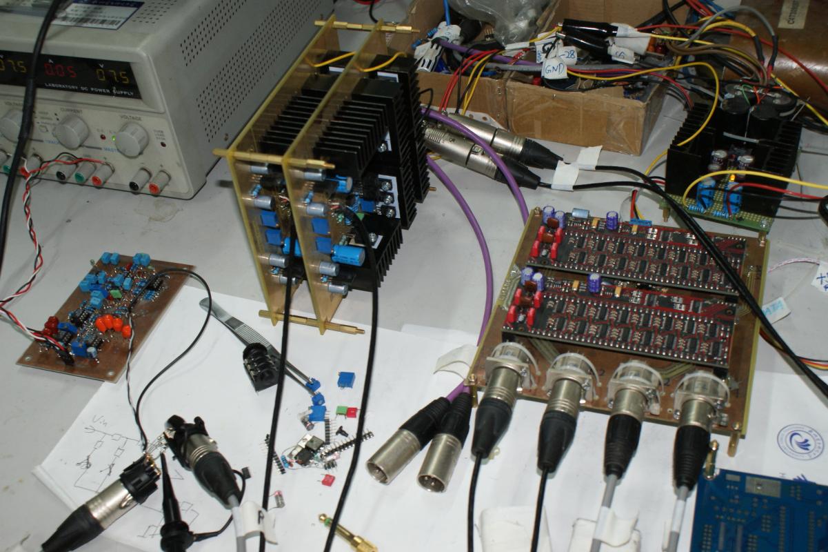

Thanks Frex,
I like your LAYOUT, you did a really great job ^_^
the position of components are reasonable, the axial capacitors look beautiful too
I done another ADC layout for my graduation project too, which is also based on CS5381KZ, maybe 5~6 days I can assembled the ADC and make the measurement.
The ADC part of 1212M is really good, but I want a ADC apart from my PC board ^_^
have a nice day
best regards
Lu
