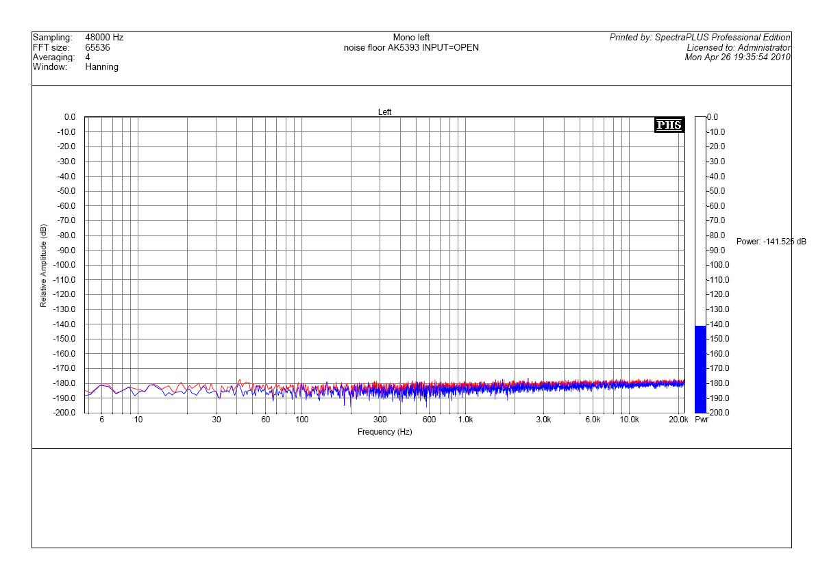

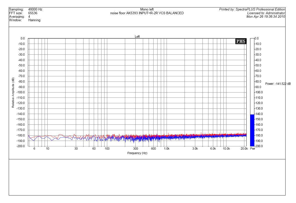

Did I meet something wrong with the setting?
This is the noise floor of ADC AK5393
and this is my R-2R VCS volume contorl module noise floor
they are nearly the same!

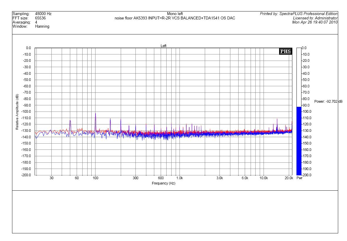

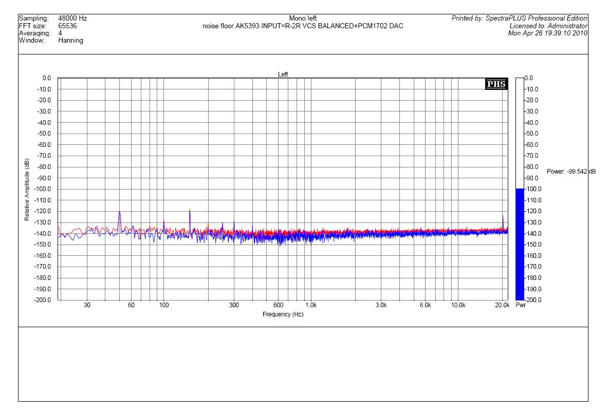

then, I put my PCM1702 DAC to the test system: PCM1702 DAC - R-2R VCS attenuator - AK5393 - SOUNDCARD
I got the noise floor of the DAC:
When I change the DAC to another TDA1541, the result is:
Well, if you measure an open input ADC, you should get some 50Hz pickup at ca. -140dB.
Plot 3 & 4 look ok.

I found that if the input of the ADC reaches about -6dB, the FFT may show overload. I think this is the problem

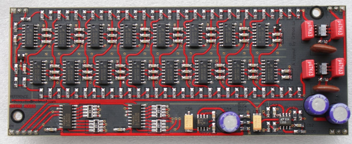

Oscillators pcb arrived!
Hello,
Some news for the group buy of oscillator PCB.
I have receive today PCBs by Fedex.
Again a very good job of pcbcart.
Unfortunatly, i had need to pay little customs fees..![sad :sad: :sad:](https://files.diyaudio.com/forums/images/smilies/sad.gif)
Fortunately, it's only 15.96€ to be divised by the number of board

Each buyers will receive very soon (this week-end) a e-mail with
a zip file wich include all needed files to build the oscillator.
I'll send also a copy of the Fedex invoice for customs.
I hope to ship all circuit-board in the next week, as soon as you
will paid this little extra cost.
