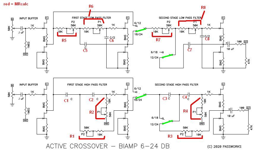

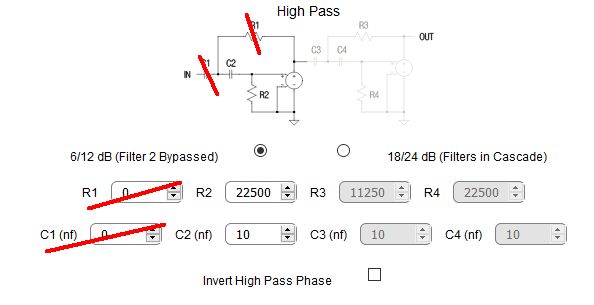

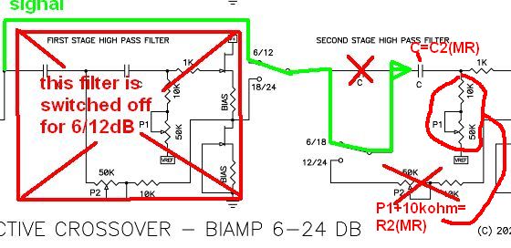

NPass-schematic_24dB -MRcalc in red
I tried to put in the MRcalculator Rs and Cs (in red) into the schematic of Nelson Pass (24dB-slope).
I hope I made no mistake! :confused:
You can throw old vegetables and fruits on me, if.....:rolleyes:
Greets
Dirk :D
I am a bit nervous - how you respond...

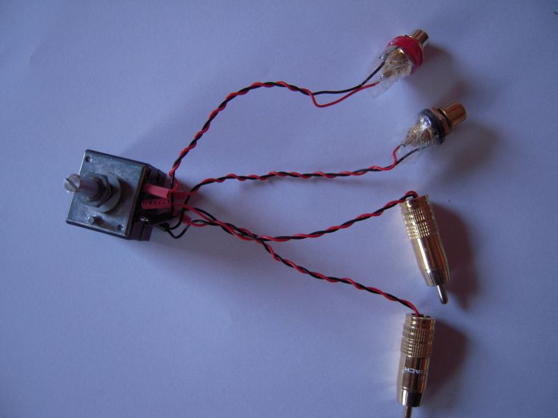

Hello Dirk,
So the take away here is, I'm unlikely to get matching output levels at my speakers using stereo pots. Having fine tuning ability for each H/L pass filter and channel is the goal.
-I have two 2ch amps for this project, a F5T 50wpc, and a F6 25wpc. A M2X will be built at some point.
-My plan was to have a stereo pot for each amp. I will be using flying leads for the RCA connectors so I could wire directly to the pots and then to the input pads. I could then use a 1K to 2K5 trimmer on the the boards in place of the 50K trimmers for initial set-up fine tuning. Or I guess just leave the 50K pots on there.
-Because I have early teen-aged kinder in the house, I was considering using these:
https://www.mouser.com/ProductDetail/Alps-Alpine/RK097122TZ0A/?qs=YMSFtX0bdJB9fHMgys1JOw==
-Yes I could just build it as NP designed, but wheres the fun in that?
Best Regards,
Tbone
to cubicincher
Hi Dirk,
Thanks for the feed back. :D Ya with the kids, the more knobs the more opportunity for them to make "adjustments". It's not like when they were younger and just don't know better. My oldest (13), thinks he's smarter than me half the time. I can hear it now "You said that was the Volume knob", "Which one make more bass?" etc. :stop:
Kids are great, really, but they just have that growing up thing to do.
I think that I'll use those push lock pots mounted in a Hifi2000 chassis with a 10mm front panel. It will be a good deterrent, and look pretty sharp too.
I know that there are better quality pots out there, but for the price and utility I'll give those a go for now.
I think my use of flying leads wasn't correct. The I/O RCA's will be mounted directly to the back panel and connected via wire not to the board. But I like your idea in that pic, that would come in handy for experimenting with different amp combo's.
Best regards
Tbone

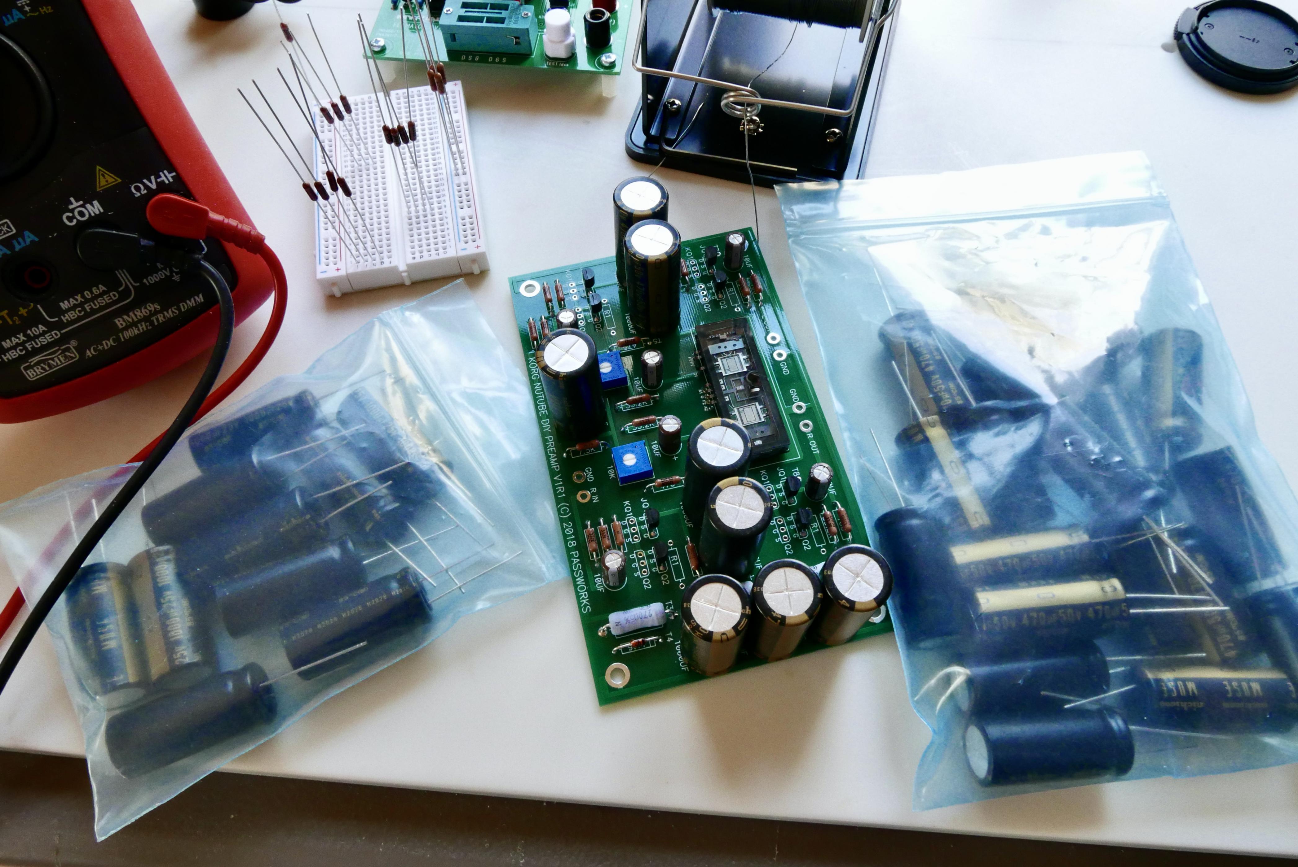

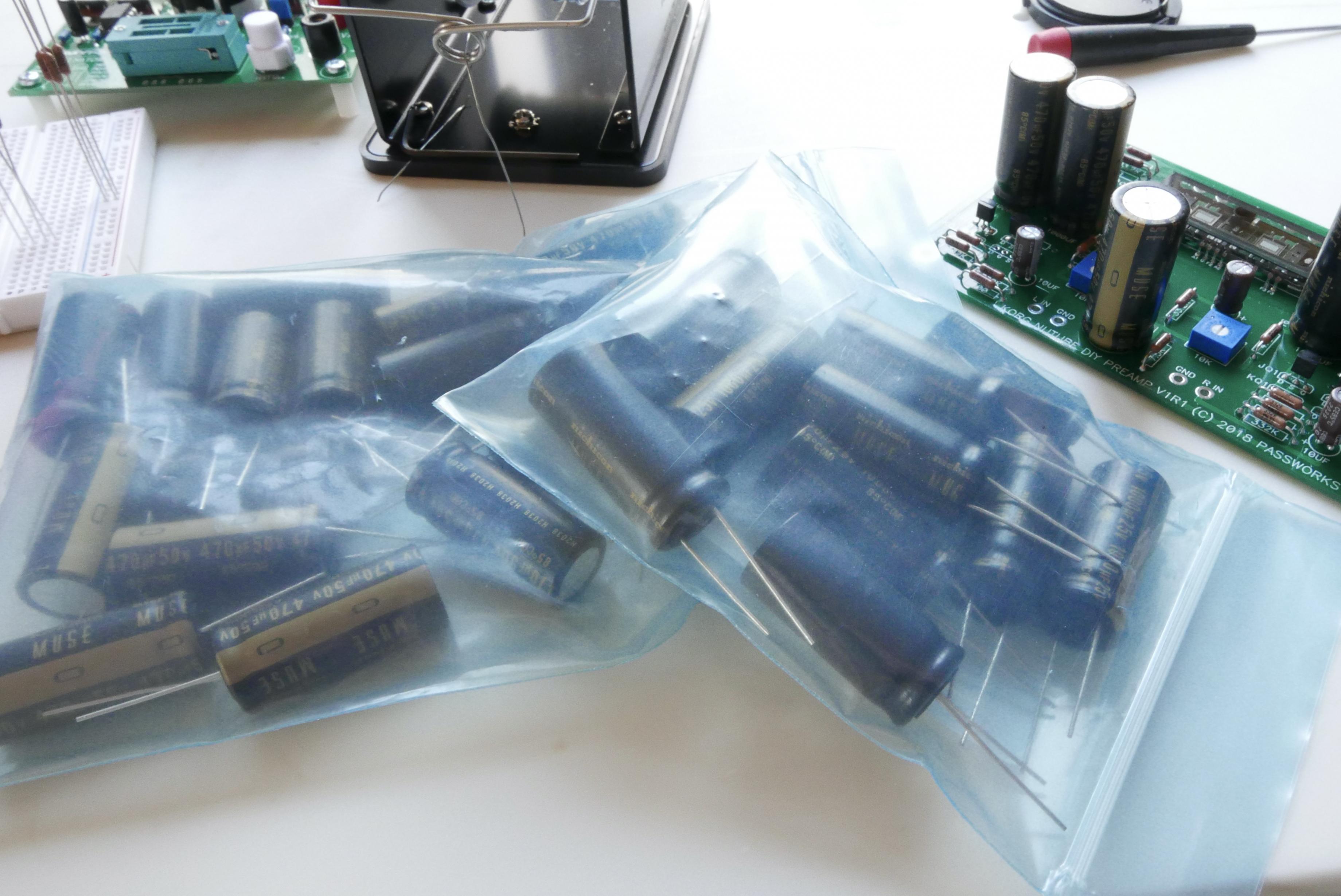

Somewhere around 1:15 AM and I was congratulating myself on quitting for the night… “A mans got to know his limitations”… Clint*
Everything was really right … I still get a kick out of gleefully watching the solder wick its way down the lead wire and into the board … “Goldilocks joint’s” just right nice and shinny.
Only major thing left was to solder in the large caps in the morn and test. Board, #4, was for a skeptic nonbeliever, close friend and upscale $$$ audio store owner so anyways chose decent well proven parts. Interestingly the Nichicon UKZ Premium caps do fit…if barely. Need to adjust the lead space a bit etc. but doable.
Awoke, always nice at my age, got properly caffeinated grabbed the bag off the desk and installed them, all eight of them. Went to put the board away and noticed another bag of caps? … the right ones! 1000UF/25’s…not 470UF/50’s. Wife unit noticed I was pretty quiet for the remainder of the day?

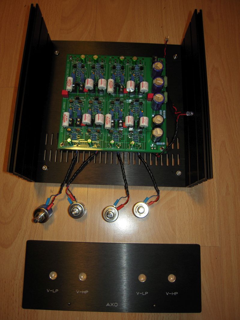

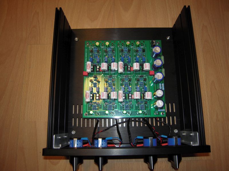

Hello 6-24XO-builders,
today a little progress in my 6-24XO - build for subwoofer:
Got the pcb in the case, LEDs are in contact, volume-pots in the frontplate,....:rolleyes:
I have to CAD the backplate and I have to build the PSU. So, still something to do.
Good night from Dirk:sleep:
