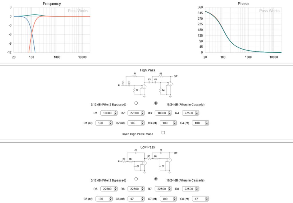

I have chosen 100nF amd 47nF for my 6-24XO-build for subwoofer use.
My target crossover frequency was around 80Hz.
Greets
Dirk

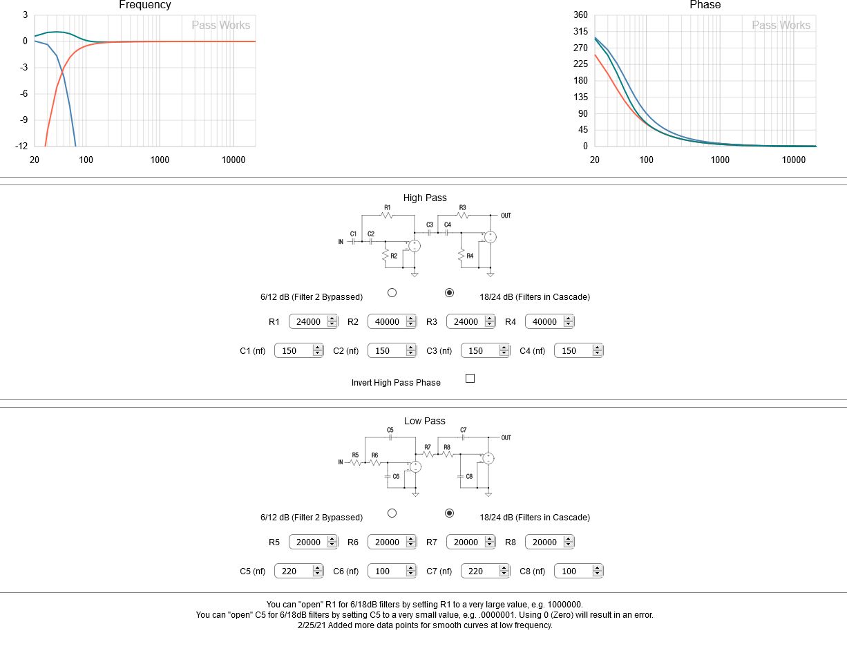

I was playing around with Mike Rothachers simulator for a crossover frequency around 45-50Hz (24db-slope).
I would assume you will need caps between 150nF to 220nF.
This was only a short try. I don't know if this would work in real life!!!
So, don't take that pic of the sim below as a recipe!
And I don't know what speakers you want to drive? What the phase response will do....
You can play with the cap values and the resistor values on your own.

Hi allhifi. Check your math please. I used 6.8nF in a much higher crossover.
7000/45 = 155.556 or 156nF

Hello allhifi,
Signal lost is right, for a crossover frequency around 45-50Hz (do you really need that low crossoverpoint?) I get cap values of 150nF (C/2 could be 68nF).
What slope do you want? 24db/octave?
