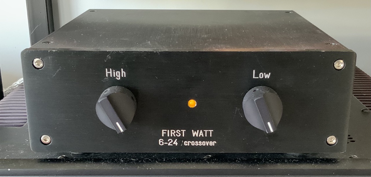

Recently I finished the 6-24 for my bi amp setup, two Adcom GFA-5500 running PureAcoustic Project Trio15 with Voxativ AC1.6. Crossing @420 Hz 6dB/oct. I used only two pots for the input, Precision Electronics 50k 2W.
Wanted to thank Nelson for sharing his idea and ingenuity. It just transformed my setup! No more opamp- based active filters for me.

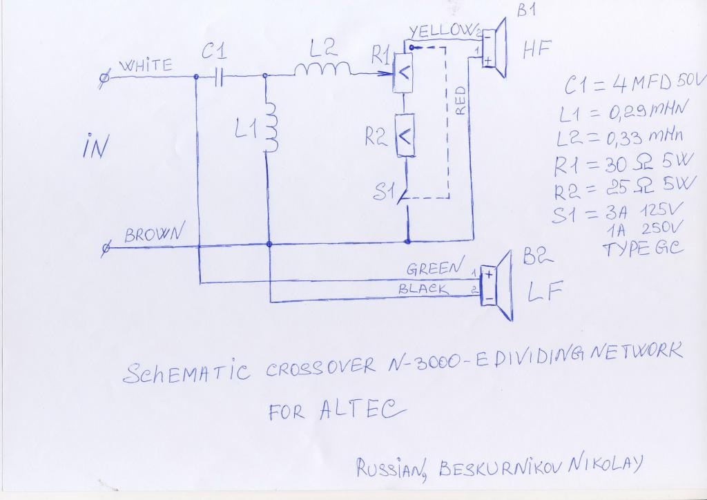

I have just ended to read the entire thread and wondering if this project is suitable for my speakers Altec 601c.
I'm not very clear regarding Tannoy DC... undertand that they are also a kind of coaxial configuration similar to my Altec 601c (duplex).
My idea is to replicate the Altec passive xo at 3khz (schematic in the picture).
Many thanks in advance!!
