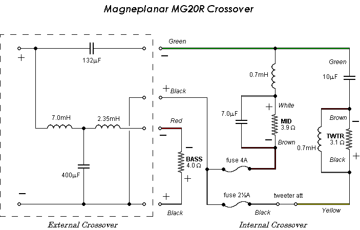

I think the passive crossover is slightly different. If the values given in the schematic are correct, the low pass is about 150 Hz not 108 Hz.
The high pass is just a capacitor and could be done without additional active circuitry. In many cases that high pass cut-off can be made in the power amplifier driving the mid/tweeter, simply by changing the value of one or two capacitors.
Adding a balanced output can be done in several ways but it is not necessary in most cases, certainly not if you have short interconnect cables. If the power amplifier have differential inputs, the component driving it do not need to have differential/balanced outputs. Balanced output means the impedance of the positive and negative pins/connections are balanced. You will need a resistor and a capacitor for that. You need to measure the output impedance of the last bufferstage of the crossover.
Could you suggest a way to do this?
From the manual "output impedance is about 250 ohms". As that include a resistor of 100 Ohms, the circuitry itself should be about 150 Ohms. The hot and cold impedances should be as close as possible for good rejection of disturbances, maybe within 1%. I have measured the output impedance of some microphones with a guide from Jensen Transformers but I do not remember the procedure right now.

I have the MG20 not the MG20.1 and you are right I could just use a cap for the high pass. I'm using a Sonic Frontiers Line 3 pre amp. The unbalanced output on the preamp are going to my Subs and the balance output are going to go to the speaker amps. I don't have the passive crossover for these speakers. That is why I need balance for these speaker. I would need two 132uf cap that would cost about the same as to build this active crossover and the inductors and cap for the low 18db slope would cost more also. My amp to drive the MG are Classe CA2300 for the bass and Classe CA 300 for the mid/tweeter.
The 108 crossover is for the the MG 20.1 and you are right the crossover for the MG 20 is about 150.
Nelson mentioned a figure of 75 ohms as the output impedance of the jet. So I used a 175 ohm resistor. Not sure about adding a capacitor. I did not.

Thanks I have the MG20 not the MG20.1. I just wanted to know what the MG20 suggest for crossover points for the active crossover, and what are the crossover points and slopes. I have the MG20.1 manual and was going off what it says.
Magnepan do not publish the schematic of the crossover anymore. If the schematic above is correct, something like 280 Hz as there must be some series resistance in the coil before the driver. It is not really a must to use an active circuitry for that first order slope, a simple capacitor ahead of the power amplifier driving the mid/tweeter will do. The signal path within the Pass 6-24 includes a couple electrolytics and active devices that may add some "signature" of its own to the sound. At least they make the path longer and some of us want to reduce it to a minimum. It should be noticed that the removal of the passive external crossover of the MG 20, will increase the bass level a bit when an active crossover is used. How much depends on the series resistance of the large coils.
