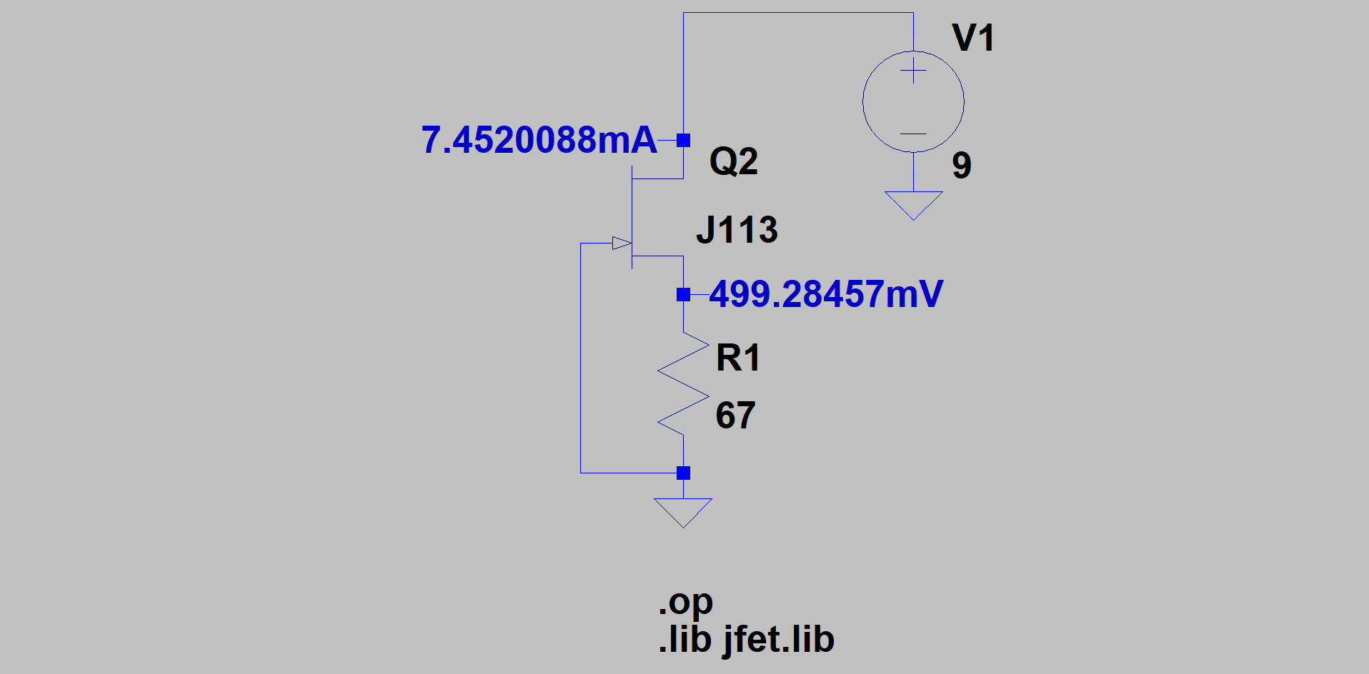

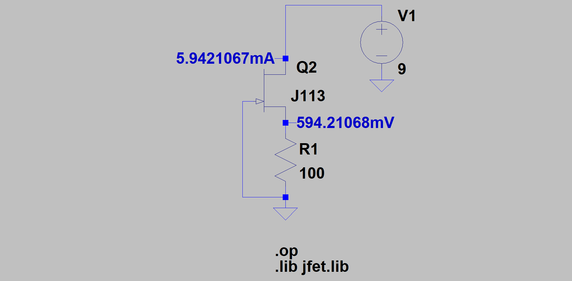

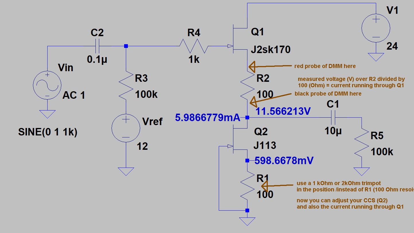

I still don’t know how to set it, but I can guess:
Let’s say I find out that it takes a 50ohm resistor to set a J113 with 30mA Idss to had similar Idss as a LSK170 that measured 15mA when I test it in my 9volt test rig with a 100ohm resistor on Source and Gate.
Then I put the 50ohm resistor as bias for J113 at Q2. lSK170 at Q1 gets 0 ohm (a wire) as its bias resistor, because NP told me so. Is this an okay example?
It might even work with Ohm’s Law! This feels so wrong…
V = IR
VJ113 = 30mA x 50ohm = 1.5V
VLSK170= 15mA x 100ohm =1.5V

And in this example, can I do that with a 67 ohm resistor for the J113? It came with a 100ohm resistor in the kit. I measured the J113 to have a 30mA Idss in my 9V, 100ohm resistor test rig.You wrote:

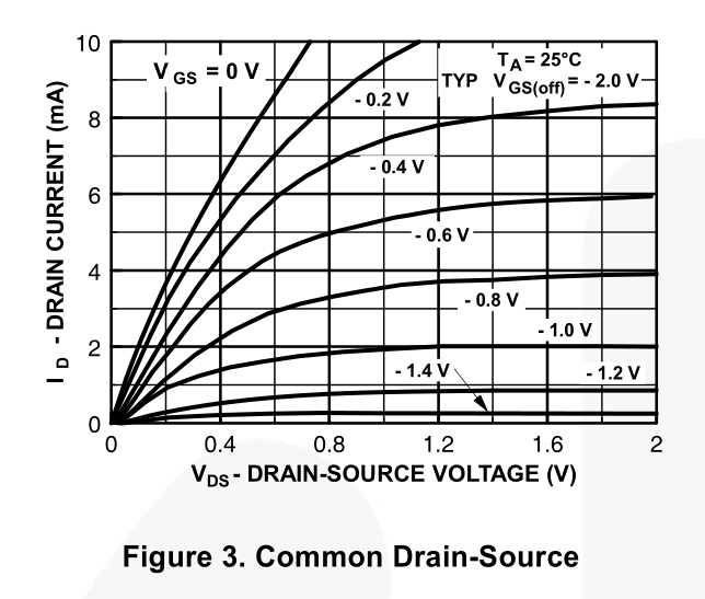

Try to set J113 CCS with this method lower current than "upper" K170 IDSS:
J113 datasheet

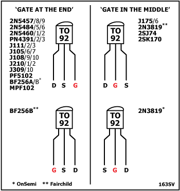

Be sure, that pinout is OK:

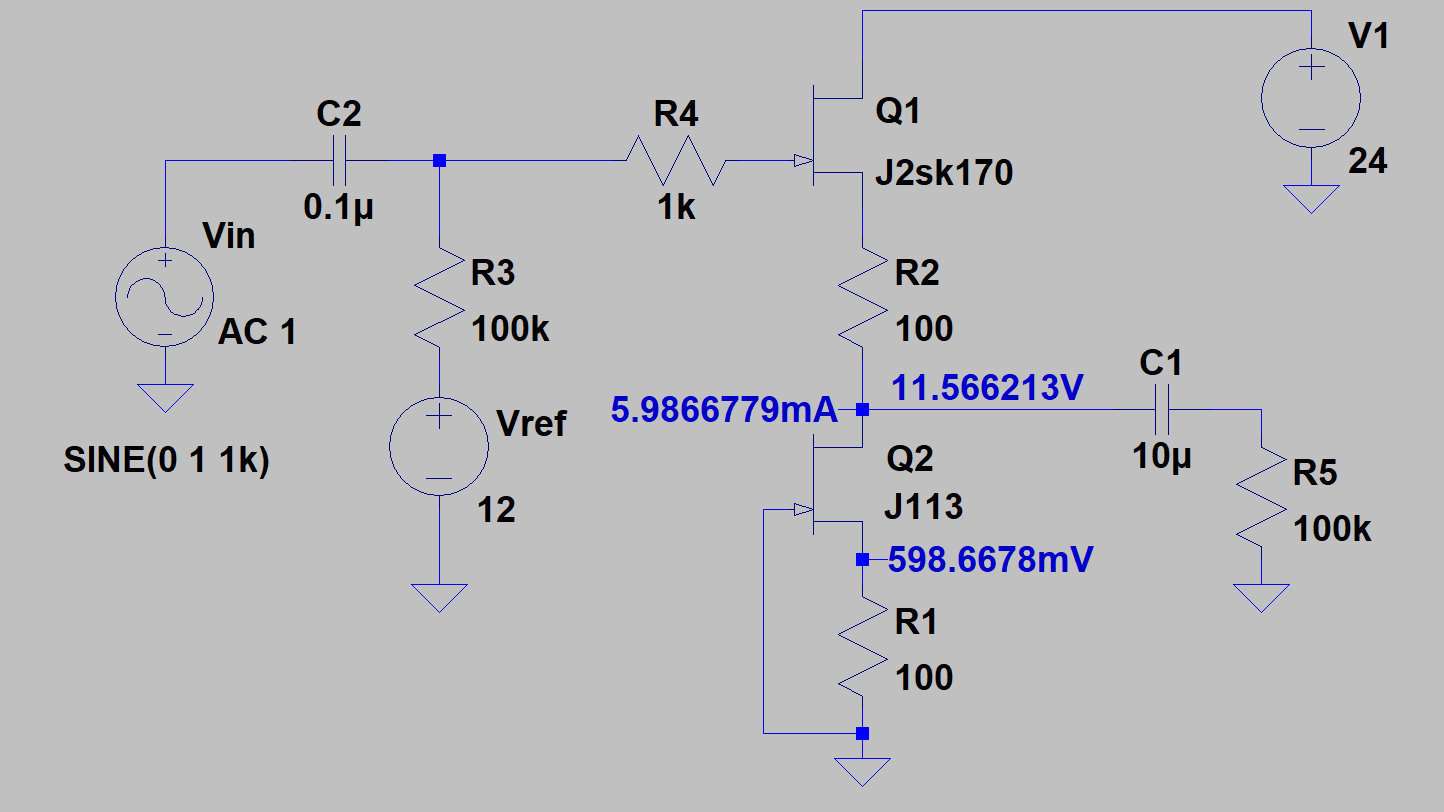

PM sentSo I will just solder a wire in place of the bias resistor closest to 1K resistor in the input buffer, and put a LSK170 in place of the J113 at W1 at the input buffer. Which Idss should the LSK170 at Q1 in the input buffer have? Pick any value, I have 4-27mA.
This I don’t understand:
«and leave Q2 as a J113, but set it's bias resistor so that Q2 runs approximately at the Idss of Q1 or a bit less.» - NP
Should I take the 30-31.5mA J113 and LSK170JFETs and use my JFET test rig?:
+9V battery to Drain
-9V battery to 100ohm resistor
read Idss on both wires coming out of the resistor.
And then change the 100ohm resistor in the test rig to 150ohm, 200ohm, etc, until it matches the Idss of what I measured the LSK170 to be with a 9 volt and a 100ohm resistor yesterday? And then use this resistor, maybe 200ohm, in the 6-24 crossover as the BIAS resistor for the J113 in Q2?

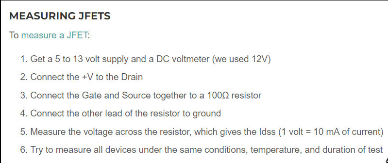

I measured my J113 and LSK170 JFETS included in the kit. With a new +9 volt battery connected to Drain, and "Gate + Source" connected to a 100ohm resistor. These are my results when I measured across the resistor:
From Kit: J113 measured very nice between 30-31.5mA with 100 ohm included BIAS resistor. "NP, get a hobby."
My sixteen LSK170 [mA]: 27.4, 26.5, 25.8, 24.8, 24.6, 18.0, 17.7, 15.85, 9.72 9.26, 9.22, 9.20, 8.45, 7.90, 7.74, 7.71, 7.57, 7.18, 6.8, 6.42, 6.21, 5.81, 5.78, 5.69.

Not sure what to do now. Do I place all the J113 and start the circuit, and measure the mA over a BIAS resistor (which of them?), then calculate R=V/I, since I now know both mA and Voltage (do I)?

Exact IDSS of the LSK’s is less important, as long as you keep bias at or a tad bit lower by adjusting the current through Q2.
this either involves experimenting in circuit, or making a copy of the biasing circuit on a breadoard, or soldering in socket pins to swap resistors until you get a match.
For example, if you choose LSK’s with IDSS of 9mA, set bias to 8,5mA or so through Q2. This involves first pairing LSK’s, then jumpering their bias resistors. Then you need to select a bias resistor for Q2 that keeps the current at or around 8,5mA.

In this case (measured CCS current) you must use more than 7mA IDSS K170.

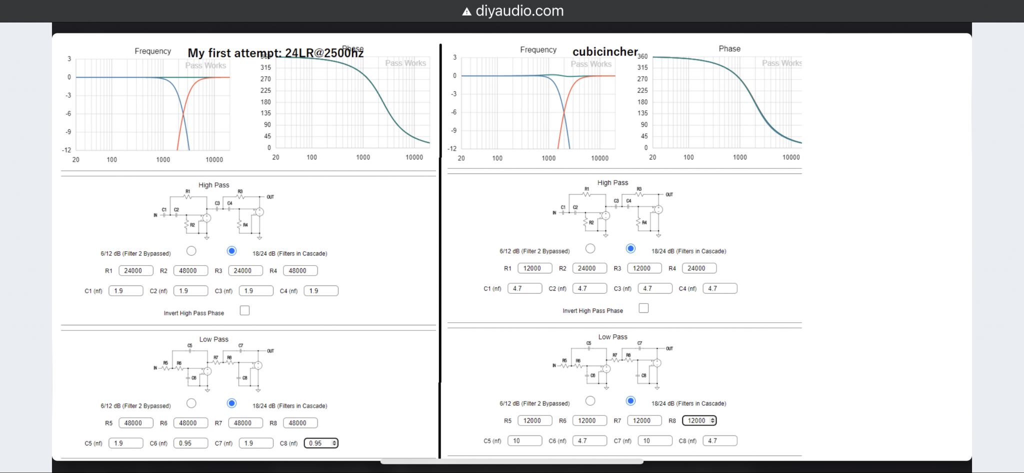

1. R-C filters
How come I see so many variations of the same thing? Sometimes C is equal for both Lo and Hi pass, and sometimes Lo pass is double, but it just works.
I guess one limiting factor is availability of nanofarad capacitors, and this requires some creativity. At least refer me to good a book to teach me about how to program the calculator.

1. R-C filters

post1155:
1:
you have to choose an available value of capacitors (in nF) and then you adjust the R (resistor) to get the desired crossoverfrequency in a R-C-filter.
2:
You choose how steep your slope shall be - 6dB attenuation per octave or 12dB attenuation per octave, 18dB, 24dB,...
3: you can also count your amount of turns for the trimpots. Adjust the trimpots for the left and right channel
(in the same filter) to the same amount of turns.
But how do you know the resistance of your trimpot? And don't forget to add the fixed resistor value before the pot. How will you adjust the trimpot to your resistance from the simulation in Mike Rothachers simulator?
Only some thoughts.
Cheers
