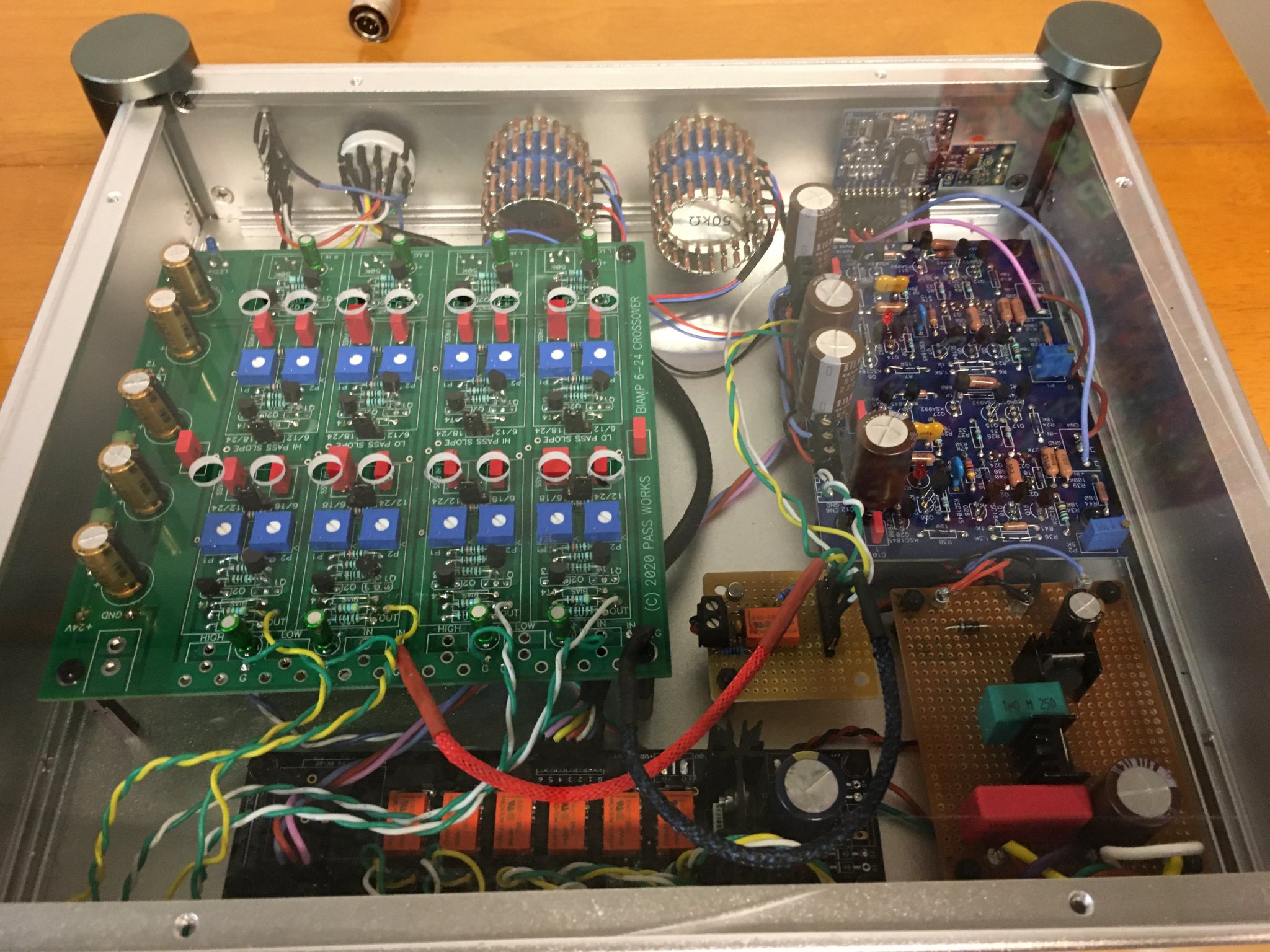

This does not look too complicated. I can pick four LSK170 with 8.5-9.5mA Idss and then adjust the 2K trimpot in place of R1 in this image from zero ohm up to whatever value that it needs to show 800mV across R2 in this image.
But this is on the PCB, right? Otherwise I have to build a copy of the pcb and hope everything turns out identical.

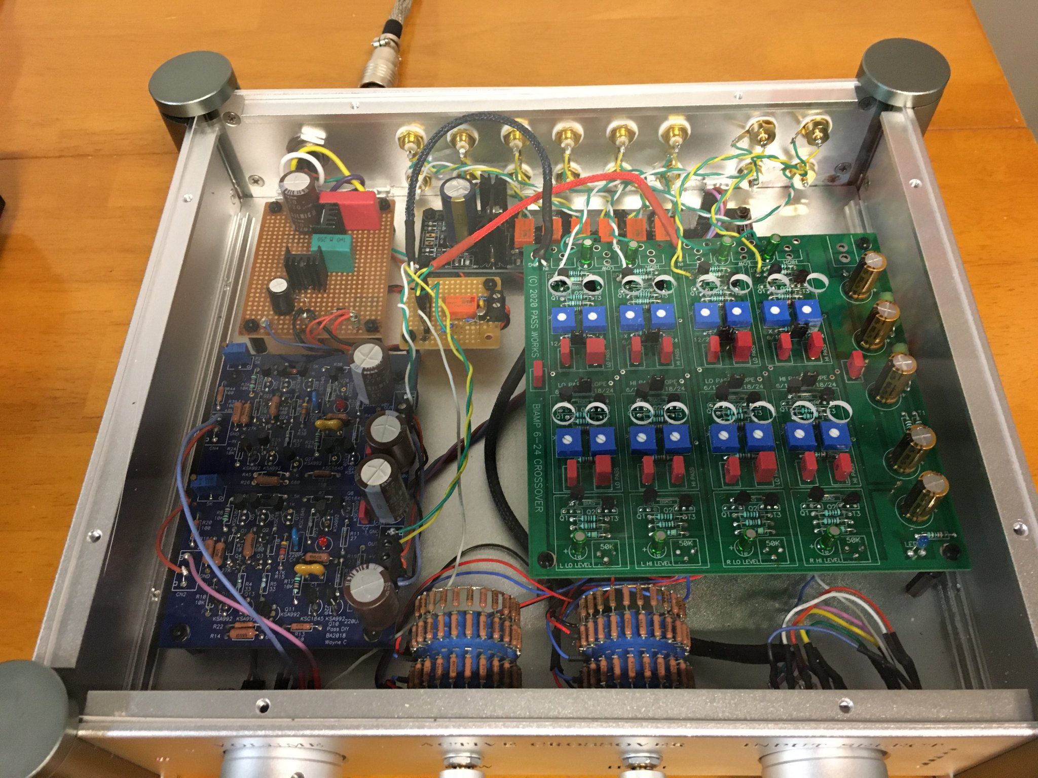

I built my 6 -24 XO using 2SK170bl parts for the buffers, I used a jumper for the "bias" resistors and used matched pairs for left and right channels (thanks to cubicincher's excellent advise). Selecting the JFETS was easy, I used JFETS greater than 9mA because of what Nelson stated in the article:I have three PCBs, so maybe I will experiment with Toshiba parts on the last one
The Jfets are J113 and we want them operating at about 8 mA current in the buffers. The
ones in the kit are selected along with Source resistors to give this with a matched
characteristic.
Since I bought the kit and used the J113's and resistors as CCS, Nelson already selected the CCS parts to give 8mA of current to the buffers. In Nelson I trust, so I just used 2SK170bl at 9mA and above. The hardest part of the build was soldering the 170's because the pin out is different, they look like the line dancers at Radio City Music Hall.
Did you do this for all Q1 on the board or just the four on the input buffer? Any photos?I built my 6 -24 XO using 2SK170bl parts for the buffers, I used a jumper for the "bias" resistors and used matched pairs for left and right channels (thanks to cubicincher's excellent advise). Selecting the JFETS was easy, I used JFETS greater than 9mA because of what Nelson stated in the article:
characteristic.
From what I gathered, it is more complicated than to just use LSK170BL at 9mA at Q1 in the input buffer. The resistor for LSK170 can be jumpered, but the tricky part is to choose a resistor for the source of the J113 on Q2.

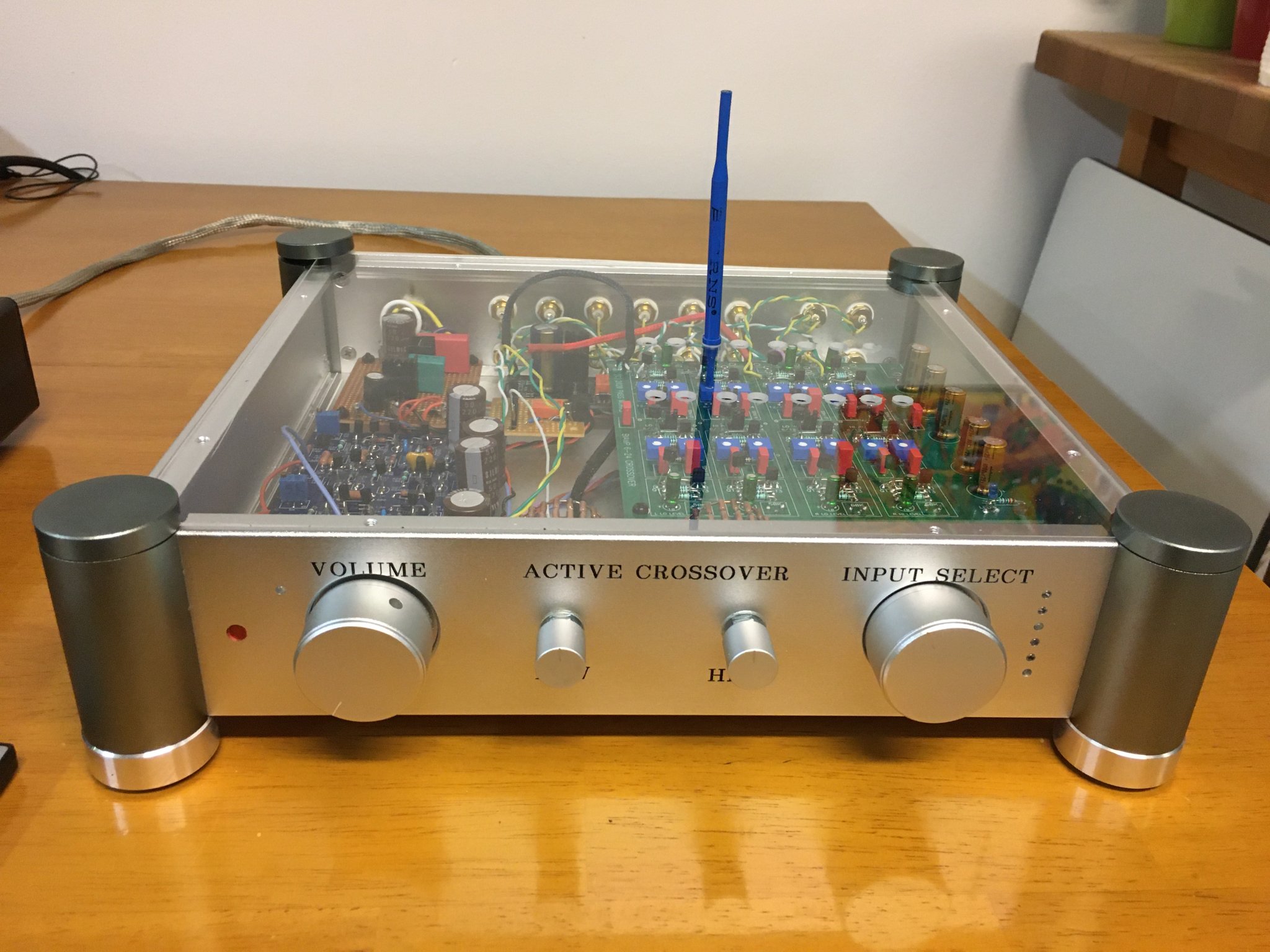

Yes, I selected 150Hz as the crossover point for the SLOB speakers I built. It's an integrated preamp using the BA2018 line stage and a separate power supply enclosure. The clear plexiglass cover is temporary until I have the pots adjusted to my liking.Did you do this for all Q1 on the board or just the input buffer? Any photos?
Nice, I am hoping to get a similar crossoverpoint if only I can lod my lowest horn that deep. What caps and resistor values did you choose?Yes, I selected 150Hz as the crossover point for the SLOB speakers I built. It's an integrated preamp using the BA2018 line stage and a separate power supply enclosure. The clear plexiglass cover is temporary until I have the pots adjusted to my liking.
You changed only four Q1 to LSK170BL?
No, I changed all of Q1's to 2SK170's, I used the Toshiba parts. I used the calculator in Nelson's article to determine cap and resistor values. I'll have to look and see what the values were, I remember having trouble finding the caps Nelson recommended in the BOM for the values I needed.You changed only four Q1 to LSK170BL?
Ok, just curious as we have the same almost. I should probbaly use 180Hz.No, I changed all of Q1's to 2SK170's, I used the Toshiba parts. I used the calculator in Nelson's article to determine cap and resistor values. I'll have to look and see what the values were, I remember having trouble finding the caps Nelson recommended in the BOM for the values I needed.

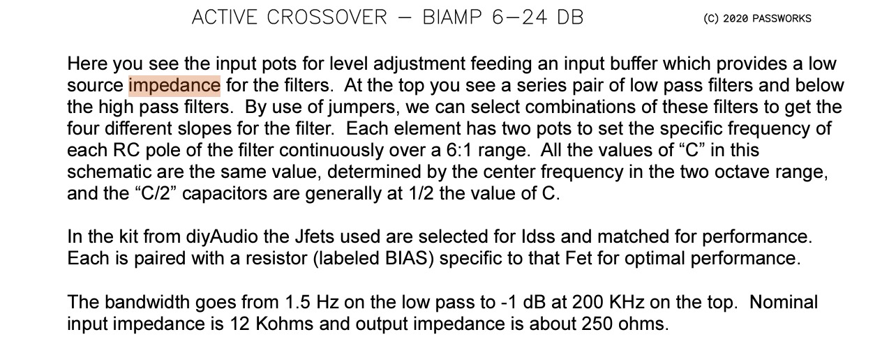

The way I understand the circuit is the buffers set the impedance, from the article: "input impedance is 12 Kohms and output impedance is about 250 ohms"constant impedance set by the crossover itself?
With all those buffers I hope even that is not necessary. I hope it is plug and play with most DACs and amplifiers., Indeed!
Hopefully it's as simple as measuring the input impedance of the device you are feeding!
