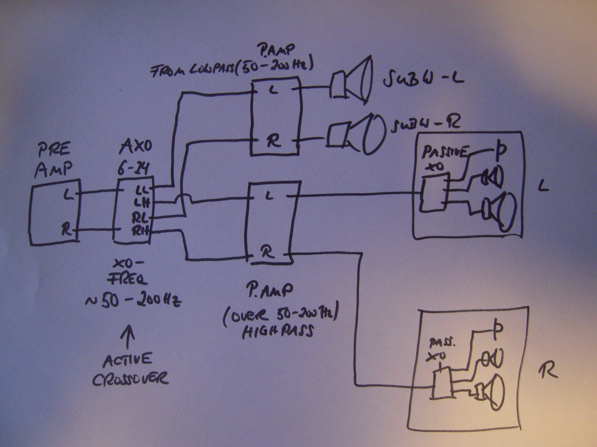

Hello rewind,
as Joel Wesseling describes it in words - a simple possible schematic...
This is a mixed variant of active and passive crossover. You will find this in most AV-/ surroundsystems. Subwoofer / bass over active crossover,
the satellite-speakers use passive crossovers (if multi-way-speakers).
Cheers
Dirk

I was hoping for a good suggestion how to get one extra subwoofer channel that I never thought of. What is described is how I also plan to add a tweeter.Hello rewind,

Mine is a 3way ported speaker with 2 bass woofer in parallel. The 2way active portion is Low pass to woofers(2-300hz) and high pass to the mid/tweeter portion where the mid receives passive low pass and tweeter receives passive high pass. Effectively a small 2way passive with a 6-24 for active between the woofers and the 2way passive.
I have a plan for passive 3way crossed actively to subs as shown in the diagram by cubicincher. For this system a lower box volume single woofer 3way that is ported. I ordered metal port seals(disks) that are powder coated for blocking the ports, then the passive 3way becomes a sealed cabinet with a more damped sealed alignment. Then its ready for sub integration with a 6-24xo.
