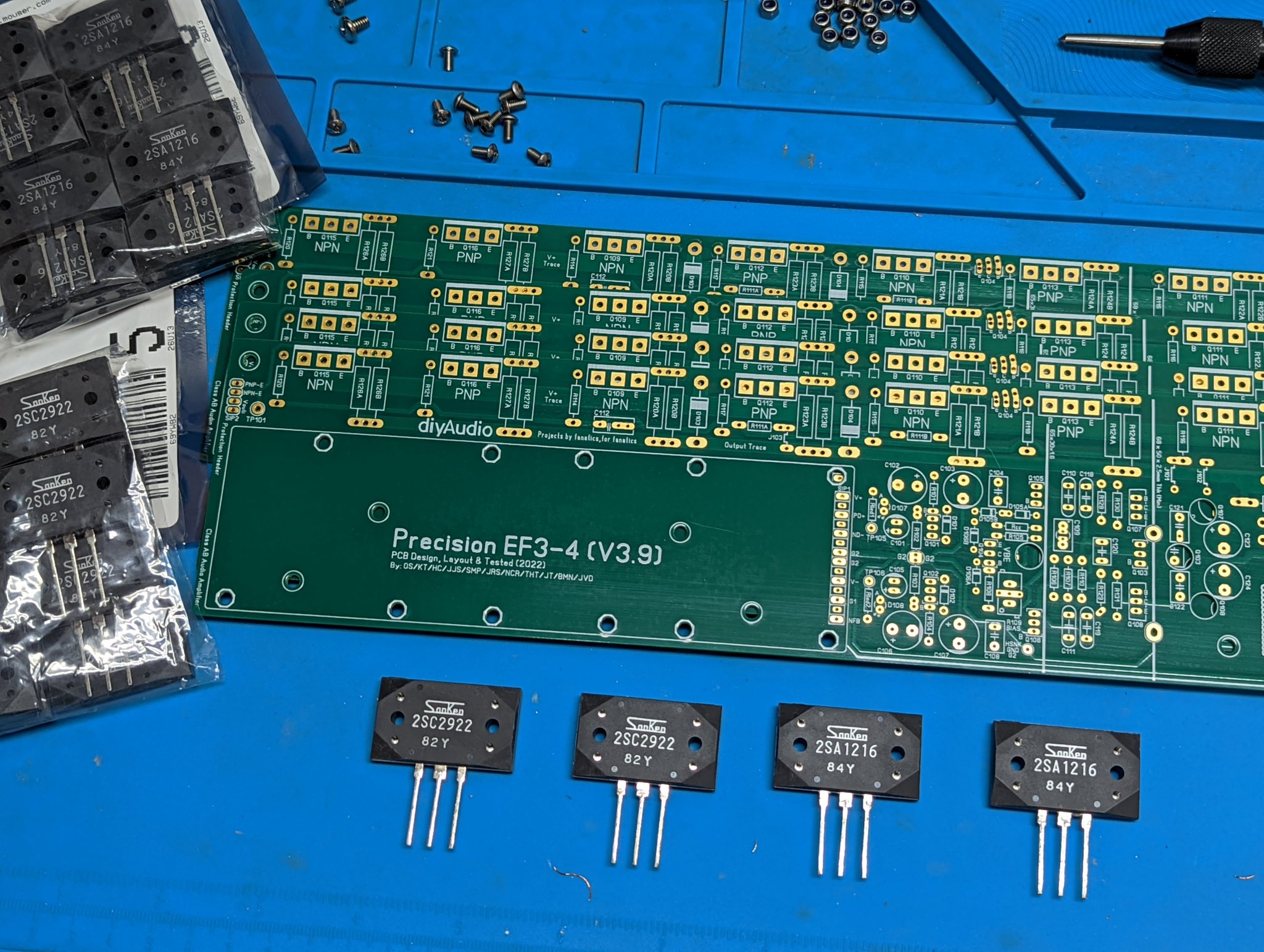

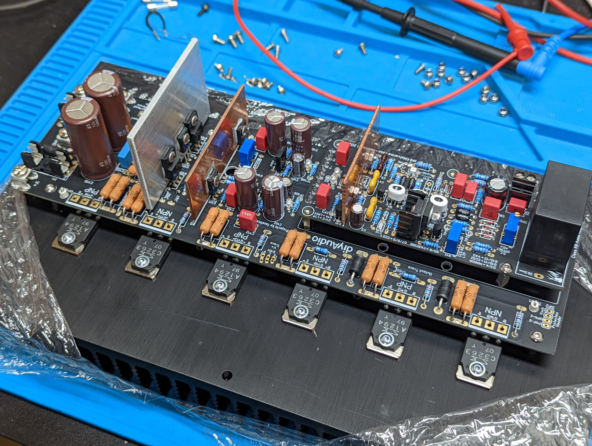

So all 6 boards passed testing with no output transistors. Now on to the next step.

I showed my wife your photo of 6 boards to let her know how lucky she is that I am only building 2. Her response "he must be single....and don't get any ideas!"6 Channels complete and ready for testing! Man that was A LOT of soldering!!!
LOL!!!
LMAO!! Yes this is why I go overboard, to make it easier on the rest of you!! Just kidding, I am not single, just lucky I guess.I showed my wife your photo of 6 boards to let her know how lucky she is that I am only building 2. Her response "he must be single....and don't get any ideas!"

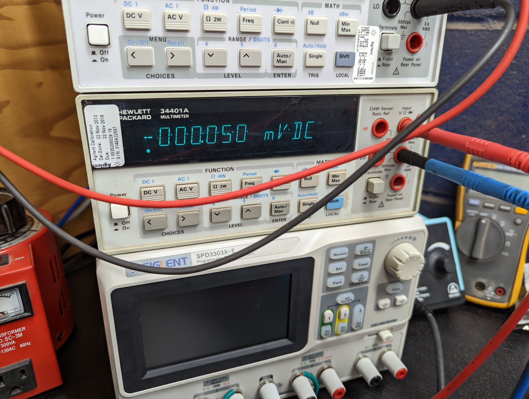

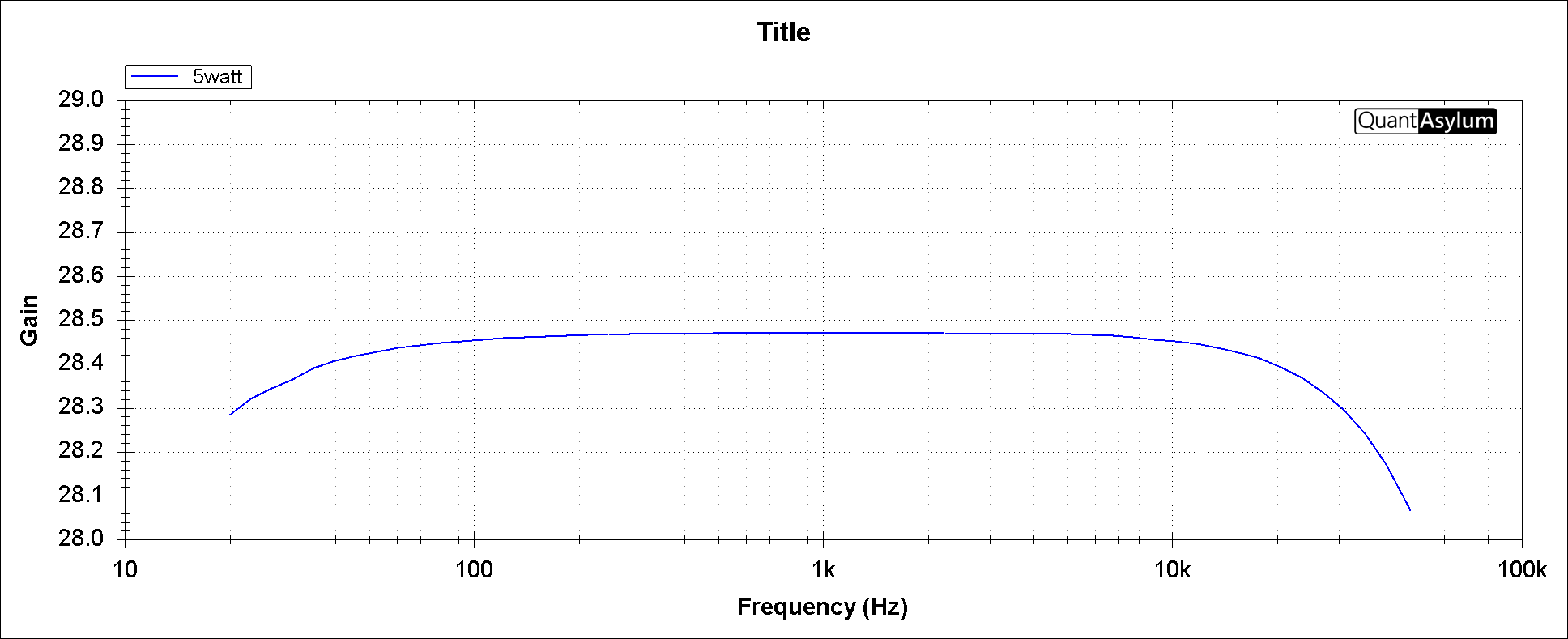

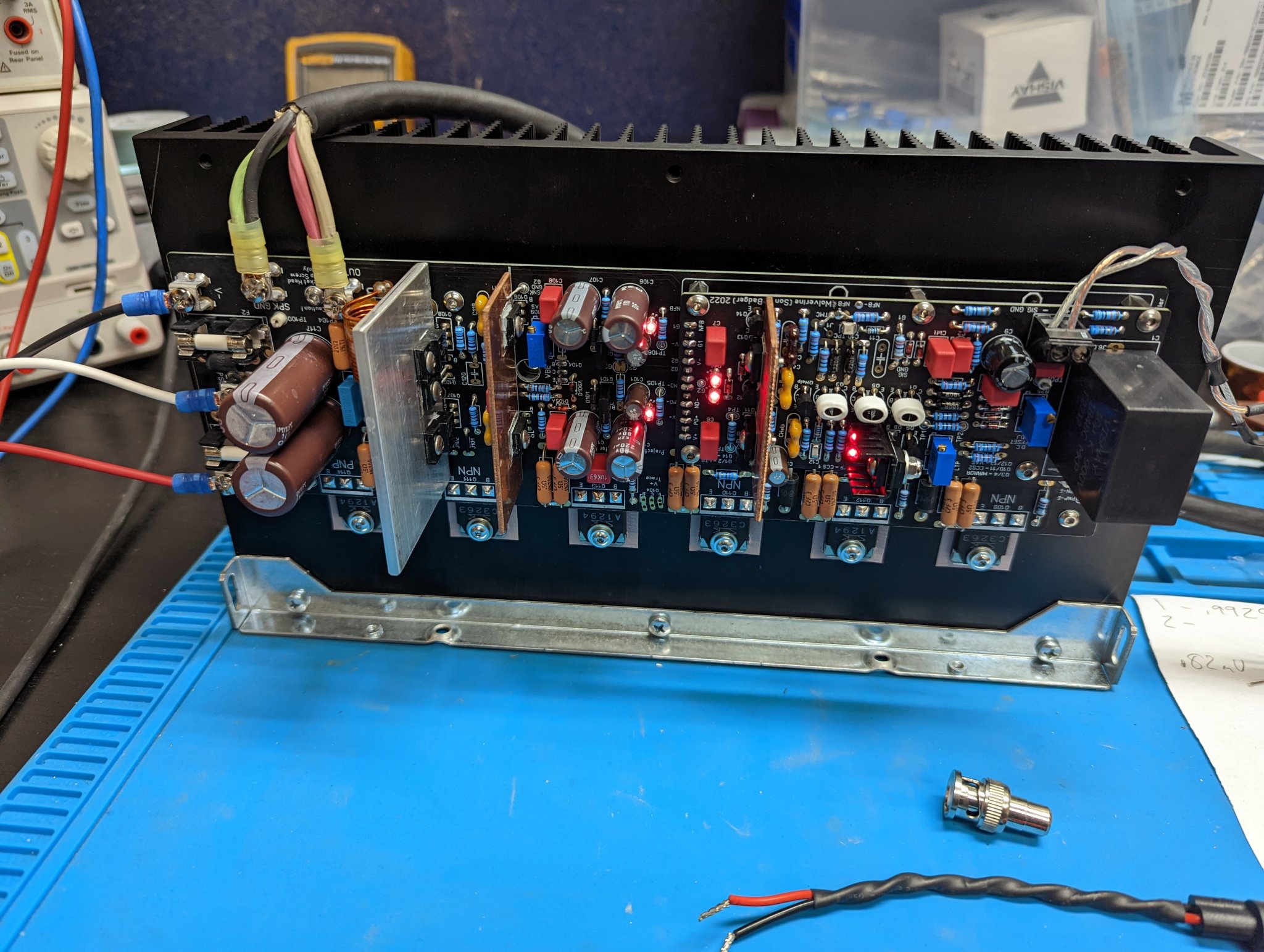

So here are measurements of my first completed board.
WOW!!!!!!!!!!!!!!!
DC offset - basically 0 and stable
WOW!!!!!!!!!!!!!!!

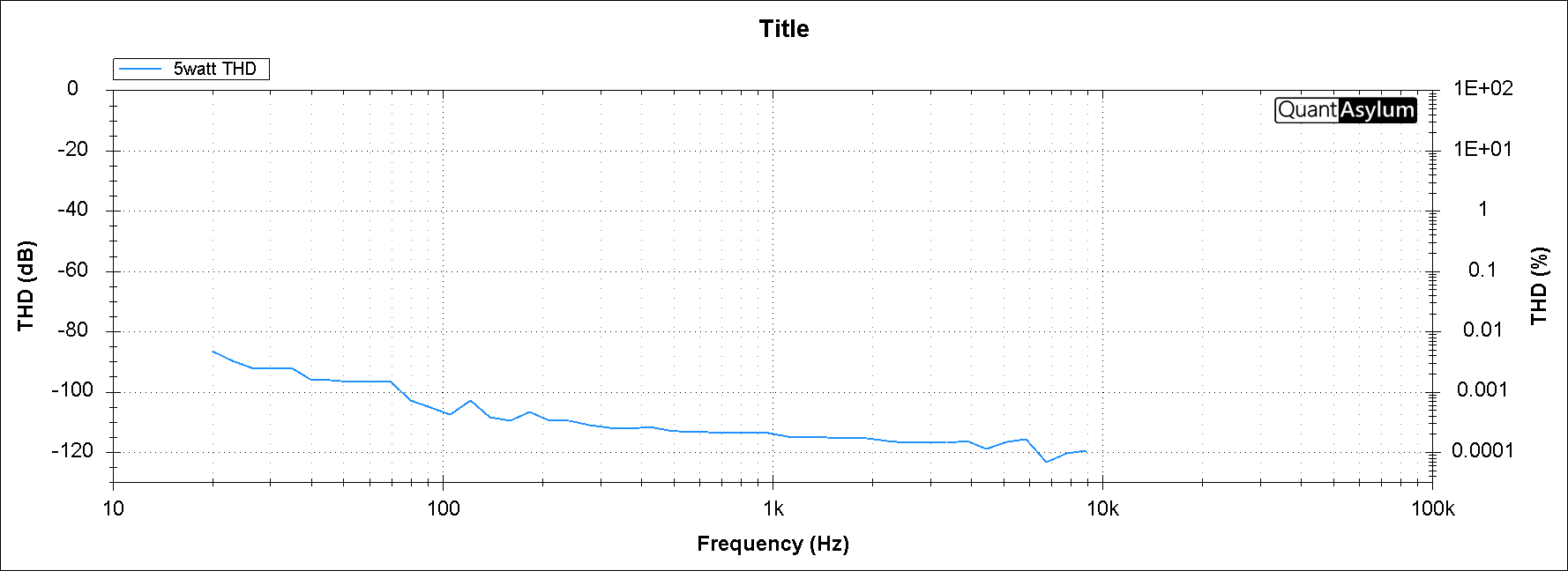

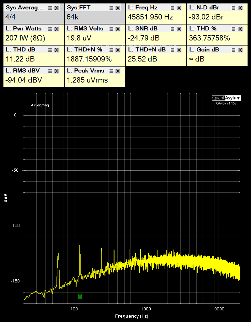

Nice base measurements. Similar to what I got without a distortion magnifier.So here are measurements of my first completed board.
WOW!!!!!!!!!!!!!!!
You will need a distortion magnifier to measure the actual distortion as is lower that the loopback distortion of the QA-40X

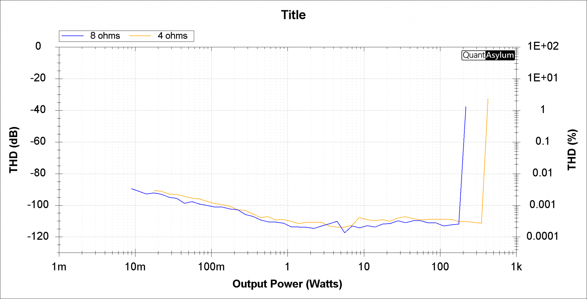

I measured 0.0000204% at 1khz into 8 ohms, 80wrms using the arrangement shown.
Distortion setup
The amplifier shown was prototype 2
Yes that was my impression too. The amplifier is better then the analyzer! I was impressed how the 4 and 8 ohm track each other right to clipping as well as how low the distortion stays at high frequencies. Absolutely amazing! All you guys did an unbelievable job on this project start to finish! Thanks again for all the time and effort on this design! 🍻👍🏻

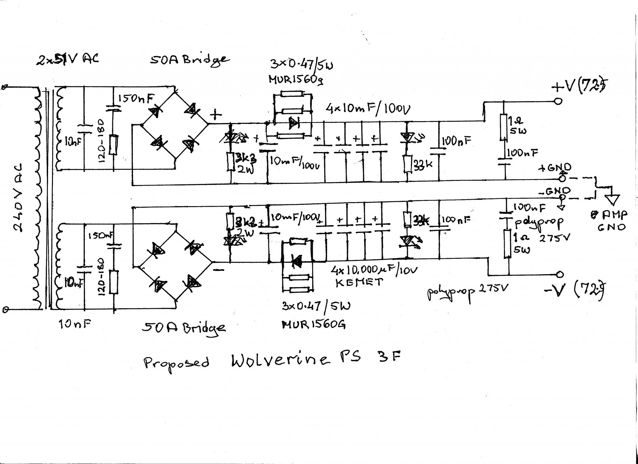

Hi Janusz,Attached is proposed Wolverine PS for my EF3. It's based on my Honey Badger PS but somewhat upgraded. Appreciate any comments.

It looks like a reasonable power supply but the 3k3 bleeder resistors may need a higher power rating, 5W is probably better.
One alternative is to use a higher resistance value (4k7 5W) or similar value in series (3k3 2W x2) I only mention this because they will run very hot with 72V rails/3300 Ohm.
I hope this is helpful.
What sort of VA rating are you planning to use ?
- Daniel

Yes, you are right. I'll probably use two 10k resistors in parallel like in my HB or one 4k7 5W. Thanks,Hi Janusz,
- Daniel
