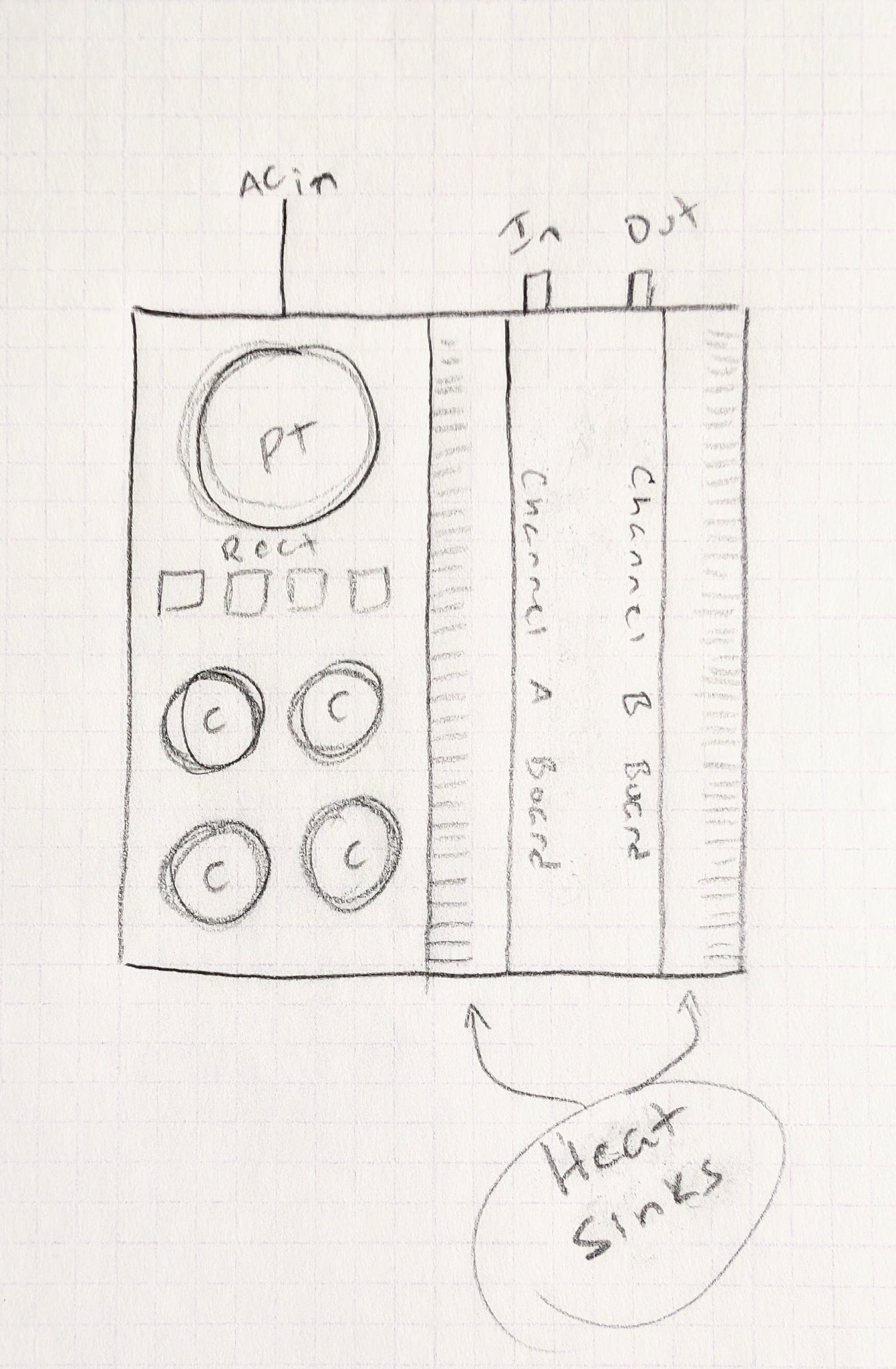

I've been reading over the best practices for wiring up amps. A lot of the work seems to be aimed at mitigating the noisy presence of the PSU between the two channels.
Am I wrong?
Why put it there to begin with?
In a stereo amp, would it not be advantageous to keep the PSU (transformers, rectifiers, and capacitors) outside the heatsinks so there's nothing noisy in the area between the two amp boards? I quickly drew up what I mean (attached). It seems a more fool-proof arrangement, noise wise. Everything flows in a tight U.
Does arranging the amp like that cause some other issue I'm missing? Am I failing to conceptualize this correctly?

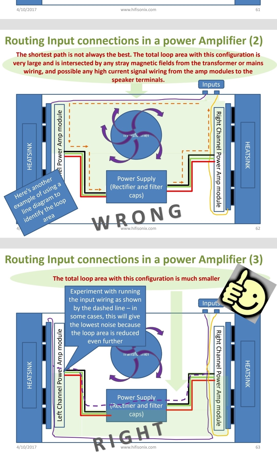

If its done right as per the instructions in the wiring document then you won't experience any noise issues. How do I know. Because we have done extensive testing on this. Please refer to the image below and you'll see some of the key differences between doing it right and doing it wrong.
@danieljw youtube video will guide you verbally through this process.
Wiring your amplifier

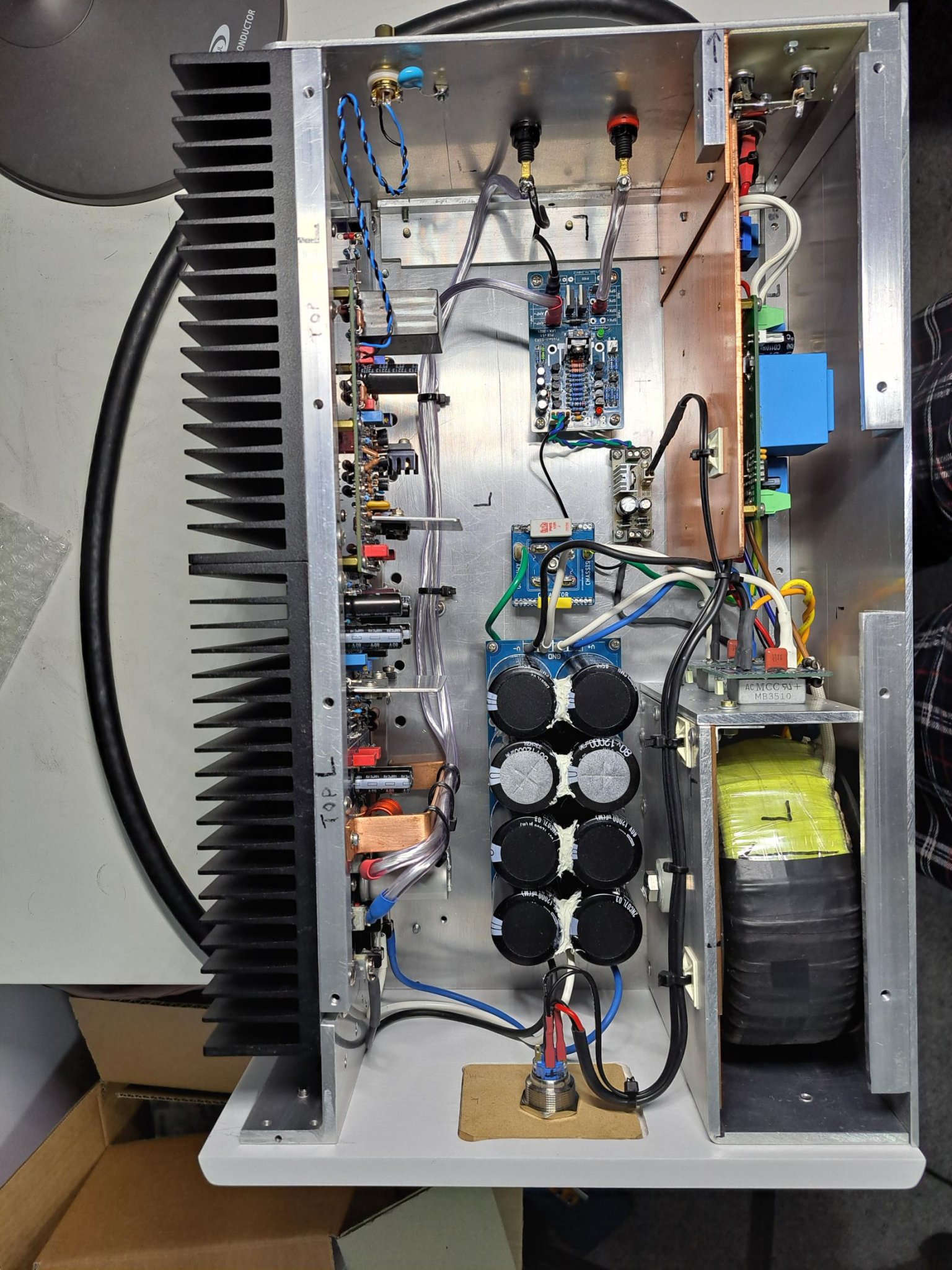

What your suggesting is fine to. But keep in mind the issues that @mainframe99 and others mentioned. You will also need to follow the guidelines of the document to ensure optimum results.

That layout isn't uncommon in commercial amps, more-so integrated amps it seems. Be interesting to see noise measurements, mind you it would be hard to truly do a comparison without building both types and testing both.
There is lot's of possible variations, GOSS band on toroidal, steel compartment around toroidal, Board Level Shielding of IPS, etc. To expensive for me to try it all out, more a job for a commercial research team, or project on tech university.
The Board Level Shielding of the IPS might be pretty easy to implement. Works for HF, should work for audio.
If its done right as per the instructions in the wiring document then you won't experience any noise issues...
Thanks Stuart! I hope you didn't infer I doubt the methods that you, the rest of The Wolverine Team, and everyone else have so carefully outlined.
I intended to make a custom chassis anyway. While sketching things out I stuck the PSU in the middle. As I went along I realized I had done that by default. So I asked why, and couldn't come up with an answer besides, "that's where I always see it."
I'm going to give my layout a try. It seems to me I can make the open loop area absolutely tiny.
Will that actually make a difference in noise? Considering the method you outlined already keeps everything out of the loop, probably not. But, I think I can make it look really cool as well. So... 😎 😂
