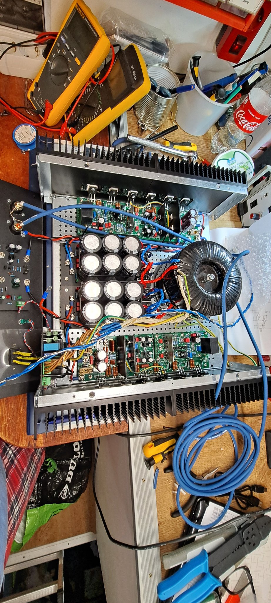

My wolverine is coming to the end. Still no music test, but with 1khz sine is able to produce around 150W on 8ohm. Transformes are 500w 42vac each. Dc under idle is around 58v going down to 55v at 150w.
During several tests I disconected 240v at around 100w load and one of dc protect board relay has gone. Welded contact probably. Don' engage anymore. Have to dismount some things to check. Don't like this.
