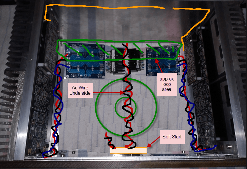

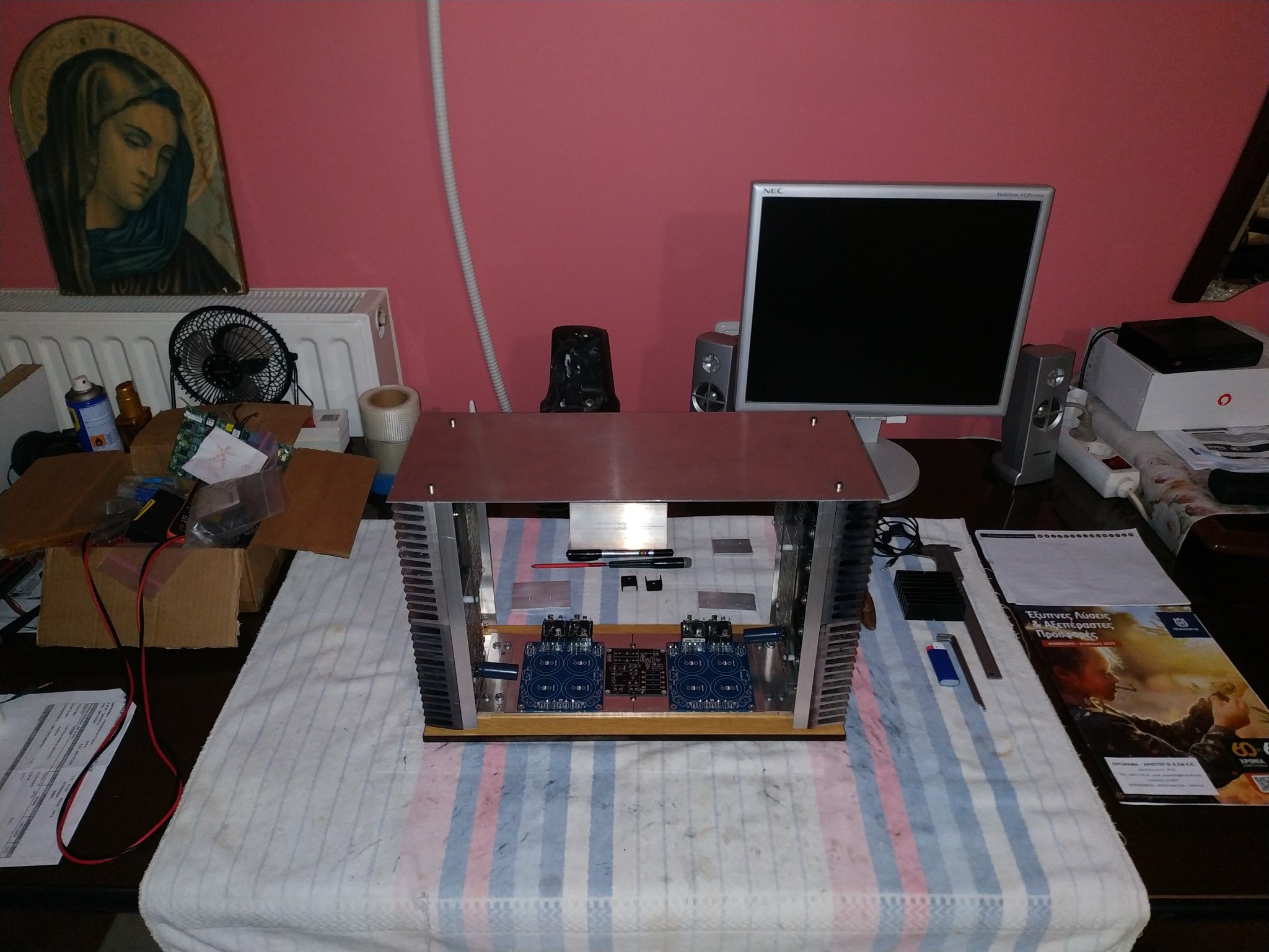

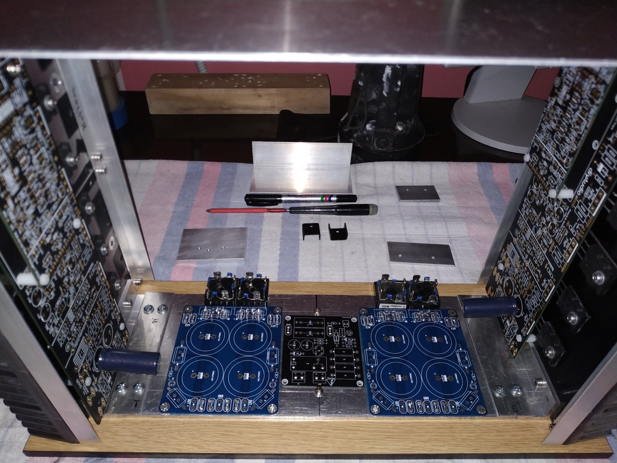

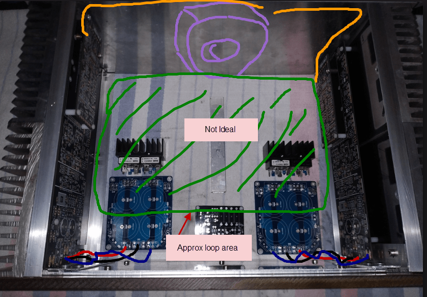

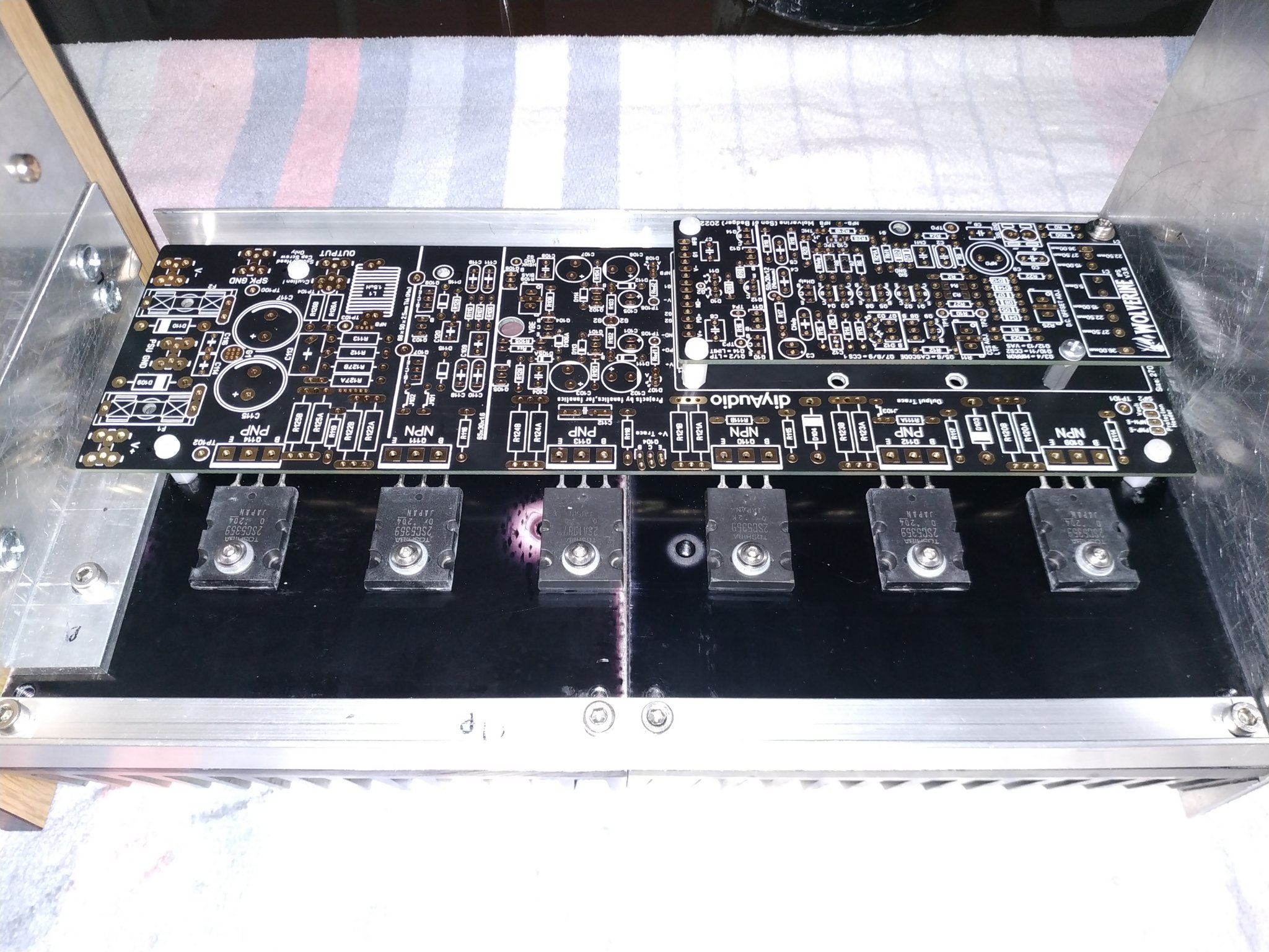

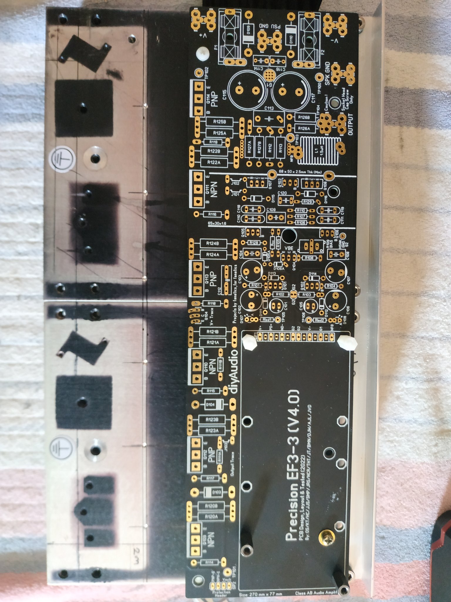

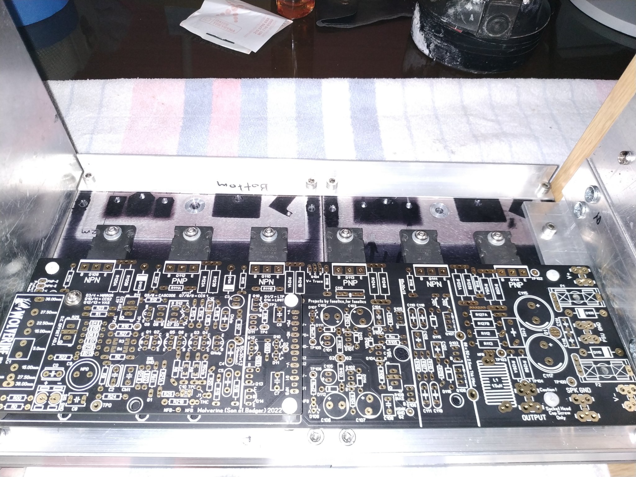

I'm not sure if that layout out is ideal. this maybe better.Τhe boards were fixed. One down one up .The inputs back to the box the DC supplies in front together with the transformer.Which will be placed vertically together with the soft start and Dc trap board.Tomorrow I will drill the holes for the output transistors.
I hope Project16 is well and comes back soon.Hi Kosti.. I'm afraid you can't find the same ones. My friend Project16 from France. He had even given them to me as a present. Unfortunately, I haven't heard from him for a long time .I am very sad.....

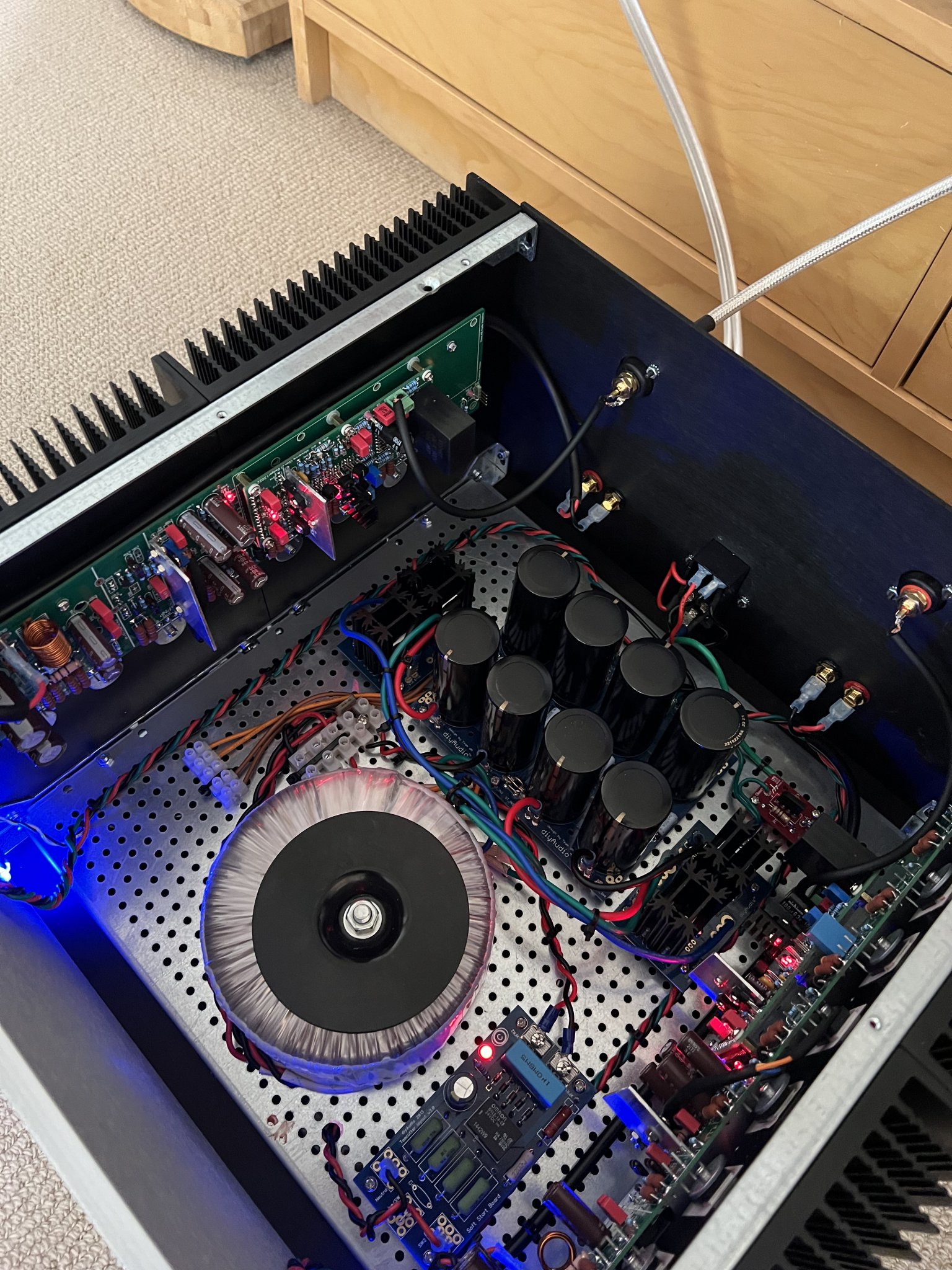

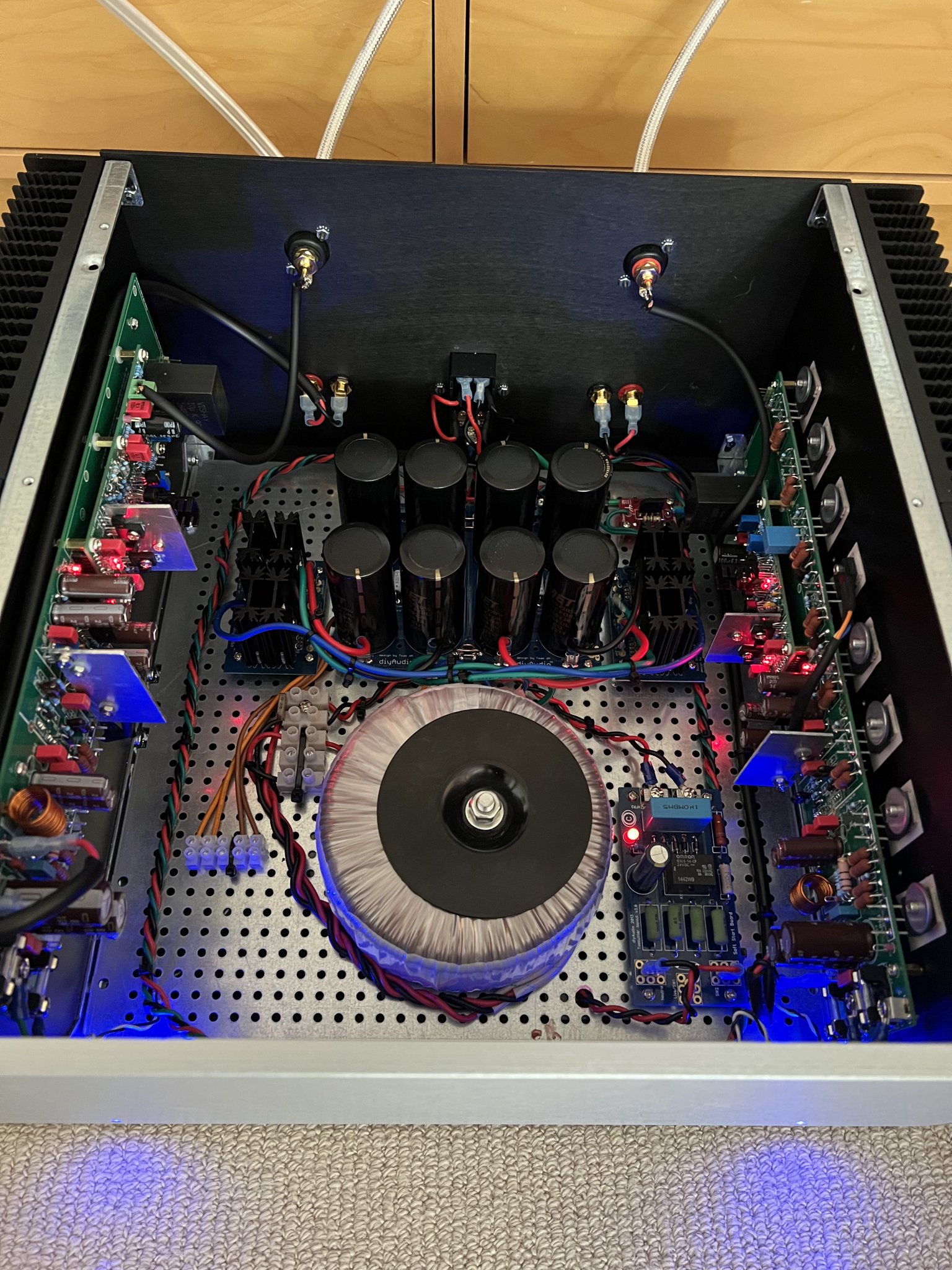

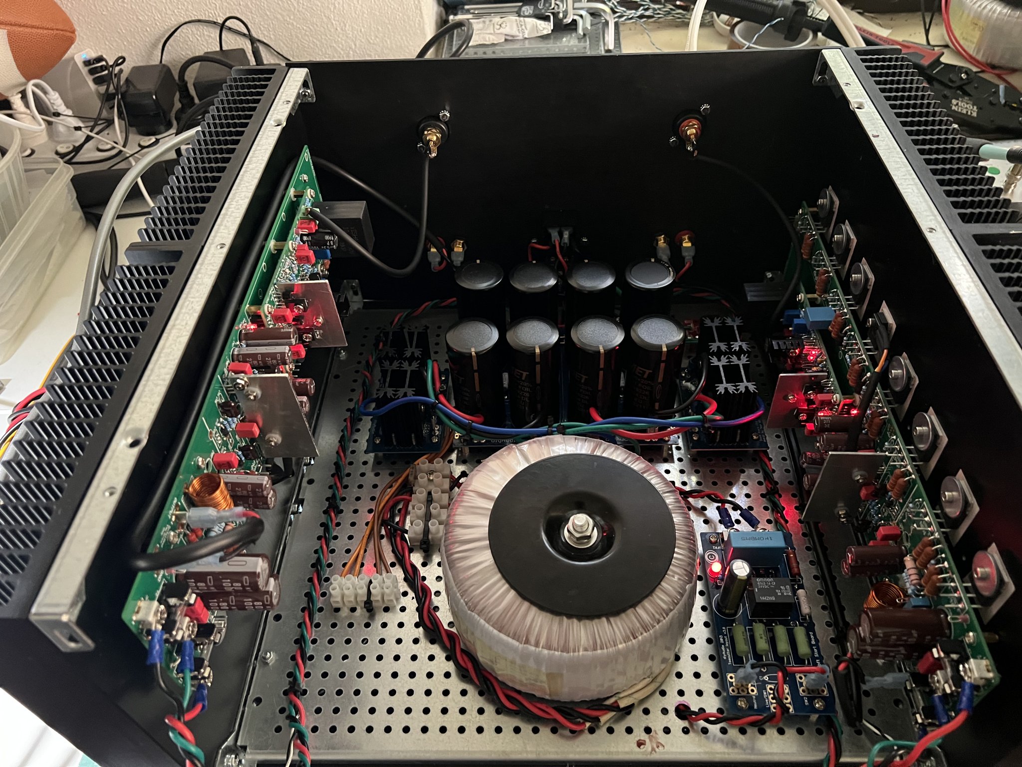

Music….yippee!!! The Wolverine is singing! All’s working, measured fine and letting it settle playing music for a couple of hours now. Will close the case tomorrow and enjoy the sound into the new year.

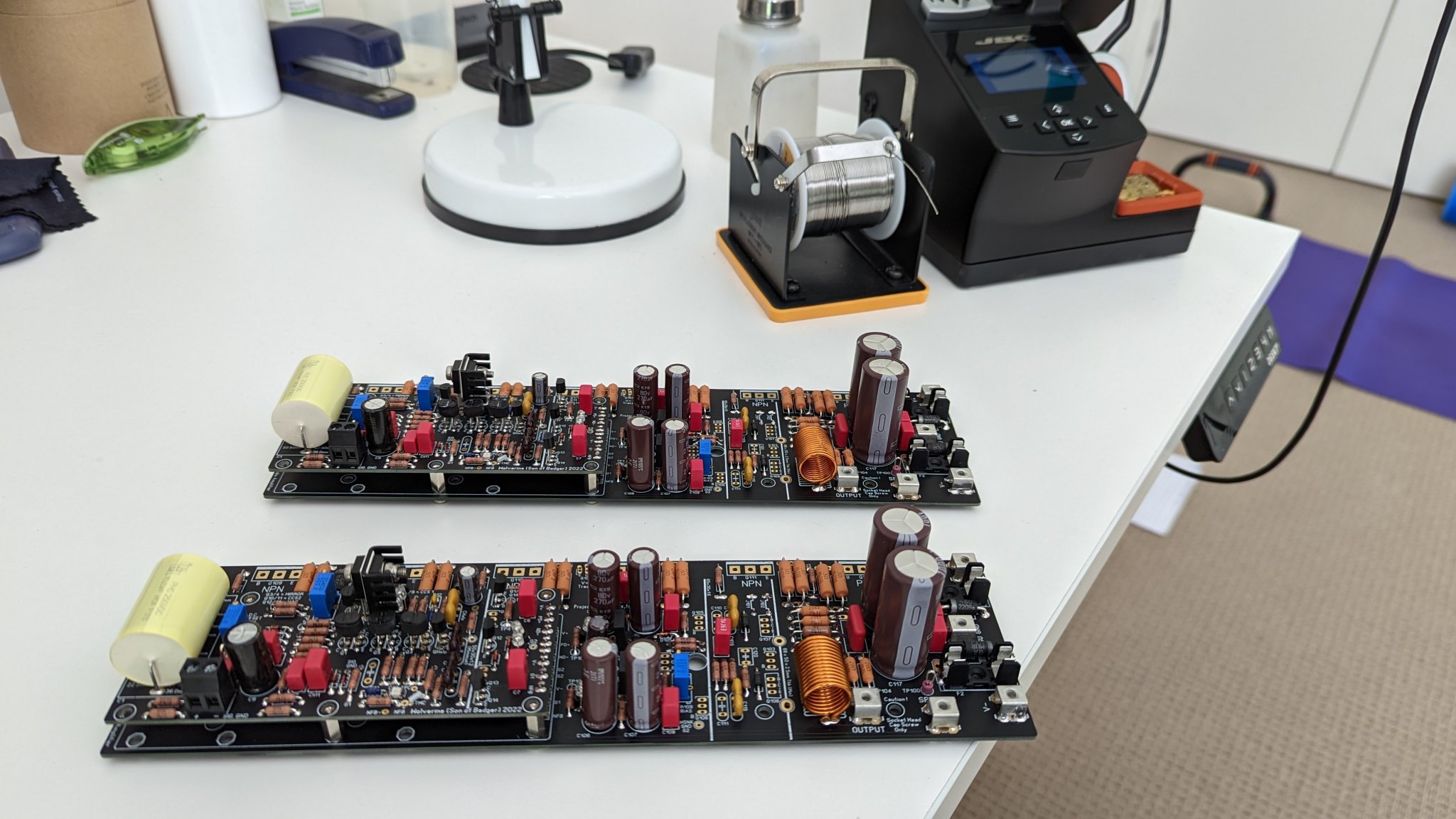

Definitely decided that I don’t have an aptitude for neat wiring or induction coil winding but be it as it may, I thoroughly enjoyed the building and looking forward to get my EF3-3‘s (that I built in tandem) into a case early in the new year.
Many thanks to the Wolverine team for the hard work and dedication and sharing it with us!!!
Happy New Year to all!!!

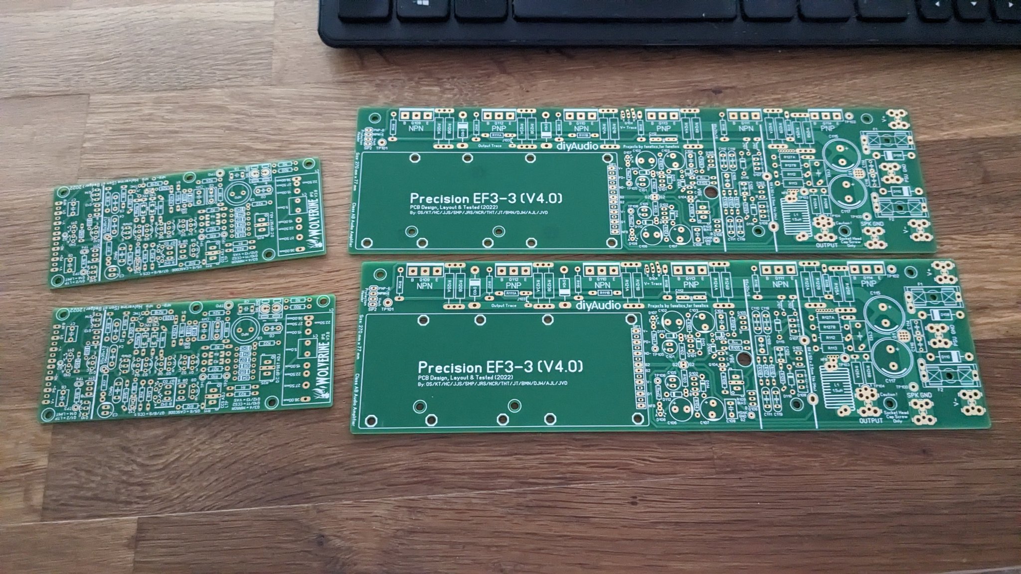

Oh, no - @voxxonline I can't believe you still haven't received your boards yet? In that case it's a bit of a miracle it seems that mine managed to organise a break out when they did ...!
It is what it is. I am in no hurry to build though. I read up on bits of theory but it is still a long shot from a complete understanding of small signal amplification. So I take this delay as an opportunity to plan my build a bit better.Oh, no - @voxxonline I can't believe you still haven't received your boards yet? In that case it's a bit of a miracle it seems that mine managed to organize a break out when they did ...!
Sitting back and enjoying this phenomenal amp….tight bass and absolute clarity!!! it has loads of grunt and is just wonderful to listen too.
it’s quiet and I don’t have any turn-on thumb. Using the DiyAudio soft start and currently no speaker protection (probably my next project)
Well done Steve!Sitting back and enjoying this phenomenal amp….tight bass and absolute clarity!!! it has loads of grunt and is just wonderful to listen too.
Just a suggestion - put a rubber grommet in the chassis baseplate hole for the mains wiring and also put some heatshrink or tubing over that cable for safety reasons.
Great build, and I would recommend speaker protection when you can.
- Daniel
The plans changed a little, the power supplies will be placed vertically and the soft start due to the large diameter transformer i have at my disposal only 15 centimeters high. I have seen it at 800 VA trafos have a larger diameter. Also the two capacitors at the output of the board significantly limit the space as well as the heatsinks of the drivers. So the transformer will be placed below and horizontally.

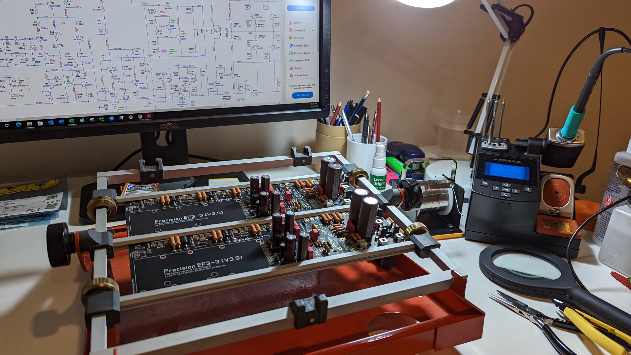

Hi Guys,

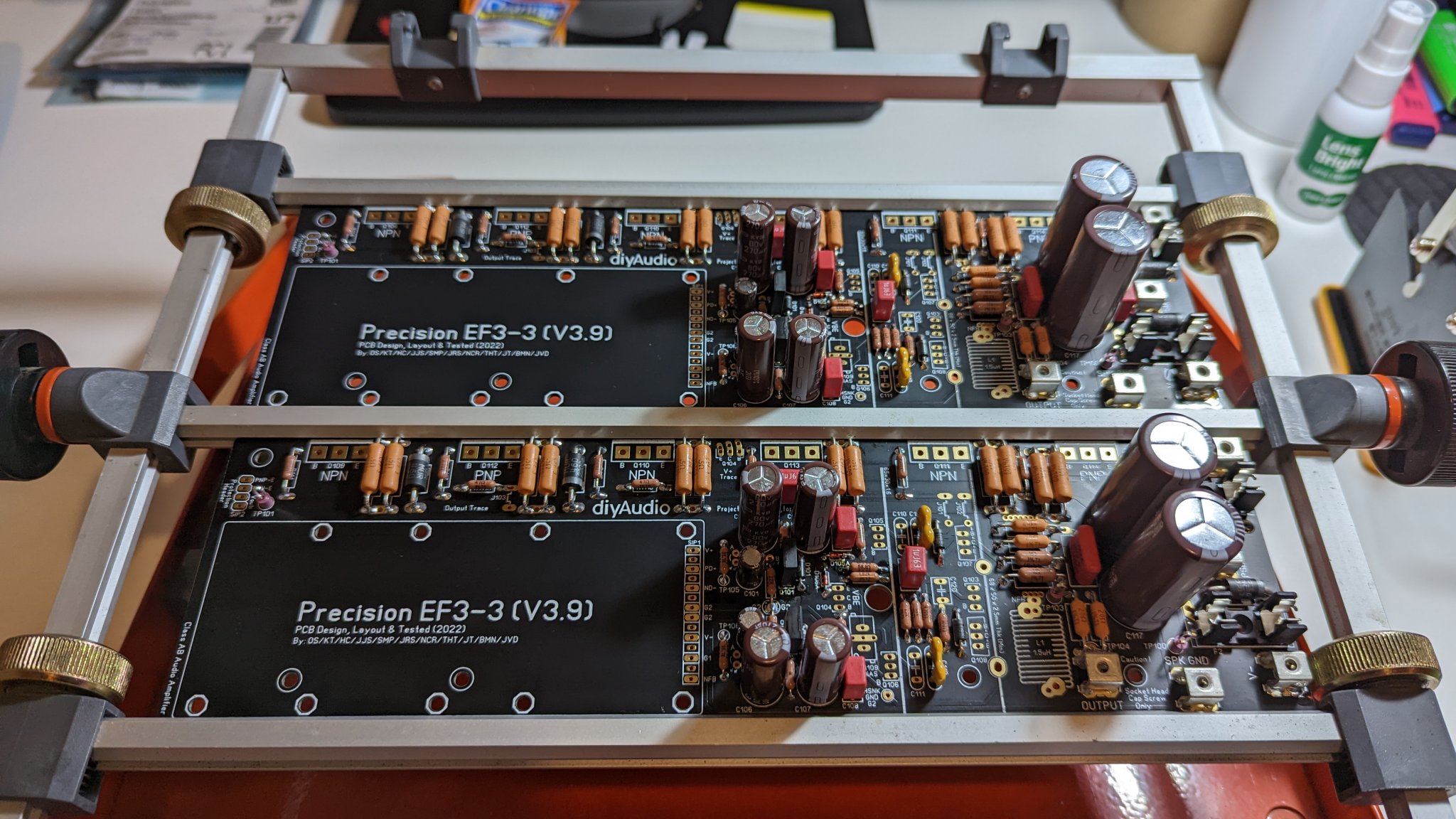

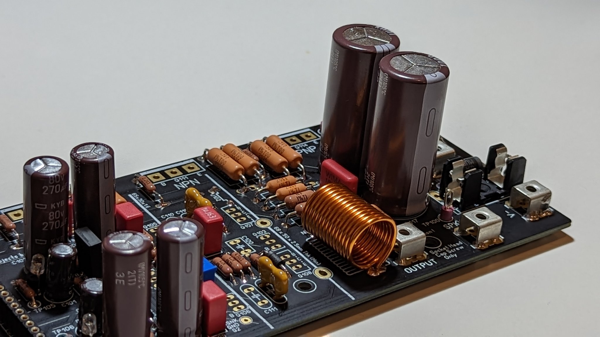

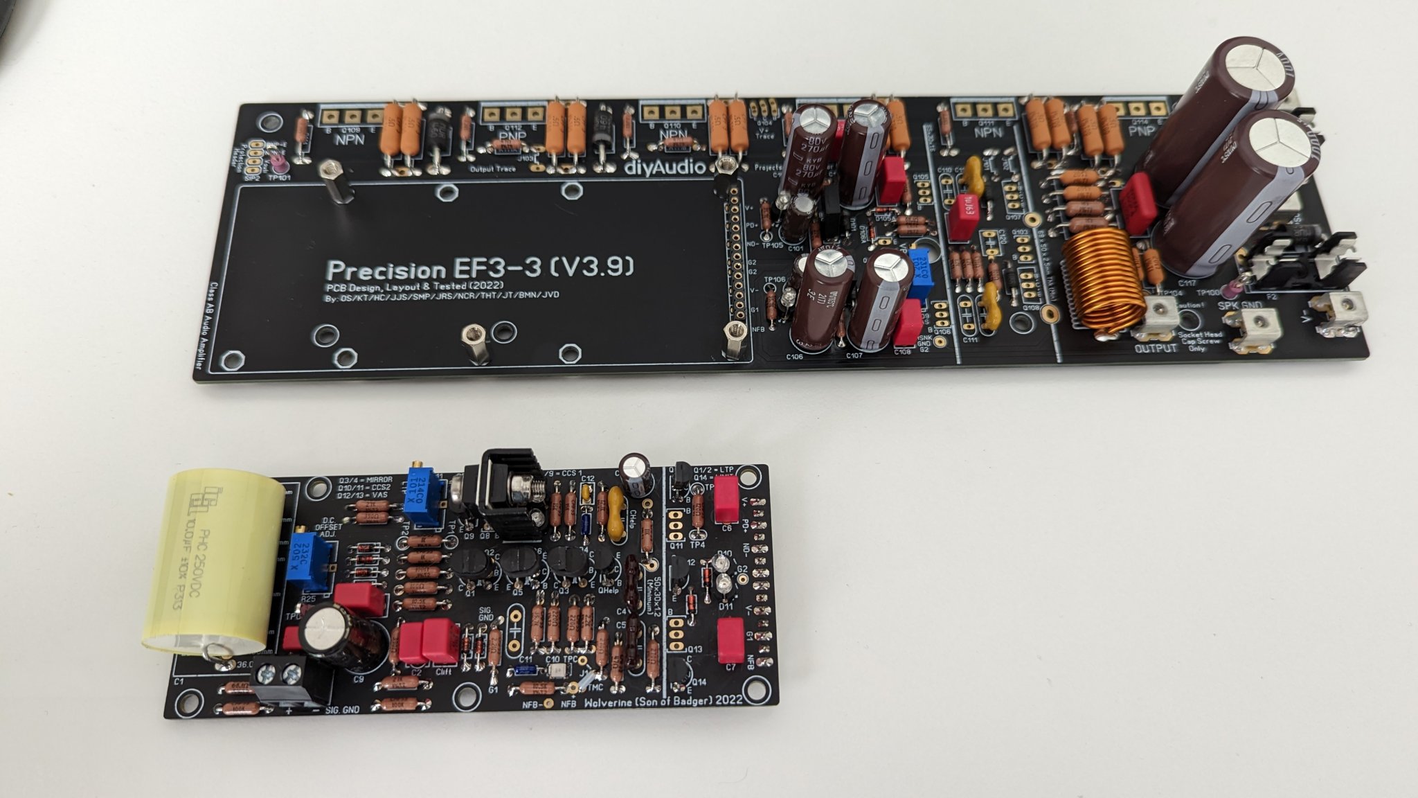

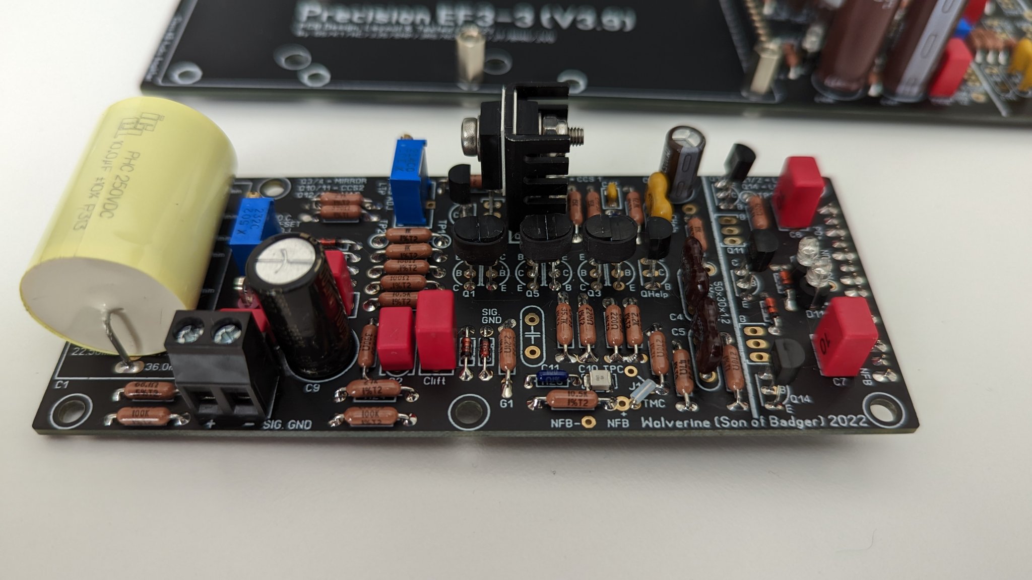

Wow, there are some amazing and inspiring Wolverine builds underway. I can't wait to fire up this beautiful amp and start listen to music. I have made a lot more progress on my build through December and thought I should post some photos. I only need to complete the three heatsinks on the PCBs and mount the output devices to the heatsink and I can start testing them on the bench.
I haven't decided on an enclosure as yet. I would like to thank all who have contributed to this fantastic project - much appreciated. Happy New Year to everyone!!

I would recommend the DIYA Store 5U or 4U cases with integrated heatsinks. 5U especially if you plan on dual transformers/power supplies. And your build looks great so far, congrats. Season's greetings backatcha.I haven't decided on an enclosure as yet.

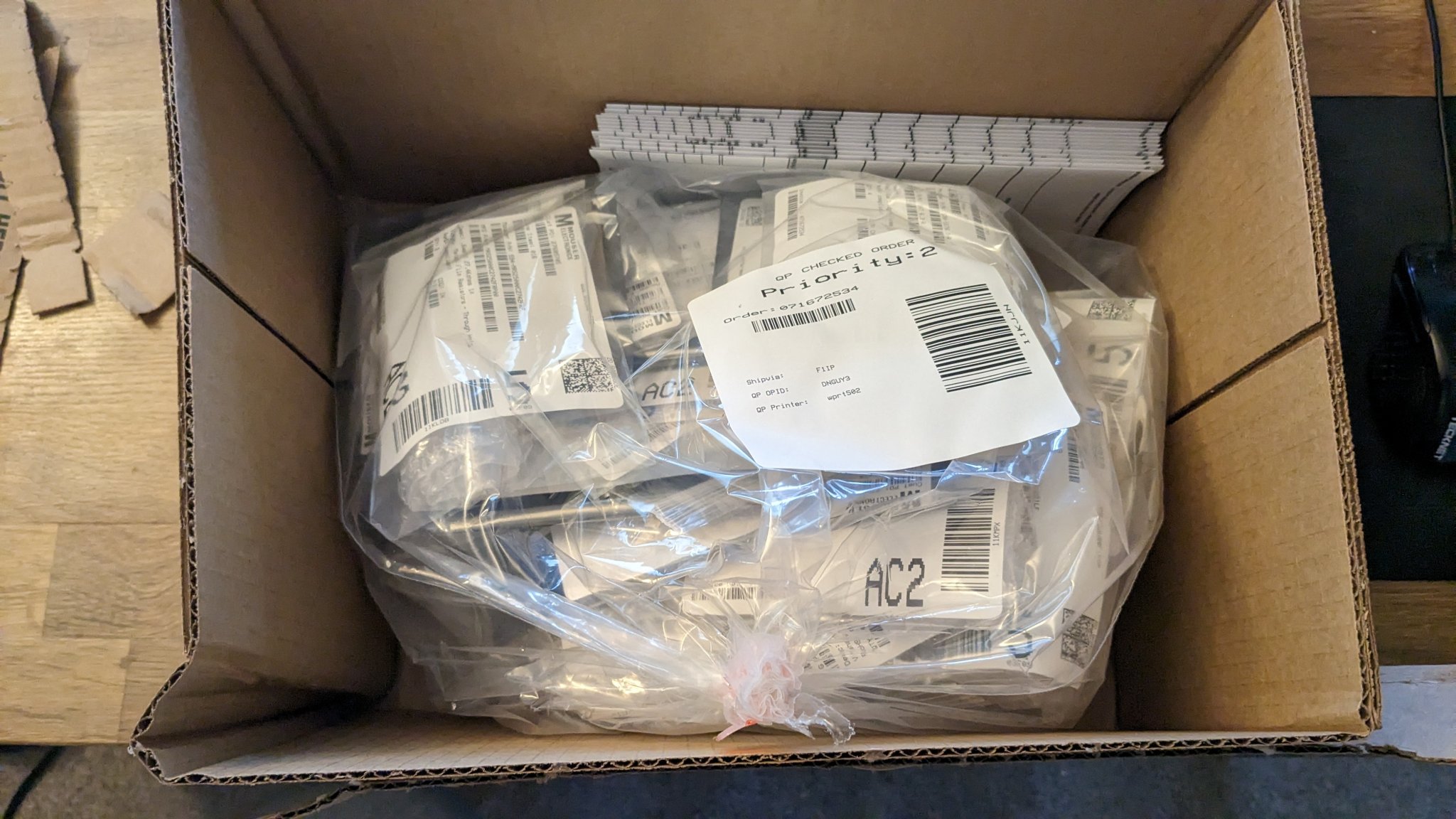

I am pleased to say my W boards arrived today, as well as 85% of Mouser's components and the bench power supply. Some minor items to be ordered, but all in all, my 7 week's wait is over
The longest delivery wait I have ever had.
