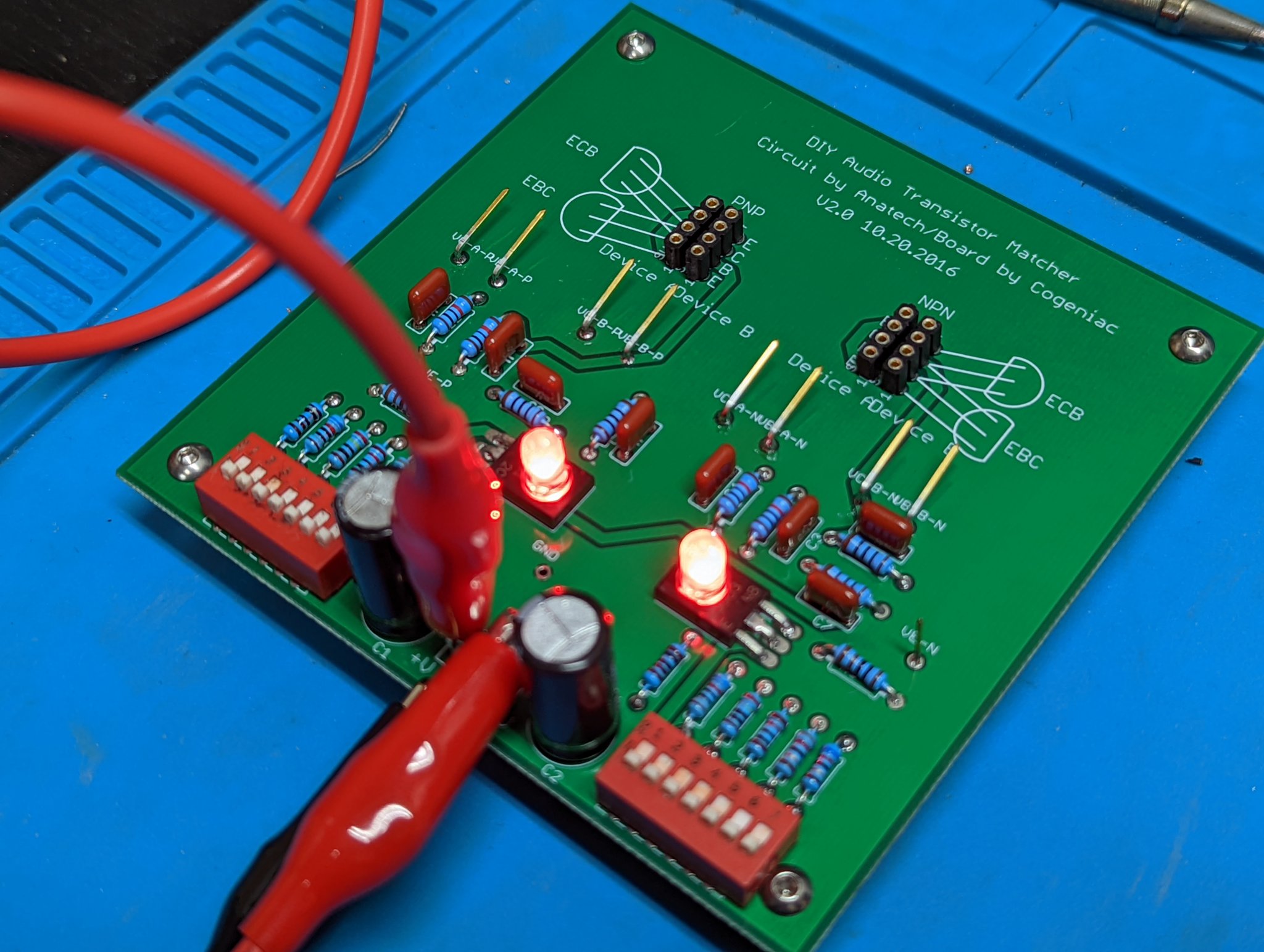

Yes mine has arrived too, I think I have read that thread 3 times now. Would be great for info on correct usage, and what components are necessary to be populated? Thanks!greglo3a:
Your transistor matcher board has arrived -- I can't wait to start populating it! Any chance you've uncovered a BOM for the board? It seems the BOM is no longer available on the original thread (the dropbox link is broken). The schematic provides guidance on most but not all of the components.
Many thanks,
Scott

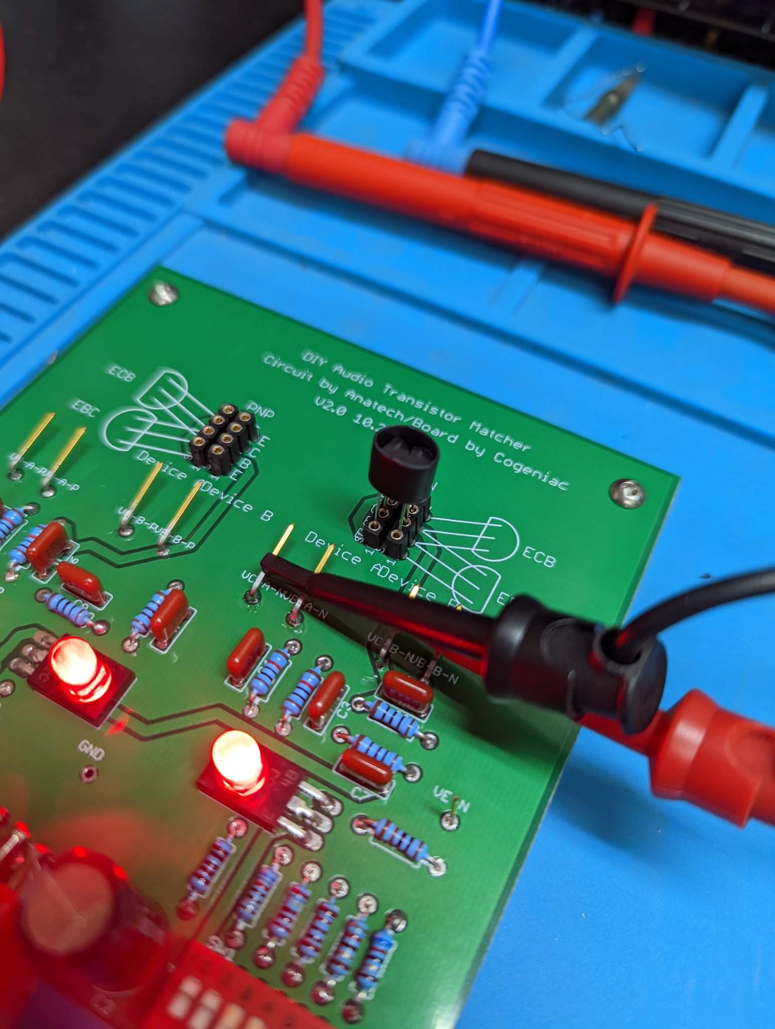

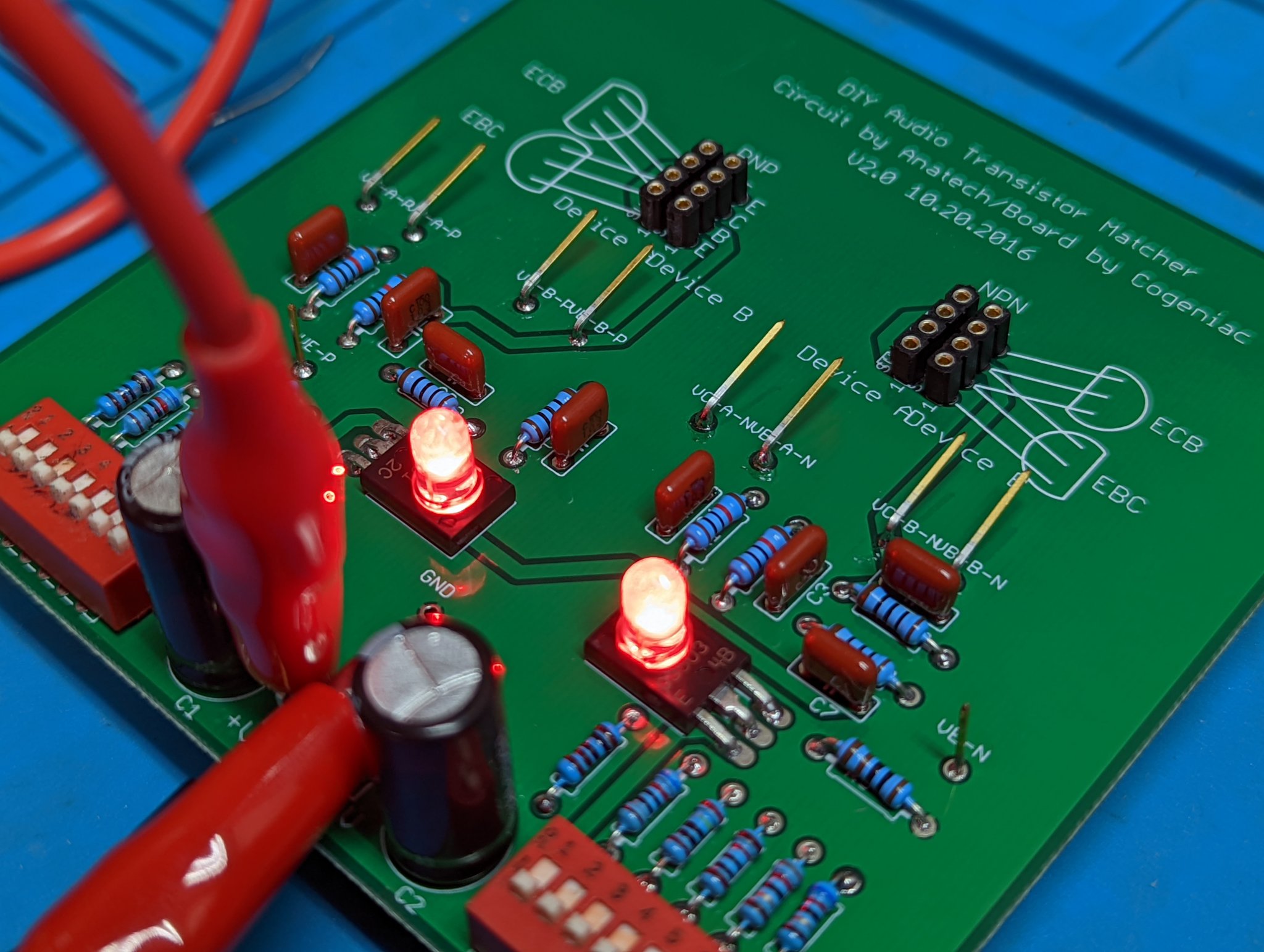

Ok so managed to get this built with some spare parts and salvaged DIP switches lol.
BOM for those interested;
R1,R2,R21,R22 - 10K .1% or better Matched
R3,R4,R19,R20 - 100R .1% or better Matched
R5,R18 - 1K
R6,R17 - 62R
R7,R16 - 82R
R8,R15 - 120R
R9,R14 - 240R
R10,R13 - 620R
R11,R12 - 1K
D1,D2 - 3mm LED
C1,C2 - 100uF
C3-C10 - .01uF
Any errors please let me know.
I also assume DIP 1 and 2 on is roughly 3 mA current? Please confirm.
EDIT - My Matches measured with 4 Wire
100R - 99.923 | 99.918 , 99.913 | 99.910
10K - 9.99599 | 9.99583 , 9.99257 | 9.99181

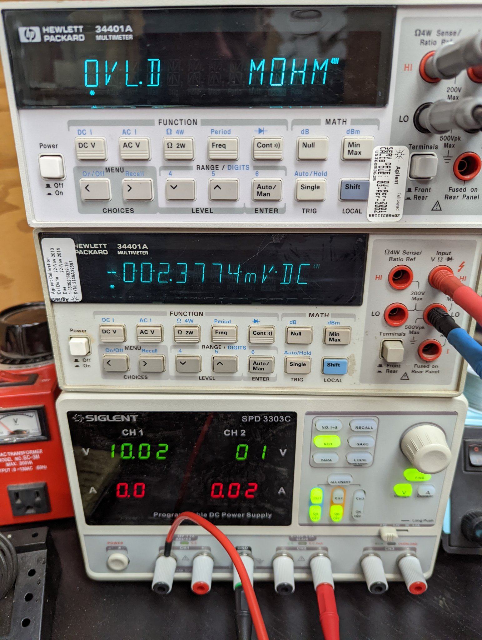

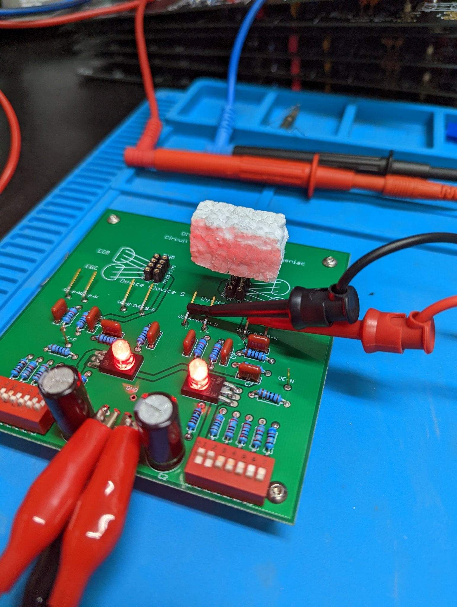

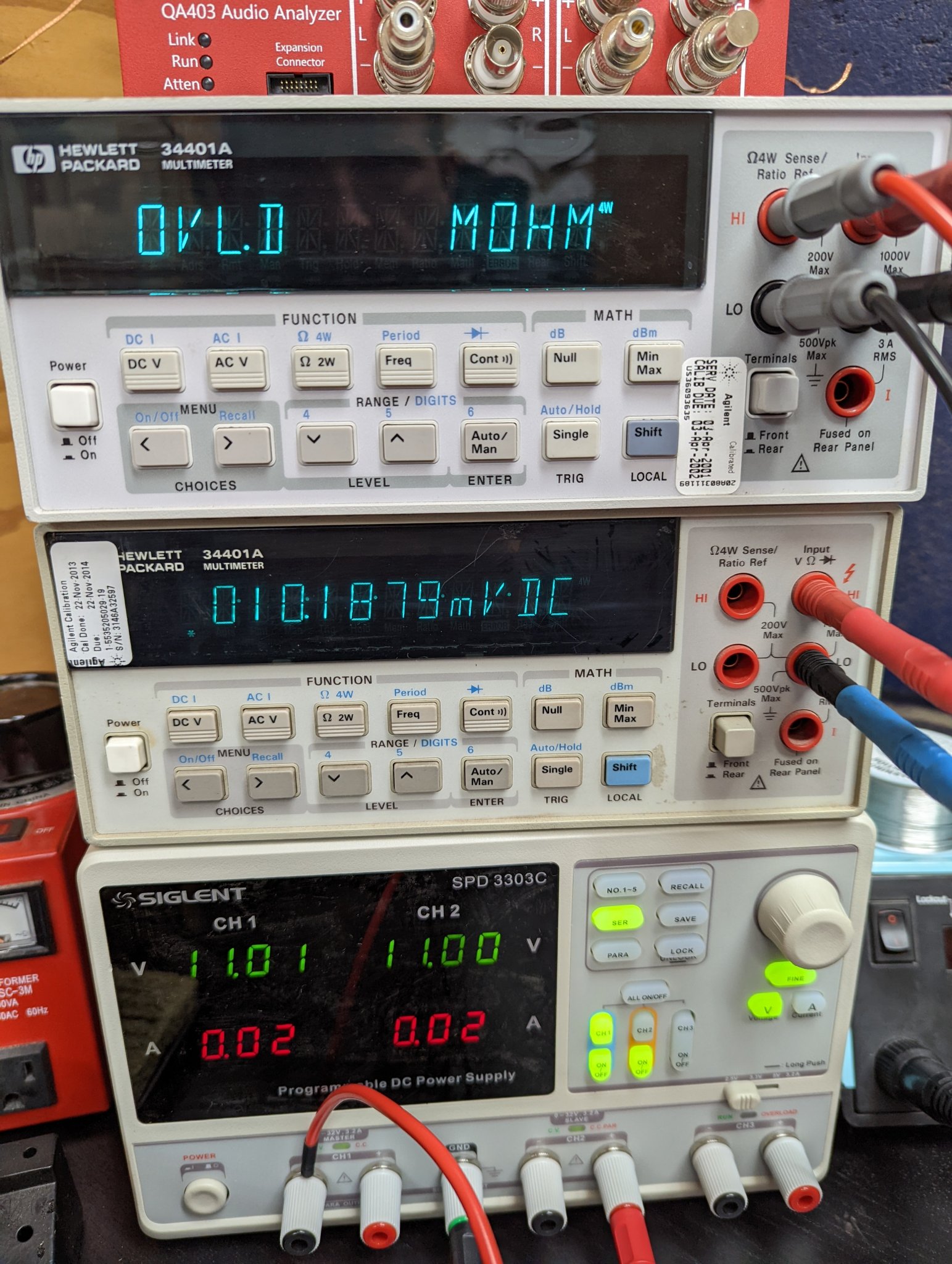

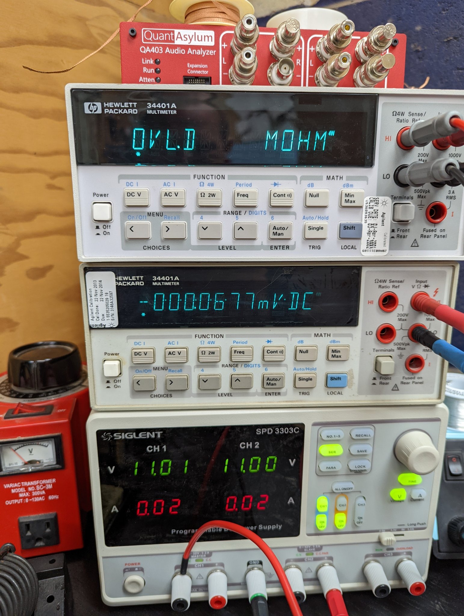

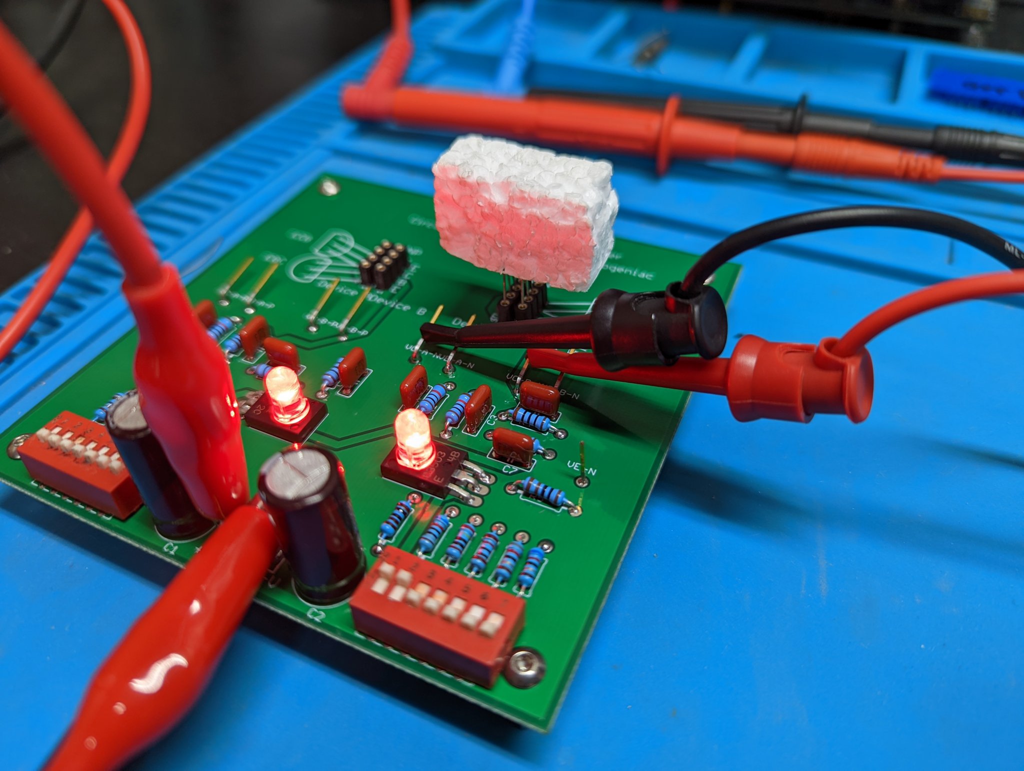

Yes it does, lucky for me all my HFE matches with my PEAK have all matched around +-0.5mV or better so far! And as stated in the matcher thread Close contact is key as well as blocking air currents, I placed a box over the whole thing while I measured.Thanks for the BOM, I will pick-up my boards tomorrow. I had 10 made. Nice to see that it works extremely well.
I used these, had a bunch from another project - Digikey P4713-ND | ECQ-V1103JMOne last question, what's the lead spacing on the .01uF film caps?
