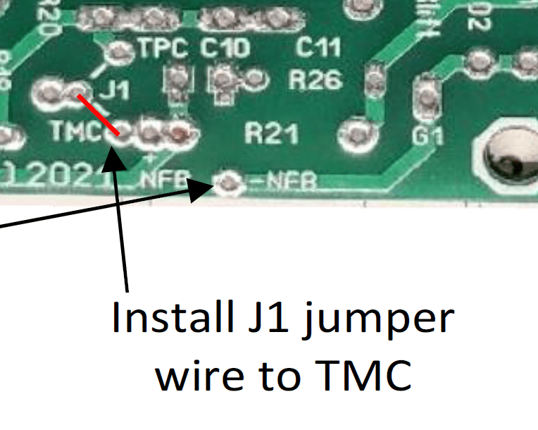

I've just begun soldering the IPS board and have what is likely a dumb question: does TPC need to be connected to TMC with a jumper? There are two lines at J1 -- one connects TMC to NFB and the other connects TMC to TPC. The Build Guide only mentions the TMC - NFB connection. Is the line between TMC and TPC a mistake?
Don't worry, I'll have plenty more dumb questions before this build has been completed.

Frequency compensation usually has two primary goals: To avoid the unintentional creation of positive feedback, which will cause the amplifier to oscillate, and to control overshoot and ringing in the amplifier's step response. It is also used extensively to improve the bandwidth of single pole systems.
The miller capacitors are C4 & C5
TMC = Traditional Miller Compensation.
TPC = Two Pole Compensation (not tested)
You cannot install both jumpers. Only one should be selected and installed.
Further information
Hope that helps.

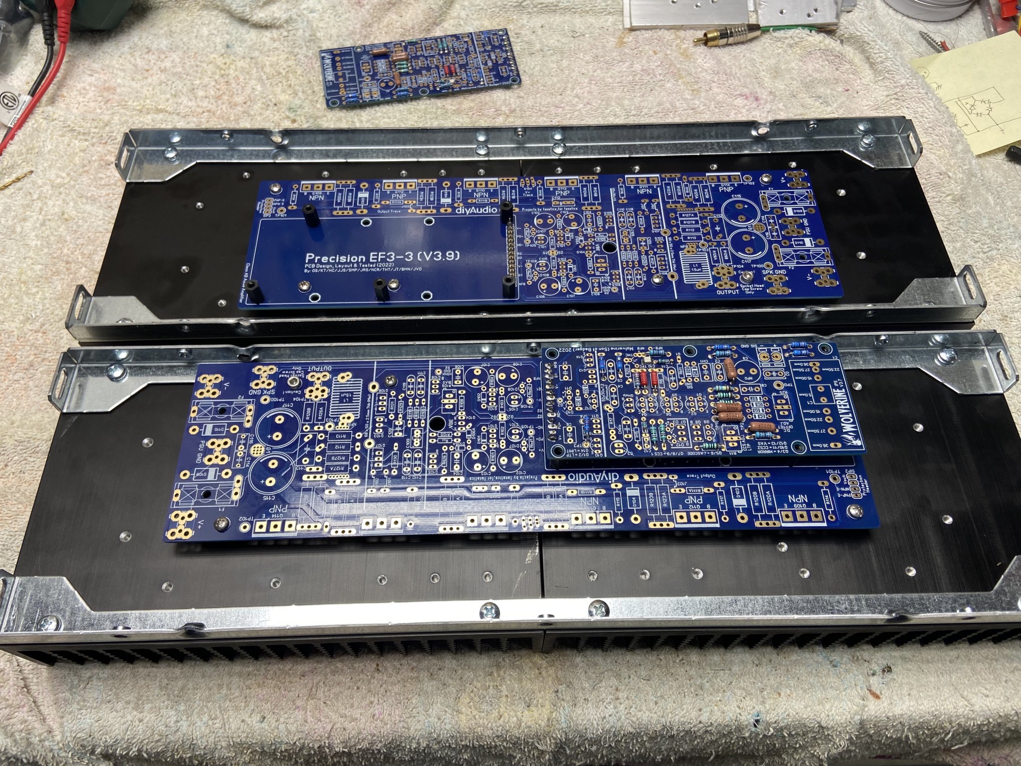

Folks:
My Wolverine project has only just begun. I am building an integrated amplifier for my parents and the plan is to fill a 3U 400mm chassis to the brim. The chassis arrived earlier this week and includes the Wolverine variant on the UMS drill pattern. Kudos to the Wolverine team and HiFi2000 for all their incredible work!
Scott
Scott

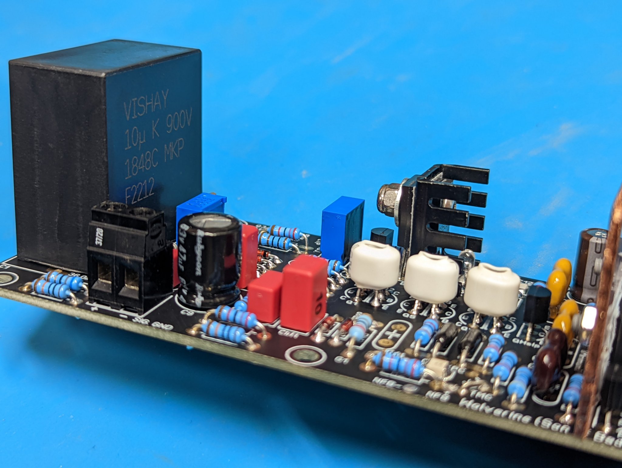

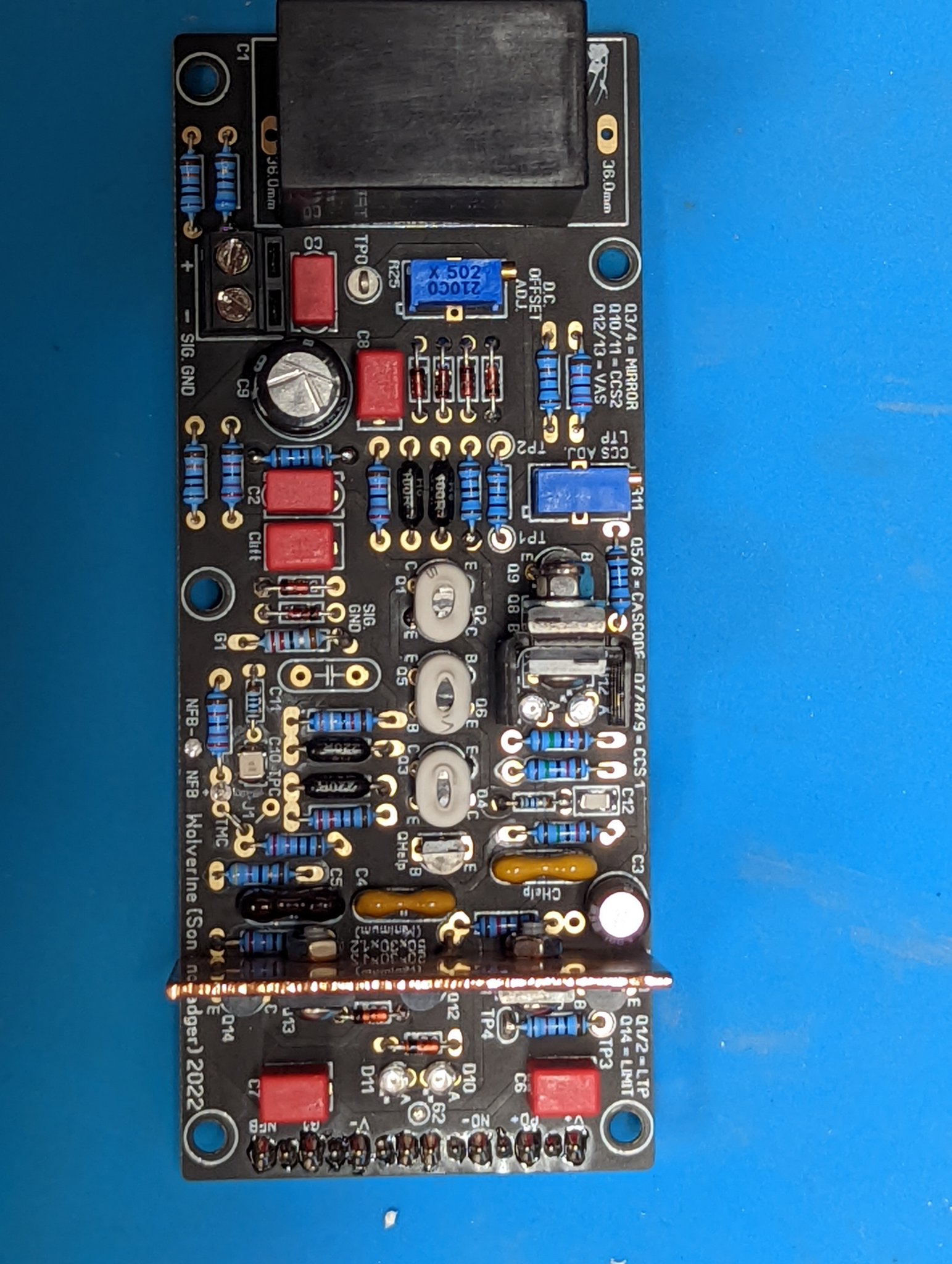

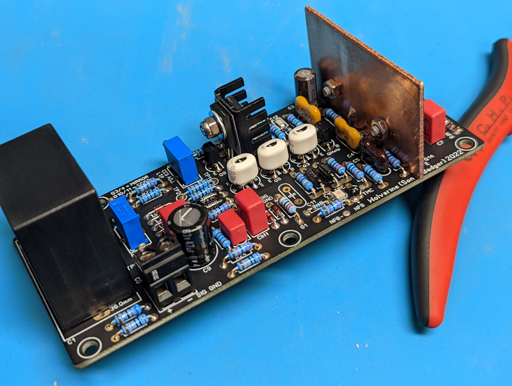

Looking good.Small milestone! 1 of 6 Input boards complete

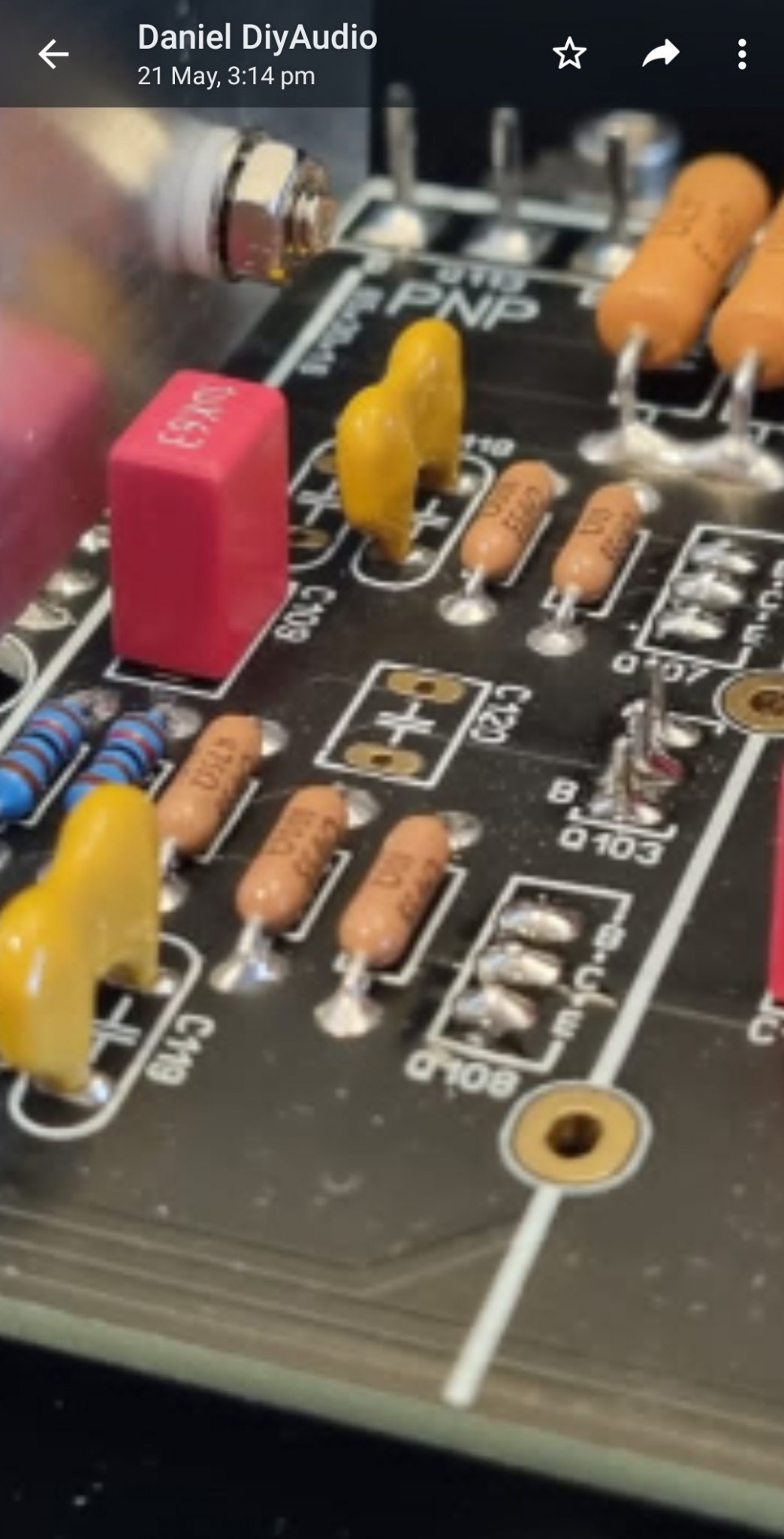

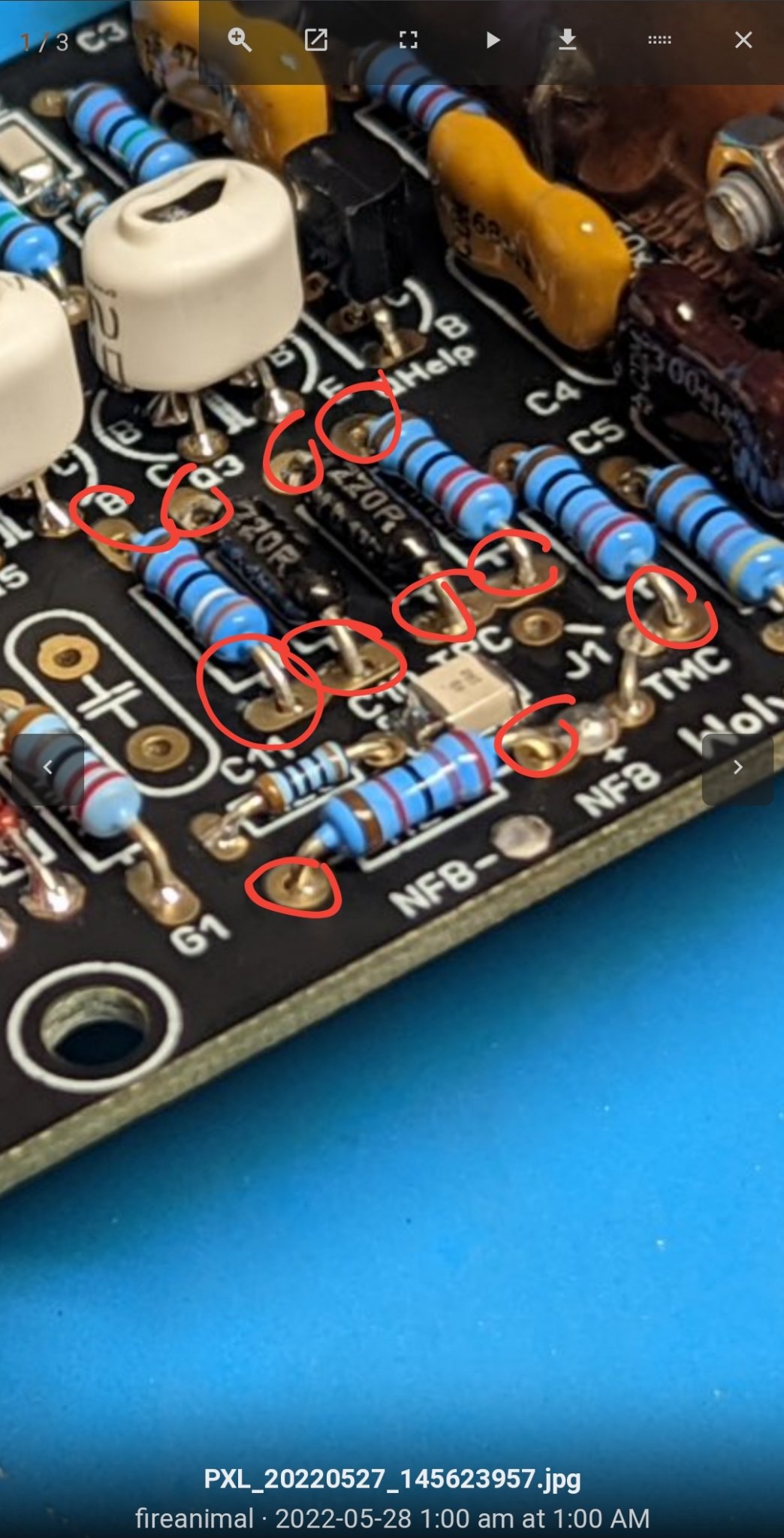

Are you able to apply some solder to the top of the pads to help secure the component and create a better connection. 🙂
It looks a lot better to. 😊
See a small snapshot from Daniel's board
Thanks! I've never soldered both sides of a PTH PCB before? I see some joints did not get full flow through but the solder is in the PTH right below the pad, so mechanically it is good. Only issue I can see is if the board needs rework, it will be a real pain to remove the components if they are soldered both sides. It maybe more personal choice to solder both sides, but really at the end of it all I am just an amateurLooking good.

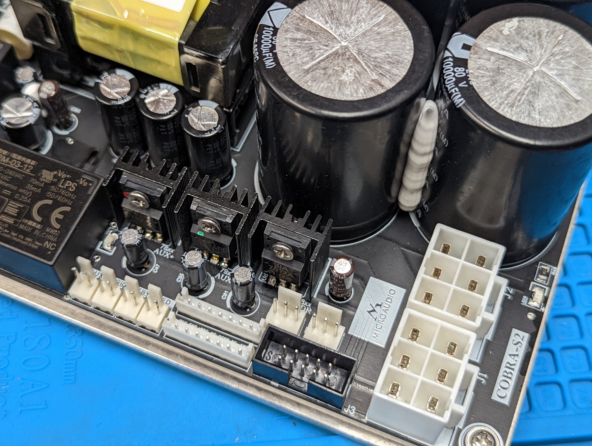

Power supplies just arrived, cant wait to test them out! Microaudio Cobra-S2
What's the output voltage of your SMPSs?
+-63What's the output voltage of your SMPSs?
Applying some heat and a little solder on the top side will draw it up from the bottom and through the PTH giving you a more reliable connection. Reinspect the bottom connection for sufficient solder. There should be 100% coverage around the lead to the PTH.
Removing parts should not be anymore difficult other than maybe removing a little extra solder.
Jeremy

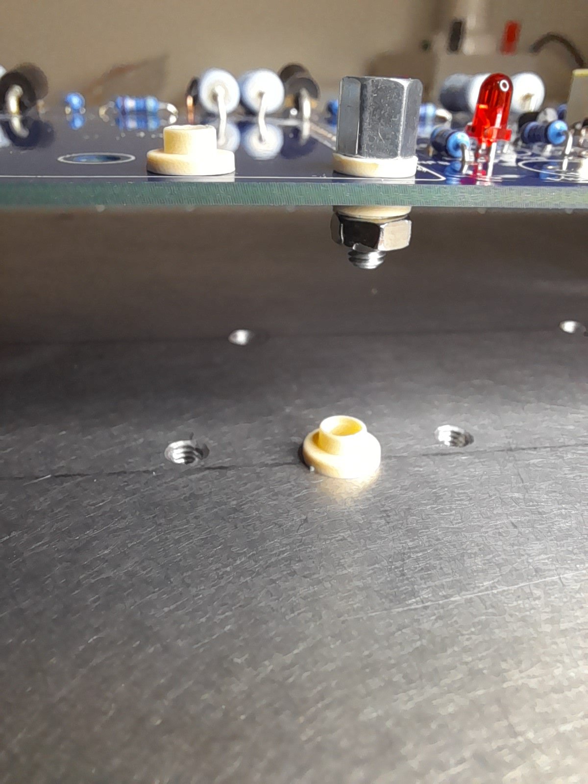

I have been trying to find a way to reliably isolate metal screws and spacers from pcb tracks on both the input and main pcb's. Ended up using those TO126 plastic mounting washers and slightly adjusting my spacer length. I have a collection of those washers so not sure where to buy. Perhaps this will help if you are stuck.
