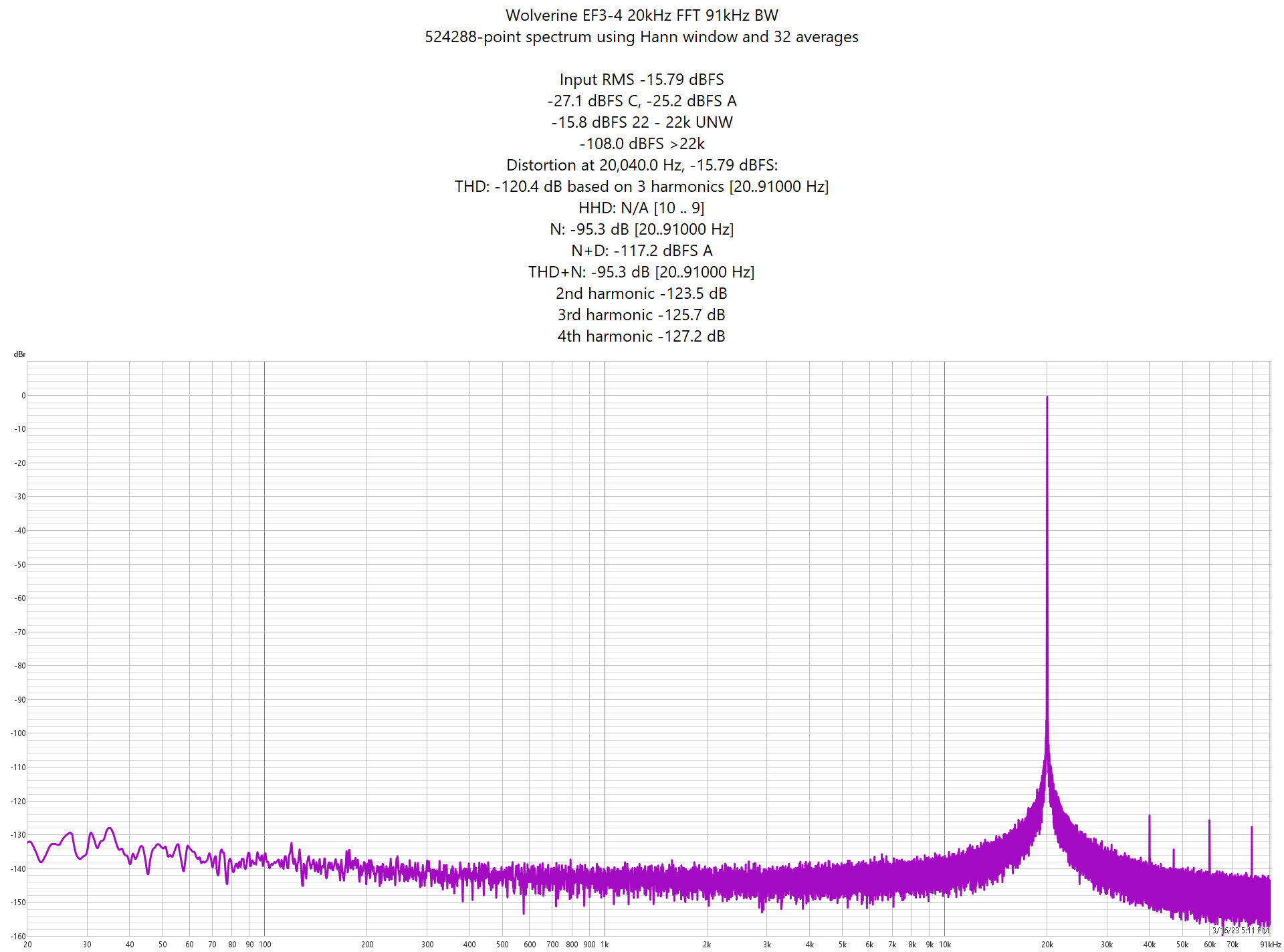

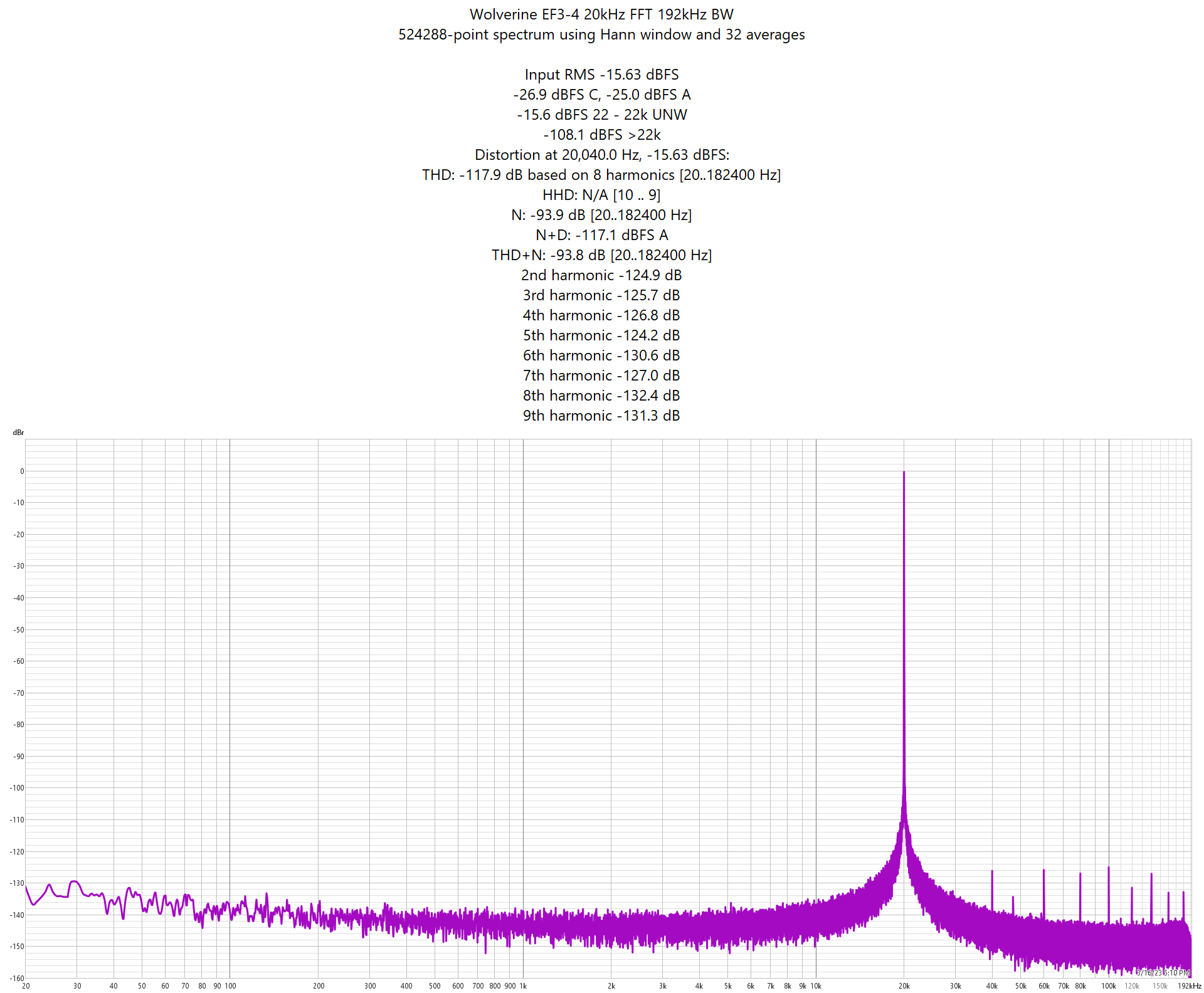

I just wanted to update everyone with some tests that I have been working on for a long time now. Trying to test this amplifier at the performance level it is capable of is no small task, both in time and equipment. The Wolverine team spent a lot of effort on not just making 1k low distortion but also 20k, issues abound though when actually trying to measure 20k and harmonics cleanly and accurately.
To be able to actually test at this level I had to purchase one of Viktor's oscillators tuned to 20kHz, build a suitable low noise and ripple free power supply for it, and then figure out the best way to actually measure the damn thing. I have a Cosmos APU that has notches at 1k and 10k, so I decided to modify the 10k section to turn it into a 20k notch, swapped out the needed resistors and capacitors and I was in business. It was calibrated to the output frequency of the oscillator which works out to 20,040Hz once at temperature.
Using REW I was able to create a correction curve for the filter, and using the D10S with REW's signal generator, which allows you to inject a known amount of distortion into the signal, I was able to verify that the calibration curve was correct and accurate to +/-0.5dB.
First run at it turned out well, but there was power supply/mains noise that had to be cleaned up. Stuart came up with the idea of powering the voltage regulators with lithium batteries, which did the trick!
Attached are two FFT's that were taken today @ 20kHz, one of them is full bandwidth 192kHz and the other is limited to a more reasonable 91kHz. These were taken with a Wolverine EF3-4 using Sanken 2SC3264 and 2SA1295 outputs on +/- 71 volt rails. The measurements were taken at 25Vrms into 8ohms and the amplifier was at stable operating temperature.
I am not sure of many amps that measure better then -120dB @ 20k... If you know of any please let me know!

The time and attention that @fireanimal has put into actual being able to measure this amplifier is something that we should all be very grateful for. I would hate to put a number to the amount of hours he has spent researching, testing, setting up and refining his measurement process. Prior to these measurements all we have really been doing is measuring the measuring equipment and not the Wolverine it's, because as it turns out the Wolverine is actually better than the most measuring equipment.
We need an oscillator with a loopback distortion of -140db or 0.00001% at 20k to be able to confidently know that we are now measuring the Wolverine.
Looking at the final numbers -120.4db is 0.000095% THD tested at 20khz and driving 80 watts into a 8 ohm load.
A truly Amazing result and inline with what the simulator predicted. That's one of the reasons we kept refining our measurement technique.
