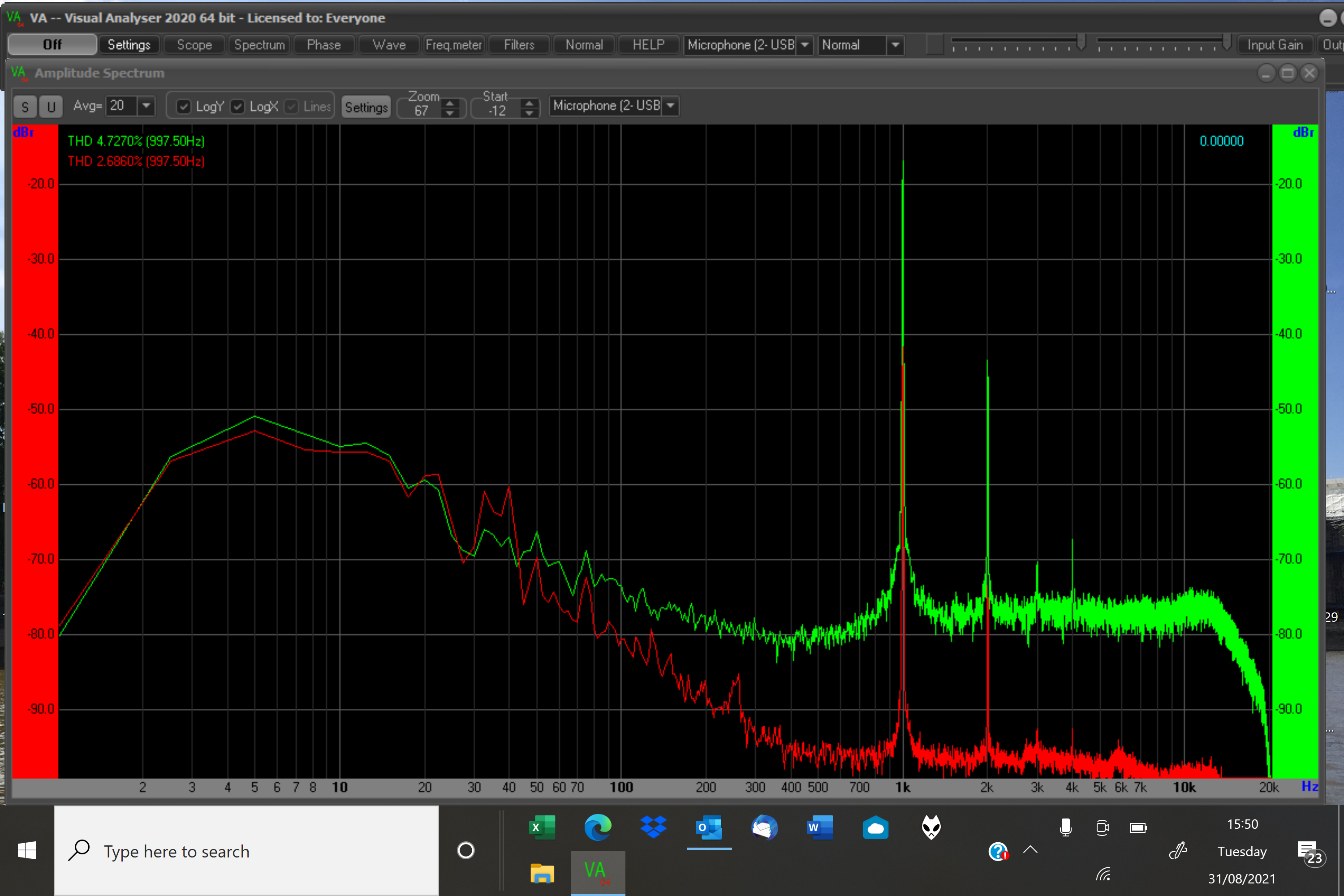

I am in Uk, looking to rebuild the base of my LTA that sits between its rails and the TT support. Eventually i will build my Lenco into its plinth using similar philosophy, with this same arm.
For now i look for rigid to carry vibration and energy away from the cartridge if it generates it and then dissipate it so it doesn't go back.
The current support is MDF.
I measure the results and see the peak of this tone rising and the noise falling, sidebands reduced, as things are improved, here attached pics of the arm and measurements.
I don't need colour match, only performance.
Best
M

Those screen shots look interesting. What do you use to excite things and get those peaks? Test record? Is Visual Analyzer a share ware?
It took me a long time to be convinced, i was quite happy making things and modifying them and expecting and therefore believing they sounded better.
What i call auto suggestion clicks in and if you spent a week of hard graft making a new widget its bound to sound better than the old one!
Several folks on different threads suggested i measure things and so i adopted a route they suggested.
I play a 1000Hz test tone on the test record and look closely at the peak and sidebands through VA.
To do that i convert the signal to digital by taking the output of my preamp to a AD converter (£20 Behringer 222) and input to my computer using VA which is freeware you can download easily. People were kind enough to give me a tutorial on this which i can copy for anyone interested.
I look at the peak locally around the test tone and as a whole spectrum to see what else is going on.
I understand this is not high resolution testing and the bottom end is probably not fully representative, however its helped me see what affects what, and i attach for your amusement my first test.........i also changed scales since this.

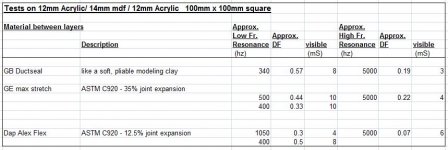

Acrylic/mdf/Acrylic
Here's what I've found with 3 different materials between the Layers. All show very good damping (0.3 to 0.57) at the low frequencies (table attached).
I'm not sure if it's relevant, but there's some 5khz ringing as well. I'm thinking maybe it's the resonance along the thin axis. Is this a real response of the materials to vibration? My Accelerometer suddenly seems dead, so I don't trust the last DF of .07 at 5khz.
If these 5khz bursts are real, the damping is not as good as the LF ones. However, the duration is short (3 to 6 milliseconds).
The GE and DAP caulking are simlar in compliance, so the ASTM spec I was on about earlier only seems to say that it's an Elastometer (or maybe Viscoelastic).
I'll do one more test with a firmer adhesive. I'm thinking this should show less damping. I have a few versions of white glue drying on a piece of Acrylic to decide which one.
