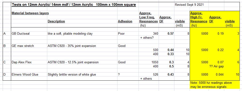

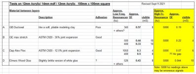

Hugh, something very wrong with detecting 5kHz, way outside the accelerometer's range. I suspect computer/interface interference. The pvb came today, will try to send it off in the next few days!
Ok, I've added a disclaimer to the revised chart (attached) about suspect measurements at 5000 hz.
It looks like the Acrylic/mdf/Acrylic combination you've suggested is a good one. Each of the 4 types of adhesive seemed to give good results. "B" and "C" ( Caulking for Vinyl Windows) are the ones that actually give reasonable adhesion.
Hugh
Hugh
I should have added... I used C Clamps to squeeze out the excess caulking and get a very thin layer. The clamps were on for a few days while the caulking cured.
On item "C" I may have over clamped a bit. When I was taking it apart, I noticed a few areas at two edges where the caulking separated from the Acrylic.
I did get a peak at the ASTM C920 spec. It defines the properties required for standing up as a Window caulking. It says ISO 11600 and ISO 11618 are similar for those in Europe.
