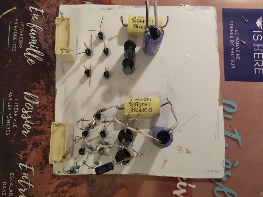

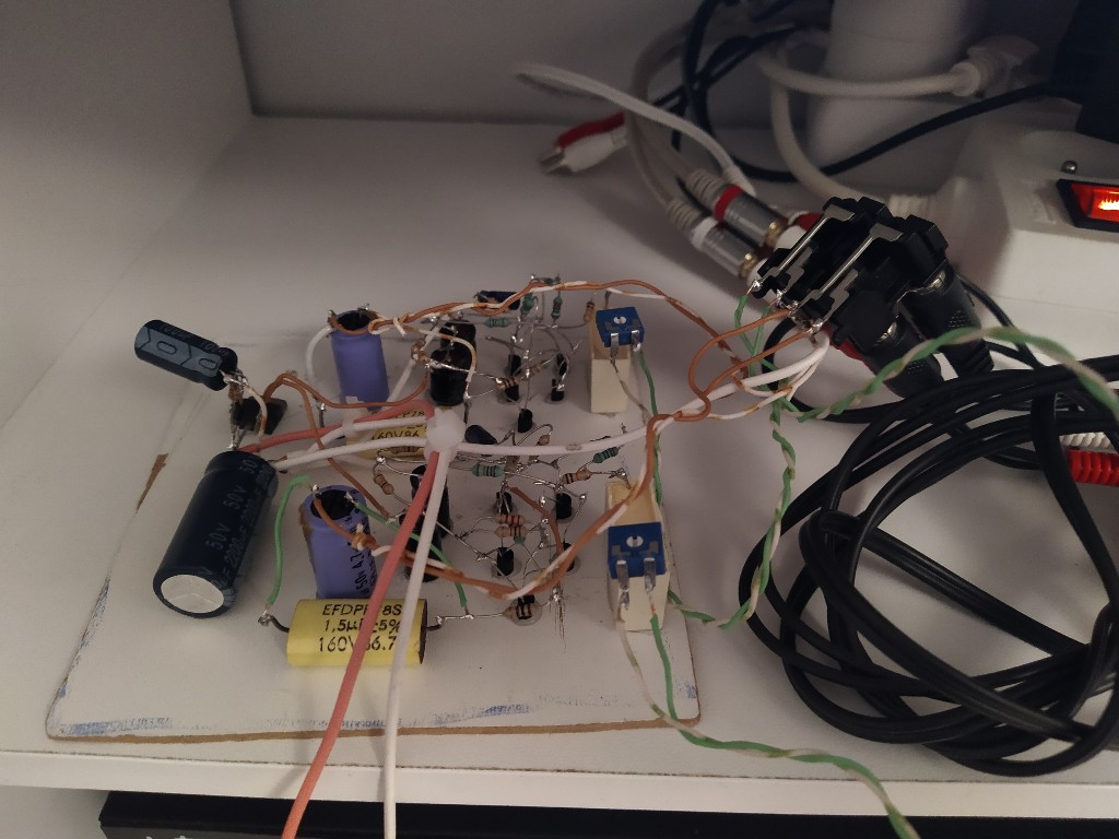

One channel done, now gotta wire the other one.
Really fugly, I know, but who cares 😉

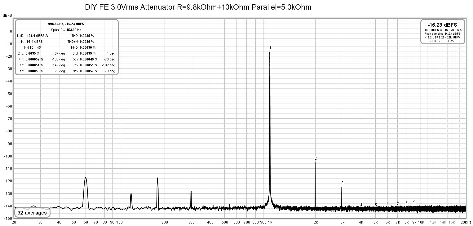

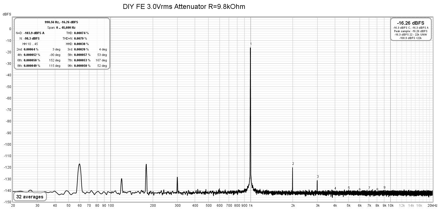

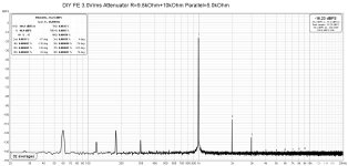

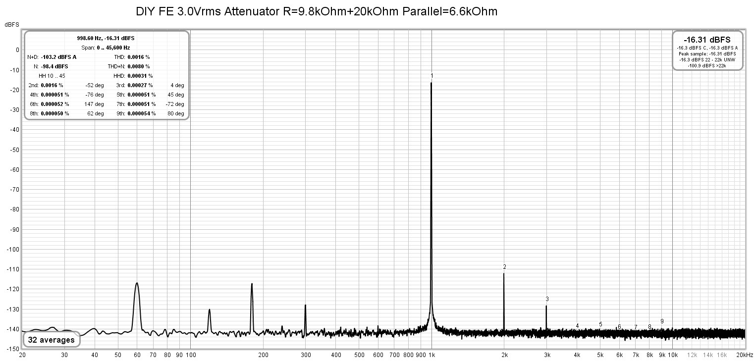

Measurements done: Vout=3.0Vrms at 9.8kOhm, 6.6kOhm, and 5.0kOhm.
9.8kOhm was the attenuator only (diy from schematic on Akitika website), 6.6kOhm= attenuator + 20kOhm resistor, 5.0kOhm=attenuator+10kOhm resistor.
Distortion increased as impedance dropped.
That's interesting. Definitely not the pattern I saw. In fact, your first plot where H2 = 0.00064% (-103dB) is significantly better that any of my measurements. Are you using the V0R1 board with the 10R R13 degeneration resistor for Q5? That could possibly explain the difference in our results. I am using the original V0R0 board.

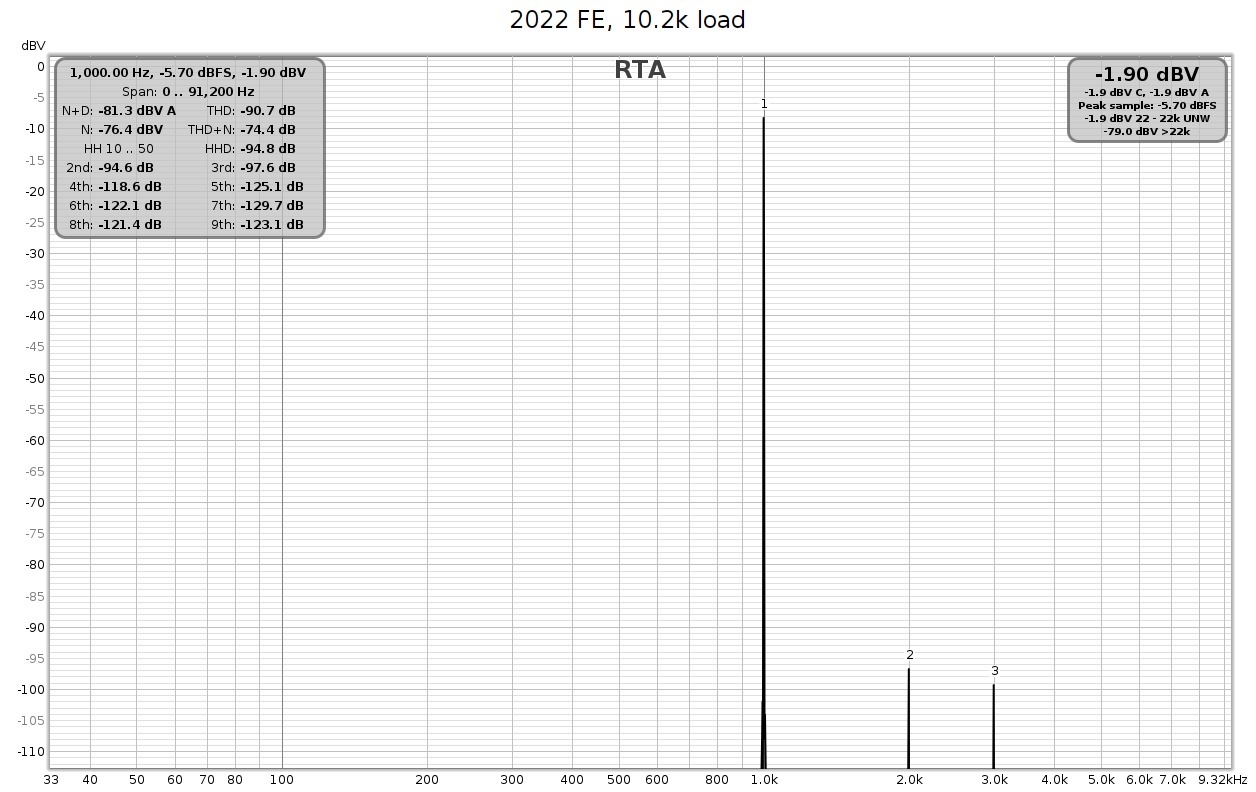

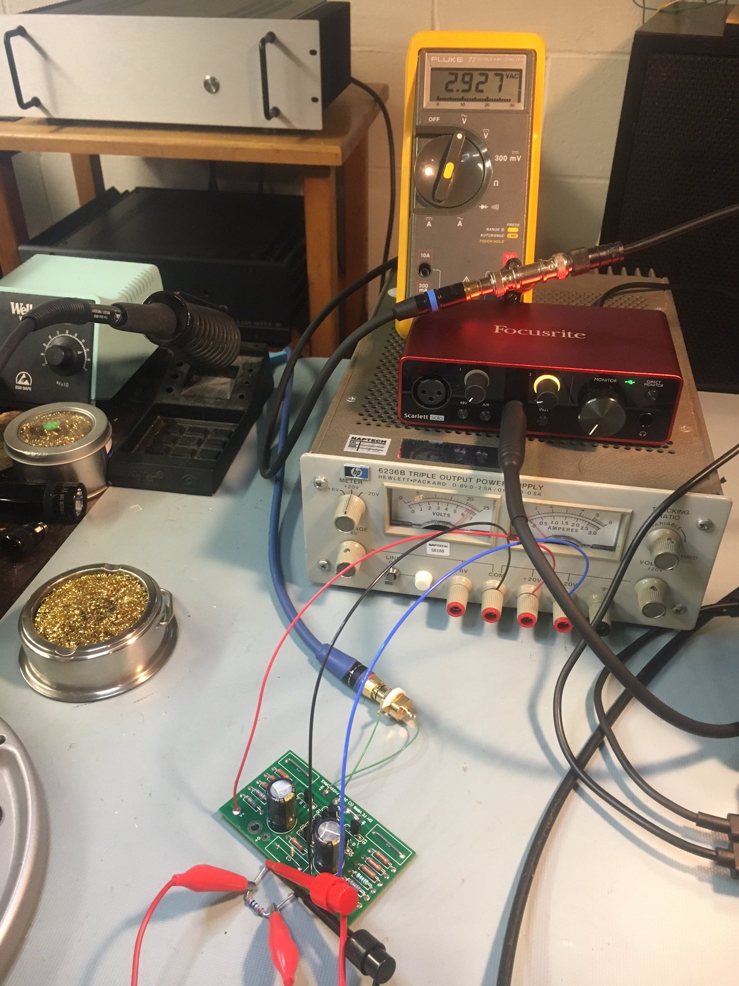

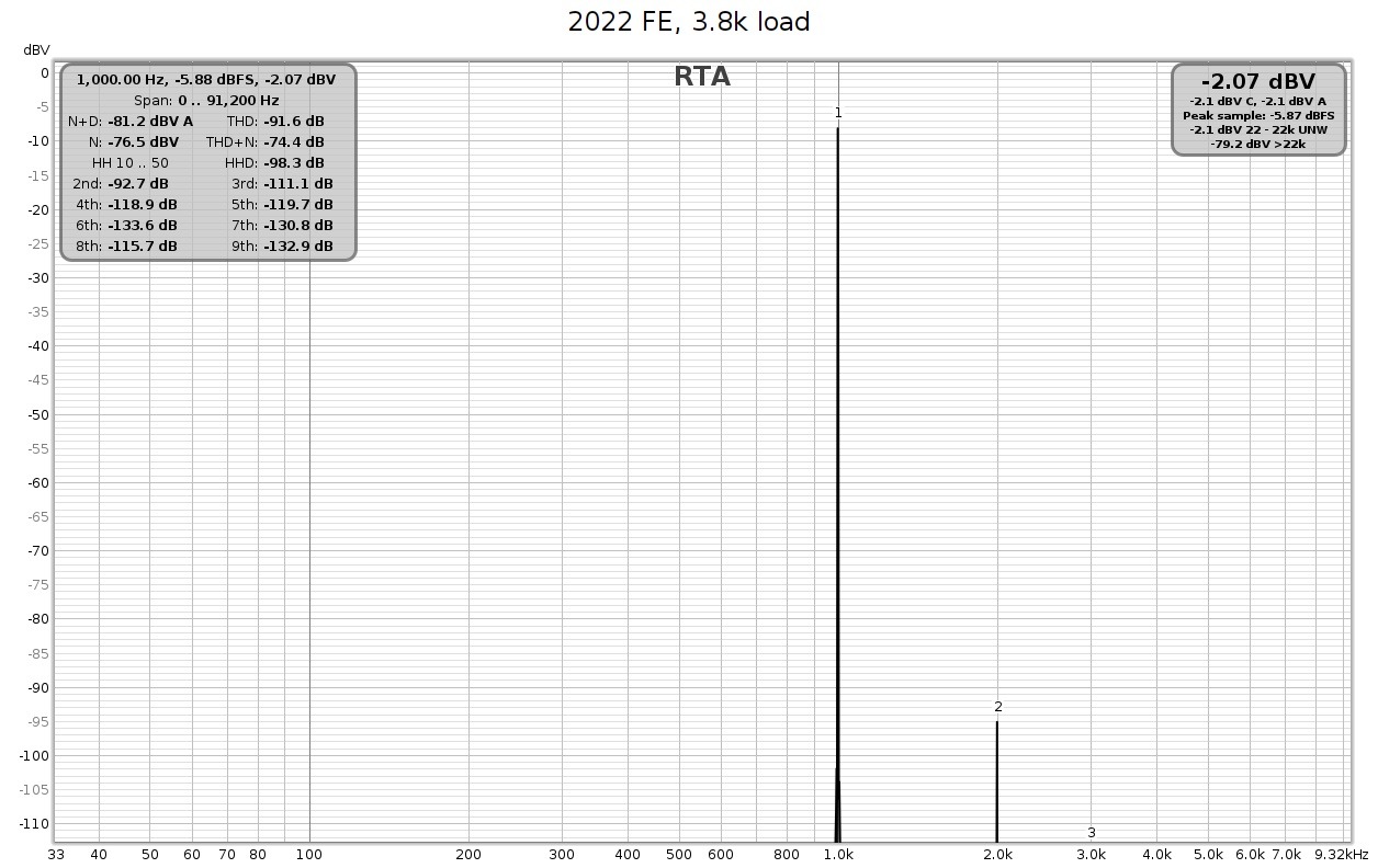

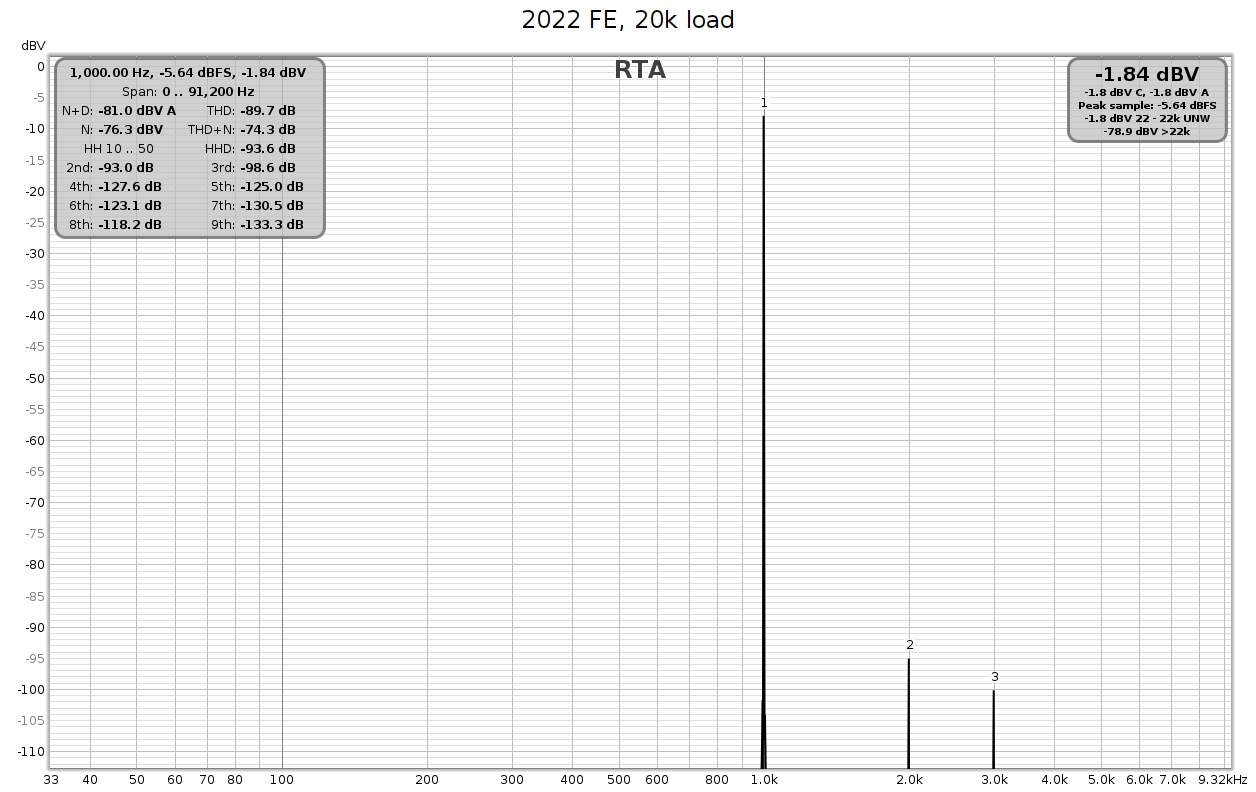

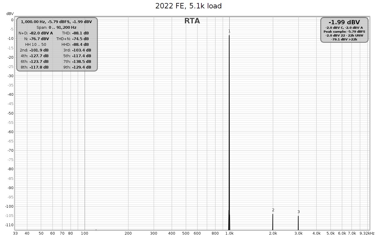

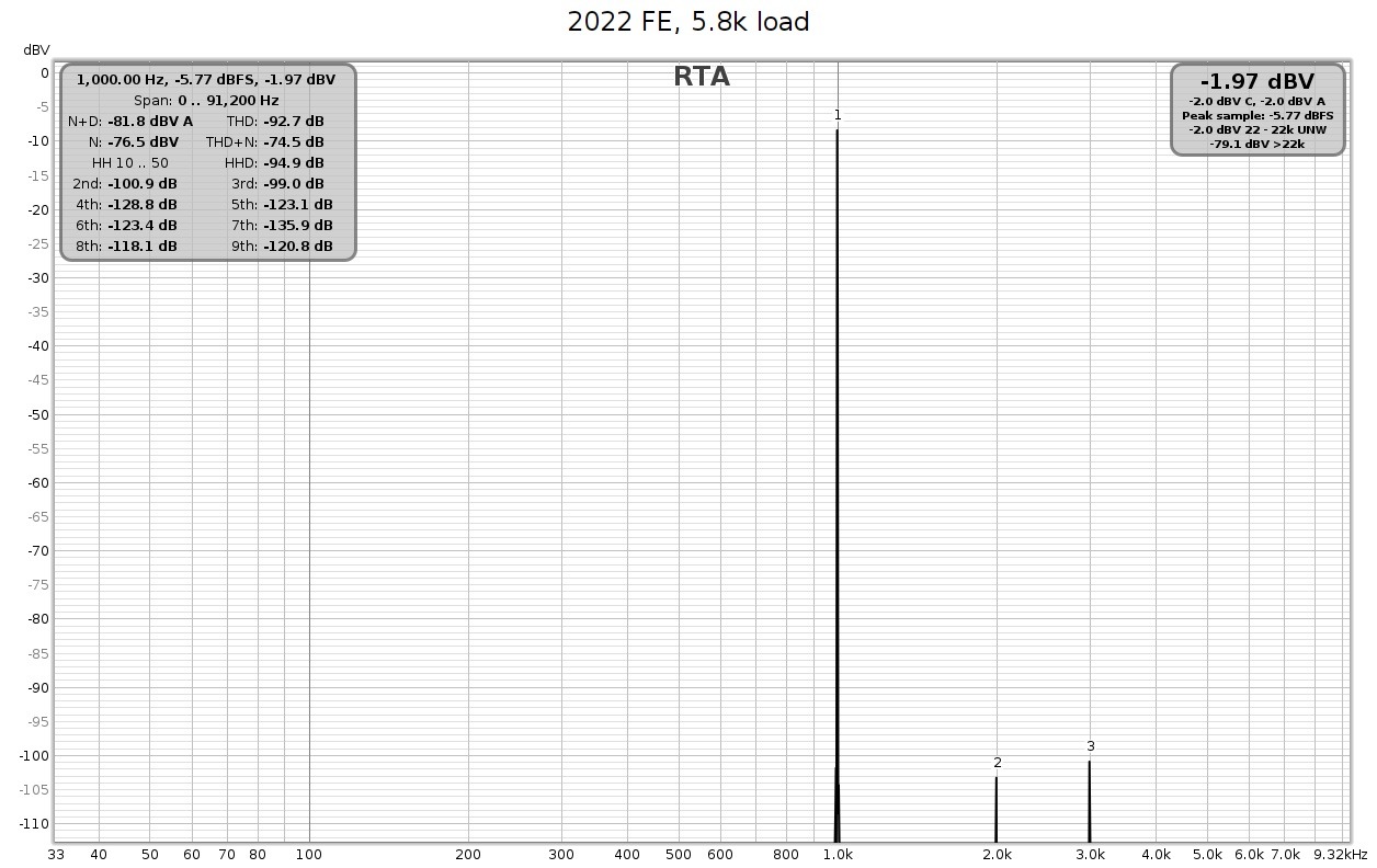

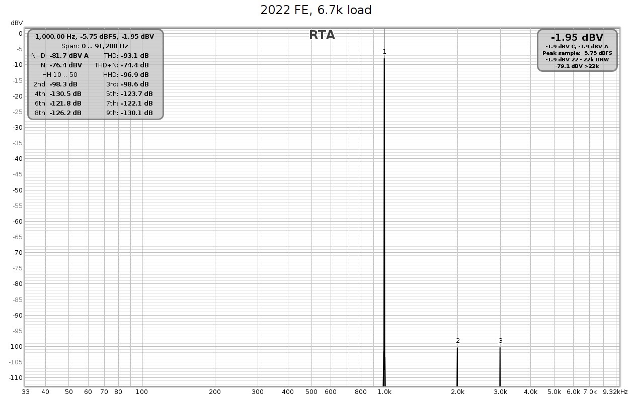

Still confused. I retook the measurements, this time using a standalone FE. Got better results, but still indicating the same trend.
The setup is bipolar supply @ +/- 23V, no capacitors, load connected from R5 to ground. Output at 2.9 VAC.

Hi Marcus,
Looking at your post #1,295 I have some thoughts that may or may not affect the distortion measurements:
1. I assume you are not using an attenuator to attenuate the signal into the Focusrite since I see the Focusrite input level set at Minimum. That may affect Focusrite distortion level.
My setup has an attenuator so that I can set the input level knob at about 11o'clock. From what I have read, that is a good position for best performance of the Focusrite.
2. I see that the REW level is set at approximately -2dB. That may be too high and close to overloading REW/Focusrite, and affect the distortion level. I aim for somewhere between -10 and -20dB.
3. My DIY FE is powered by 62V single ended and your DIY FE is powered by +24V 0 -24V. The voltage difference will affect the distortion.
4. It looks like you are using an external oscillator that is not in the picture. What is the oscillator's distortion? I use an older version of the Victor oscillator and its distortion is lower than the DIY FE's measured distortion.
I know LTSpice is only a simulation and results do not necessarily agree with reality. Having said that, I did try 62V, 48V, and +24V 0 -24V, and the lower voltage and the bipolar voltage simulations did show some erratic results.
Reactions: rickmcinnis
Hi Ben,
Thanks for your comments. You are correct that I am not using an attenuator in this setup. My signal generator is another external DAC being fed sine waves generated by sox. The distortion levels of the source and Focusrite alone are visible above the noise floor but significantly lower than what's being generated by the FE. I'm just getting some experience with the Focusrite and REW and appreciate the tips.
