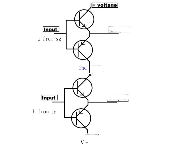

Simple amp. based on SG3525 PWM IC.
Frequency is fixed to 150kHz (fixed f is good choice) but you can modify it by changing RT/CT.
PWM is ~2-98% (which is very good).
IR2184 is HI/LO side gate driver.
Dead time provided by this IC.
Set the potentiometer on half.Turn amp ON.Set output voltage to 0V.
This amp works from first attempt
On PCB i have to use external 12V PSU for IC's
Max input voltage is +-80V.
With 4k7 adjust gain.
Output inductor is gapped core (can be used yelow toroids from AT/ATX PSU,they have internal gap.
In external 12V version you can regulate the output power only by voltage on fets.
12V is referenced to -V,not to GND!
On picture I used totem pole output instead of FET's and driver IC,but I tested wih IC and FET's too.

Hello iperv
Yes,very simple and very good.No sub,I use it on full range,with 150kHz osc. freq.
This means that all sounds up to 15kHz will have same audio quality as input (not same but very close).For me 150kHz is best freq.Easy to drive fet's,but sound good.Yes,you can easy change RT/CT.Go with smaller CT and larger RT.
You can increase to 450kHz but i don't recommend this. 300kHz is enough to reproduce all sounds up to 30kHz clearly.20Khz is max. frequency that people can hear.So 200kHz is best choice betwen gate drive and sound quality.Try first with 150kHz.If don't sound's good to you,increase freq.
My choice is to build it,not give up.You will learn many things.It is more efficient than UcD one.
